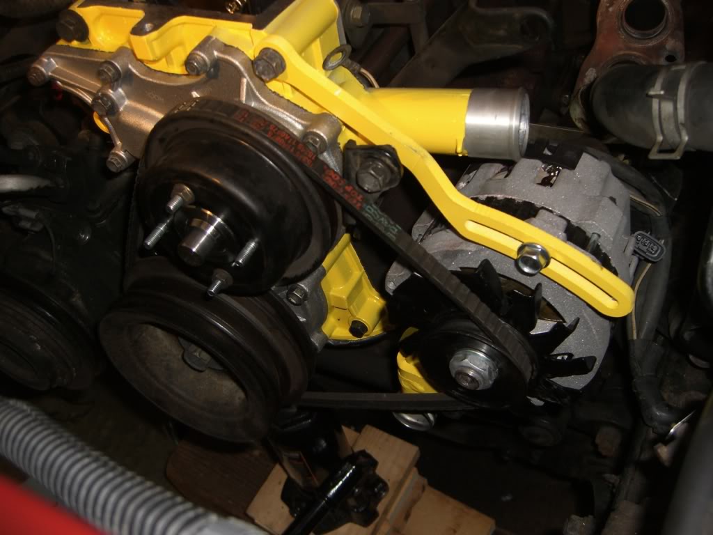

i guess i didn't realize where i was posting. that set-up went into my 93 pu. oops. oh well, in any case, the alternator is doing just fine. no massive dimming of the lights at idle, no dimming of idle when lights are turned on. i've since upgraded my wiring, which is holding up nicely
edit: here's some links
https://www.yotatech.com/forums/f199...l#post51722287
https://www.yotatech.com/forums/f116...l#post51709690
"stat away from the cs130"? might i ask why?
