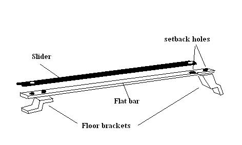

I'm 6'4" and really feel cramped in the 4R, I've done this on two Toyotas and am about to do it on this one too. IT's easy, look at your mounts on the slide rails. Grind off the big "rivets" that hold the floor brackets to the rails. Cut pieces of 1/4"x1" flat bar about 2" or so too long, and drill 4 holes, 2 in each end spaced the same. Bolt the floor brackets to the forward two holes and the sliders to the rear two holes, instant 2" setback. Search around for thr right bolts so the heads don't interfere, I used stainless machine screws (for the strength,) seems like they were 1/4", with flat heads the last time and it worked great.
How far back can I safely move the seat mounts do you think? I want another 4-6" maybe. I just dont think 2" will be enough. Im about 6'3" by the way.

Christyle, I can't imagine how you could use that much, you still need to be able to push the clutch all the way down, and reaching the wheel gets uncomfortable if you go so far back. Nevertheless, you can have as much as you want, just make the sure your extension bracket is strong enough. I'd use angle rather than flat bar if I wanted to go that far, it's much stronger.
