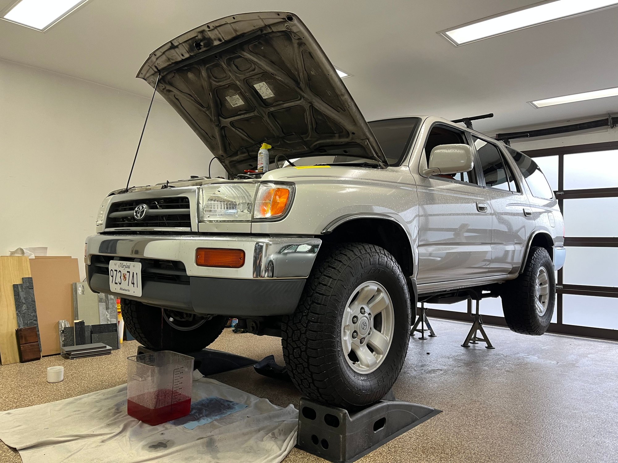

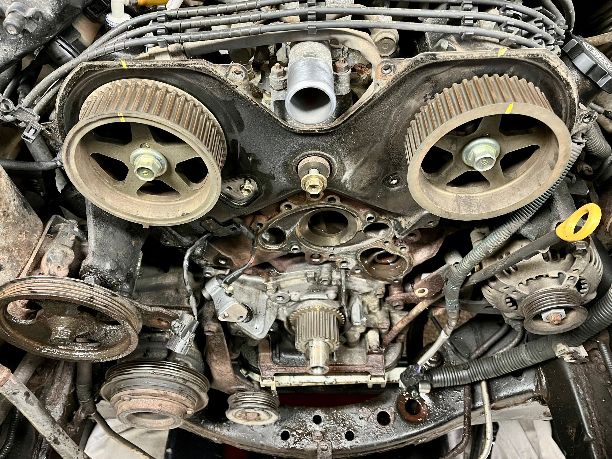

I'm about to do this same job on my '98 4Runner since the A/C left the chat years ago and I'm in the middle of a complete timing belt job.

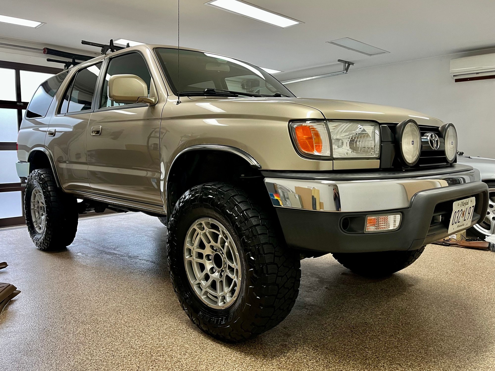

Happy to report that the work I did 8+ years ago on my '01 has held up - the A/C continues to work perfectly.
