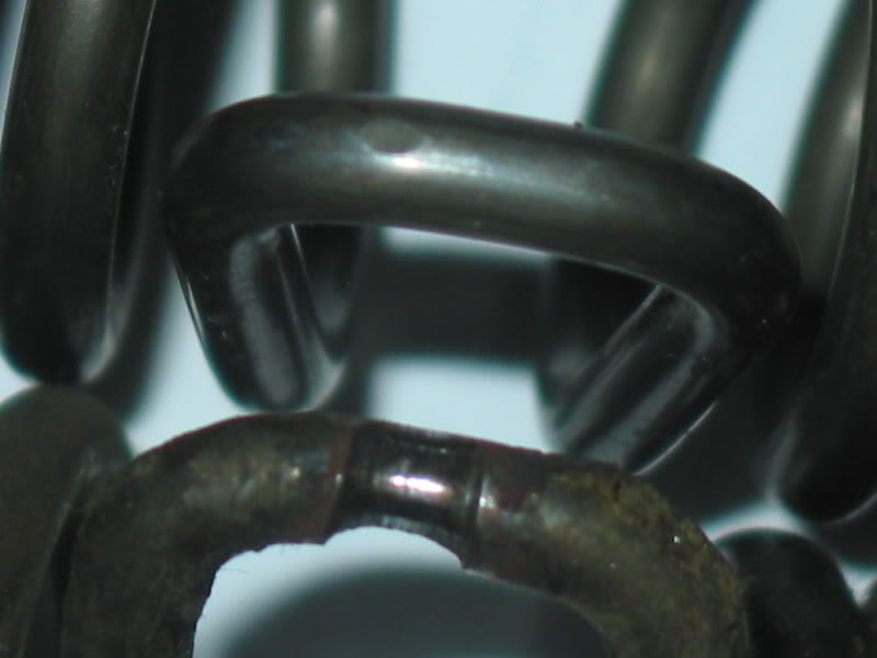

At 205,xxx I replaced both the stupid mega spring, stupid stinking bushings and the clutch pedal too, because both had a lot of wear:
New and old parts comparison:
The spring
The Clutch Pedal
