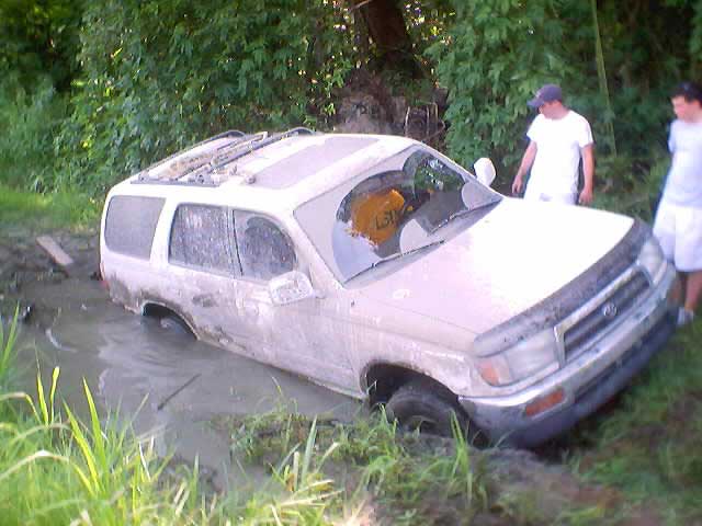

hey, my friend has a 1998 2wd 4runner and he wants to fit 32's on. I am pretty sure that you cant fit them at stock height, so he will need a cheap but ok lift. I have done some research and these are the options I have come up with. He could get 1 or 2'' roger brown body lift, cornfed spacers, or revtek spacers. Even though all he off-roads in is mud, he wants to retain or get better flex. Don't tell me to use the flashing search button, because I already have, and all I am just looking for some opinions on what he should get. Also, here is a pict of his 2runner. Thanks!
