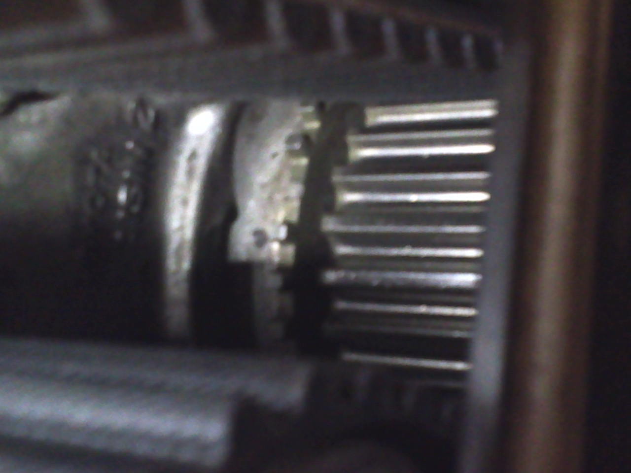

I did notice the P0340 code has a bit in it about the crank position signal plate i.e. the teeth on the crankshaft timing pulley....any chance a tooth broke off? One would think it would cause a P0335 code, but maybe......
Old Apr 23, 2014 | 07:29 PM
blue1's Avatar
Joined: Jan 2008
Posts: 15
Originally Posted by rworegon
Those pictures look ok to my eye. The cam gear labeled "R" is on the passenger side, correct?
Any chance the spark plugs wires are not on correctly?
I did notice the P0340 code has a bit in it about the crank position signal plate i.e. the teeth on the crankshaft timing pulley....any chance a tooth broke off? On would think it would cause a P0335 code, but maybe......
yep broke a tooth
I guess I'll get a new one and tear back into it.
Thanks for your help. I'll post back after I put it back together. Anyone have a spare crankshaft timing pulley laying around?
