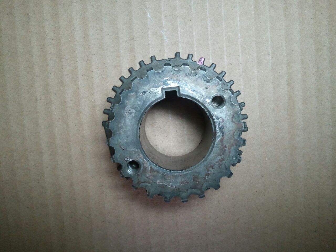

Today I finally found the time to take it all apart again. Finally found something wrong! I turned the engine over by hand to look for missing teeth on the crank timing gear, but somehow I missed this until I had it all the way apart.
During the process of tearing it down, I dropped the crank pulley and broke a section off the outer rim. I will have to replace it now as well. I suppose I should also buy a new crankshaft pulley bolt, as they are a single use item and this one has been torqued once already. I have been looking at a lightweight crank pulley, does anybody have input on the URD Supergrip Crankshaft Pulley?

Yep, a missing tooth on the trigger wheel would do it.

Crank pulley damage from dropping. Not sure how I broke a tooth off the crank timing pulley. I was quite careful with it the whole way thru.

Those teeth are a bit fragile and easily bend or break if using a screwdriver or small pry bar to work the pulley off.

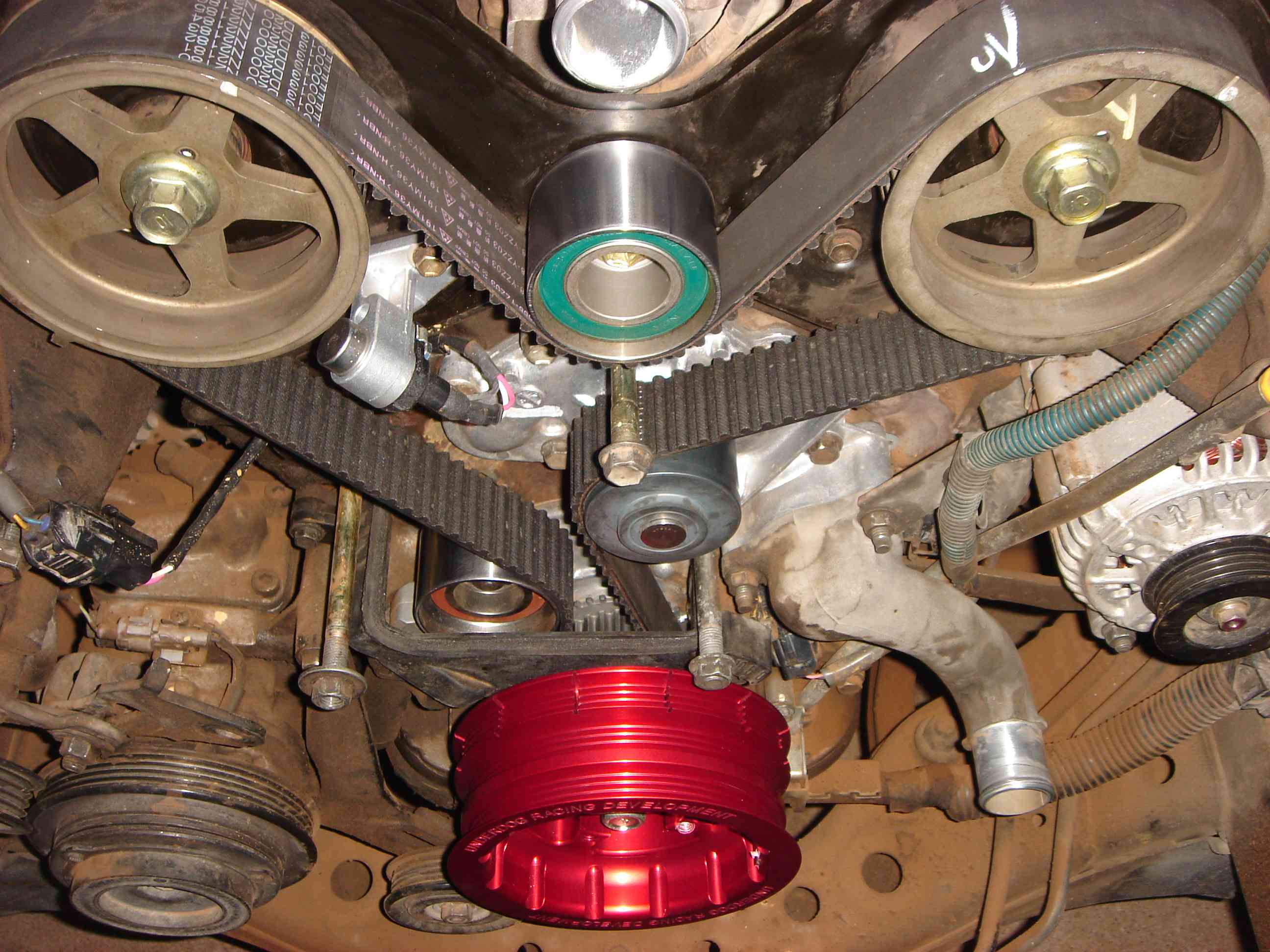

Got the new pulley on and torqued down. Test started the truck, everything seems good. Unfortunately, while torquing down the fan mounting bracket one of the mounting studs stripped it's threads. That will set me back a few days waiting for a new stud to be shipped in. :'(
