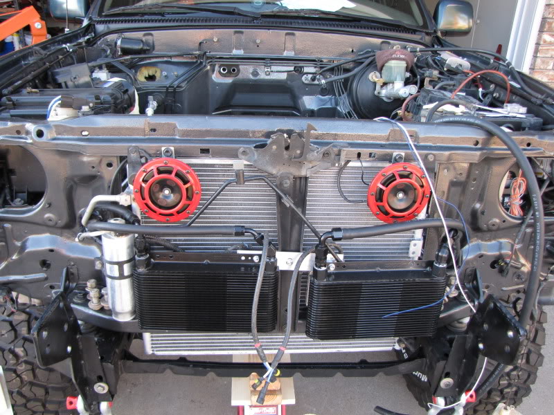

So I finally drove with my setup today. B&M 70273, -6 lines and an inline oil filter. Temp sensor mounted about 8" from the transmission output. Lines are wrapped in DEI heat sheathing where they get close to the exhaust. Brand new Amsoil ATF in a Lexus A340 converted to 4WD.
Outside air temp this evening was about 110° (probably higher). Gauge showed temps of 200º-230°, on both the highway and street, which is quite unsettling. Even though the expected range for trans fluid is typically 70º-100º over ambient air temp, I'm still concerned. Don't even want to think about how hot it would get going uphill, or how hot it was getting with the pathetic TruCool 4454 (or no cooler at all). Truck is heavy, though, with 285s.
Might have to add a fan to the cooler. The cooler is mounted kind of low, but I don't think it's a huge issue.

Man, psraff reached 230 with 50 degree weather outside?? I live in Texas, and it's been about 100* for the past two weeks straight. I shudder to think what my temps are like with only a single TruCool. . .

Yeah, that's a good point. I guess I need to just buckle down and get a scangauge for myself. Mostly stock 4x2 shouldn't be getting nearly as hot as a regeared 4x4 pushing big tires, especially since my cooler is mounted close against the AC compressor and with plenty of airflow.

I think you need better airflow through both coolers. I'd get them both, or at least one, mounted as close to the condenser/fan as possible and see if the temps drop from there.
I love those horns though. Hella's ?
x2. Get those closer to the condenser. So when the fans come on they suck air through the coolers, not from around them. Also, depending on your bumper, they might be mounted too low. As mine is now the bottom 1/3 is behind my bumper so there isn't direct air flow to that portion. I don't know how much that hurts, but it has to have a negitive effect to some exstent.

I have a TJM T-15, and the coolers have a ton of airspace around them and get pretty good flow through the winch line hole (which will likely never be blocked). The bottom of the bumper is very open, too. Those stupid horns prevent me from moving it up much further, but my 4454 wasn't in a much higher location, either.
I went driving last night and even on the high way I was seeing 230º at 70 miles per hour when it was about 93° out. Not good.
Good suggestion about moving the cooler up to behind the grille. I might try it, even though I don't have much wiggle room with these lines. Redoing them would be pricey and a pain in the dick. I think just flipping it backwards would get it an inch closer easily, and might help a bit. Probably will add a small fan on it, too. The cooler on the right is for engine oil; it can only do good considering the stock setup is simply oil to water.
I'm ordering a tee fitting so I can add another temp sensor at the terminus of the return cooler line, and make it switchable between the send and return on the same gauge. Really would like to see the difference between the outgoing and cooled fluid.

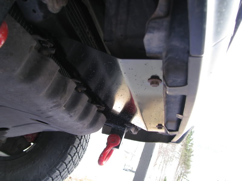

Instead of taking pics of mine, I'll just steal the pics from this thread:
https://www.yotatech.com/forums/f2/a...cooler-205767/
See how pendrag mounted his. Mine is very very close to that... Mine is a bit higher even still, but you get the idea. It's turned backwards so the inlet is on the top and pointing to the pass. side of the Runner. I put the square foam pads on each corner and it's up against the condenser. Even with it mounted high, the bottom third is behind the bumper. I've made another piece to mount from the bottom of the bumper to the front of the skid plate. I'm putting it back on and see if that helps temps any (not that I need it though). But the idea is to force the air up through the coolers, and not down under the skid plate. I want to add some tabs to the sides to help direct the air from excaping and force it upwards also.

OK, so after the suggestions made here and reading that other thread about placement, I took the afternoon to move the cooler to a better location.
Totally fixed my issue. Relived and I feel retarded at the same time. The amount of air that gets pulled over the cooler from the fan is impressive when you get it super close to the condenser. Don't know if I would zip tie it to the condenser; I've never seen that NOT do damage to a radiator. Bad idea, especially with vibration off road. Worth it to make some brackets.
Excuse the wretched pics.
Oil cooler on the right, which is how far the trans cooler was from the condenser to start. Now it's tucked right up against it. Maybe 1/8" gap.
Moved it up 5 inches. Not as pretty as before but it works.
Sits right in the grille, with 2/3s being above the bumper line.
This is why being in the garage in AZ during the summer is absolute hell...
Before, temps would climb as high as 240º, and rest no lower than 210º
Now, temps are at 185º and barely peak at 200º. And this is at 111º ambient air temp, 130º under the hood.
