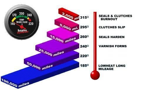

Here are a couple of more charts for ATF temps. By the looks of it, <200 is not all that bad. It IS interesting that one chart says running the ATF temps at 150F is not as good for the ATF as 175F to 195F. But this one is from 1999, long time ago.

Note that last chart says ATF temp reading taken in pan, that's one of the coldest readings. If its 180 in the pan it will be much higher than that on the way to the cooler where my sensor reads. Not sure where the OBDII reads at, but I know its not in the pan.

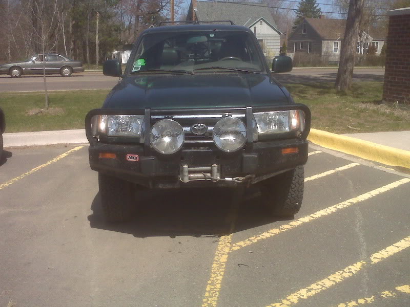

Psraff, I have half your problem, and then some
I have the 240 blitz's blocking much of my air flow through the grille...
Would a fan help a lot? Or would adding a second cooler be cheaper (I assume) and work the same? The area around here is very hilly, and the truck spends a good amount of time off road, so I want to do it right if I'm going to do it.

The lights are not an issue, I have two 240's and a large federal signal siren speaker on my ARB and never see temps over 190F and that's in stop and go traffic in 90+ weather.
The most common cause of running exsessive transmission temps is an undersized cooler and IMHO the 4454 is undersized for a 4runner. As I stated above I had really high trans temps running a 4454 and swapped it out for a thicker B&M cooler. After the swap the transmission temps were much lower and even in deep sand I've yet to bust 190F on a hot day.
So before you start going nuts with adding multiply coolers and such, try a thicker B&M cooler.
