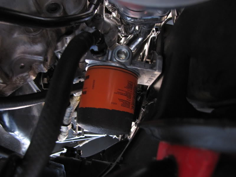

Add a remote oil filter mount and you can add the sensor into it. The brake line mount on the passenger side inner frame is the perfect location to bolt the filter mount to. Extends your transmission fluid life even longer, too.

Midget I see a serious problem with your transmission filter install.......... you used a Fram filter
BTW I've always wondered, who is the lady in your avatar?

That's definitely not permanent! I only put the Fram on there for initial startup; I had the trans completely apart and who knows what kind of funk will come out in the first few hundred miles. Going to a Purolator Pure One after a month.
Elisha Cuthbert.
Nice mount, where did you get it?

Summit. Permacool mount with 4 1/2" NPT bungs.
You can use it with AN fittings or barbs, but now that I think of it, where I mounted it is right were the metal hardlines run under the starter. This setup won't work for you if you're still using the stock hardlines and trying to add a cooler cheaply.
