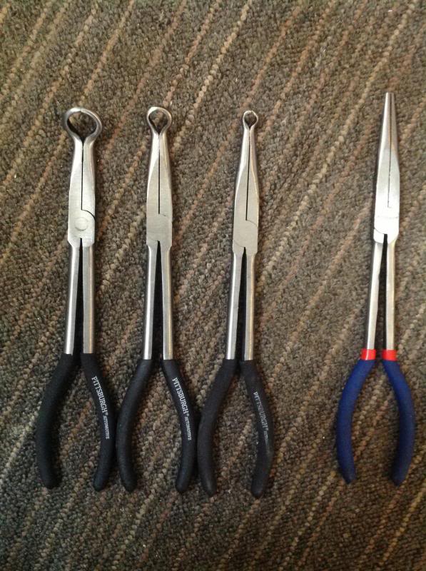

I picked up the 3 pack of tube pullers for $9.99 and the straight pliers for $2.99 at Harbor Freight (photo below). The straight pliers allowed me to pull the broken boot from within one cylinder, and smallest tube plier, using some force, allowed me to remove the 2 remaining, stubborn boots. What a great and inexpensive investment.

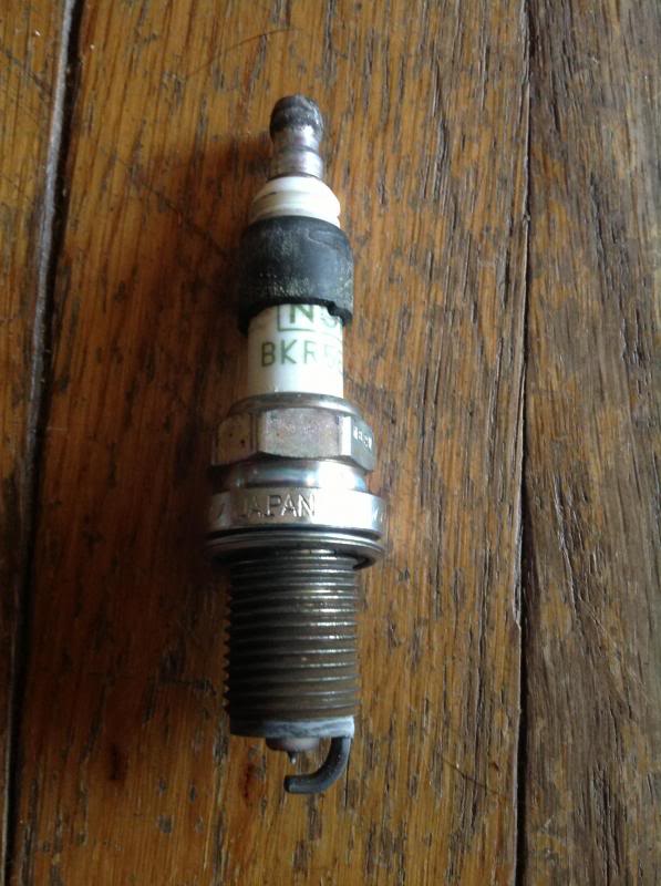

Installed 6 new Denso K16TR11 (dual ground, OEM) plugs and the 3 pack NGK Ignition Wire Set #4412. During the test drive after replacement, the acceleration and response did seem improved, but it could be placebo effect. The old plugs were NGK BKR5EGP (see photo below). What do you think about the condition and gapping? Do they look beat?

Those are the wrong plugs for the 3.4 5vz motor. They look like platinums or iridiums. You'll be much better off running the standard oem plugs. Also the old plug looks a bit gapped out.

Yes indeed the wrong plugs with the way these 3.4 engines fire it is a wonder it didn`t fry something

It's crazy that the NGK sparkplug website lists NGK BKR5EGP and 3 other single electrode plugs as replacements for the 5vz-fe 3.4L engine, when the only proper replacement is the dual electrode NGK BKR5EKB11 or the Denso K16TR11.

Agreed, the NGK BKR5EGP does claim to be accurate for the motor, but I'm glad to go to factory recommended setup. I'm finding out all the things the previous owner did and didn't do.
