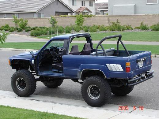

A pic of my taco and the only pic I can still find of my old 85 runner.
