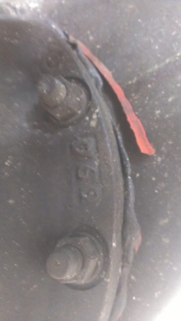

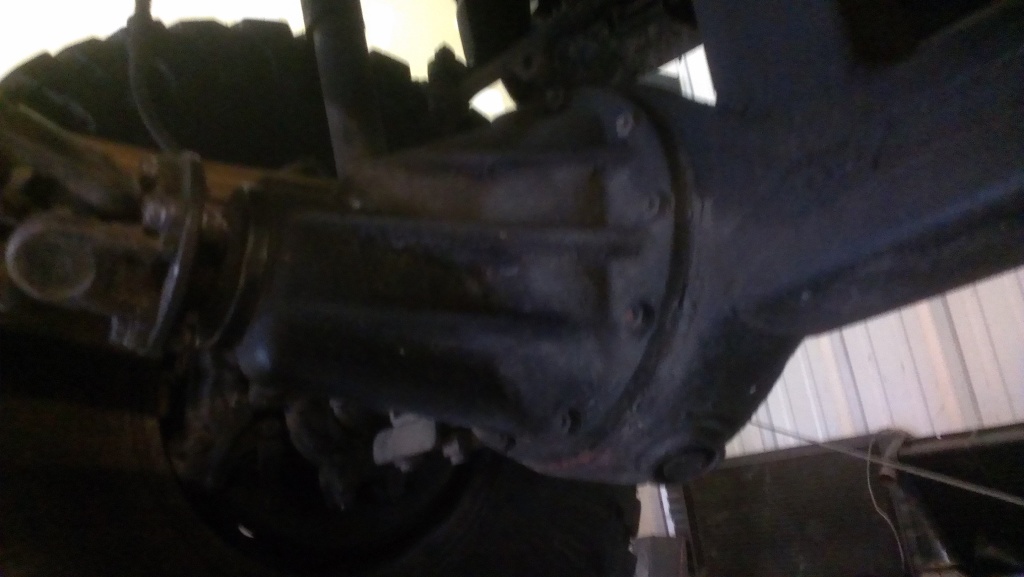

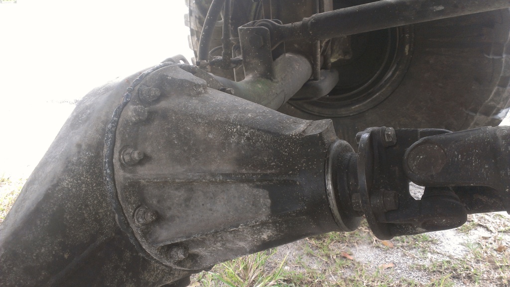

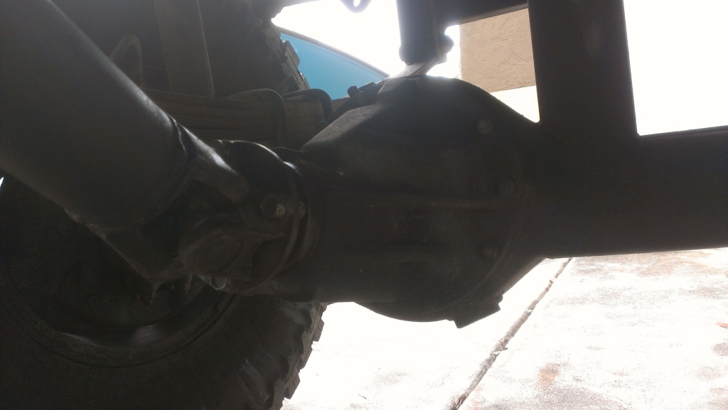

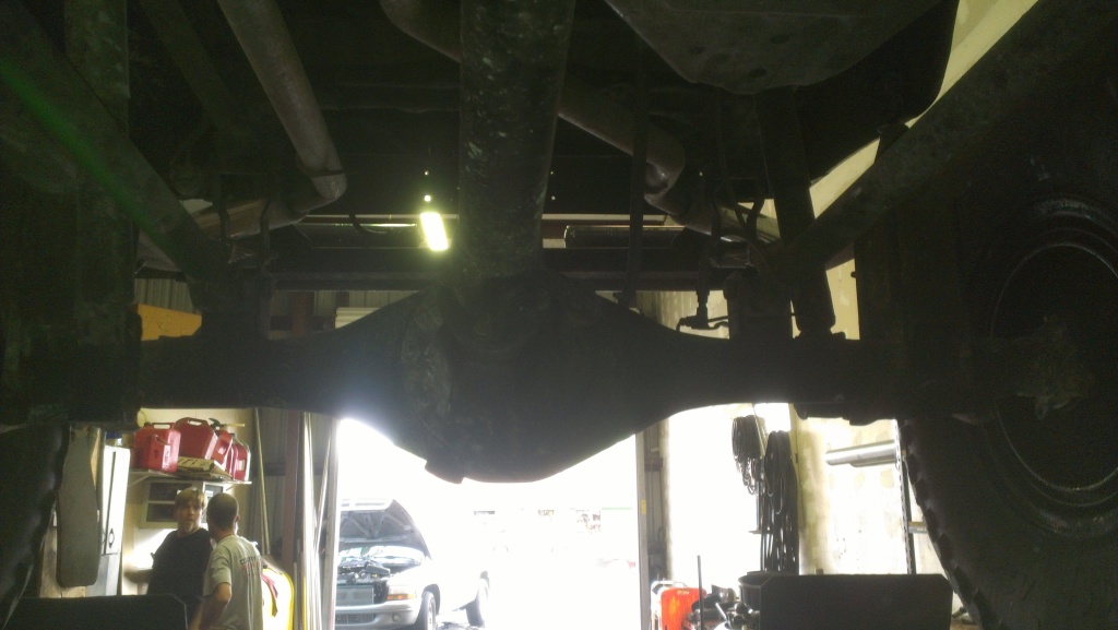

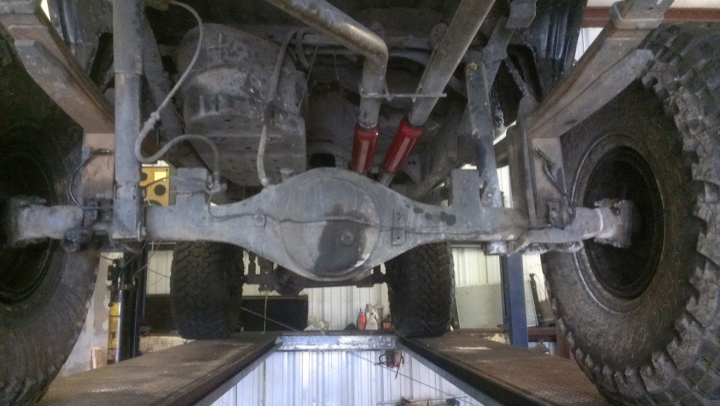

My main question at the moment is is the rear axle from a 97? Does the picture show enough detail to be able to tell?
If I just find an OEM open diff at a junkyard, and have a shop swap the 4.56 gears into it, will I get good enough traction at boat ramps, and for mild offroading?

Might look into a t case e-brake so you can lock all 4 wheels
As far as lockers aussie for a elocker Detroit for a auto will be the strongest. Your front axle is definitely not stock if its toyota and a 88 its outta landcruiser if you have Manuel hubs you won't need a elocker up front
There is a way to date the rear end give me a few minutes and ill find ithttp://home.4x4wire.com/erik/diffs/

If its a tacoma diff you can pull a diff out of a tacoma tundra or t100 as long as the gear ratio matches the front-end that site I posted tells you the specifics the year doesn't really matter if its coming from a t100 or Tacoma it dose tho if you plan on pullin it from a tundra

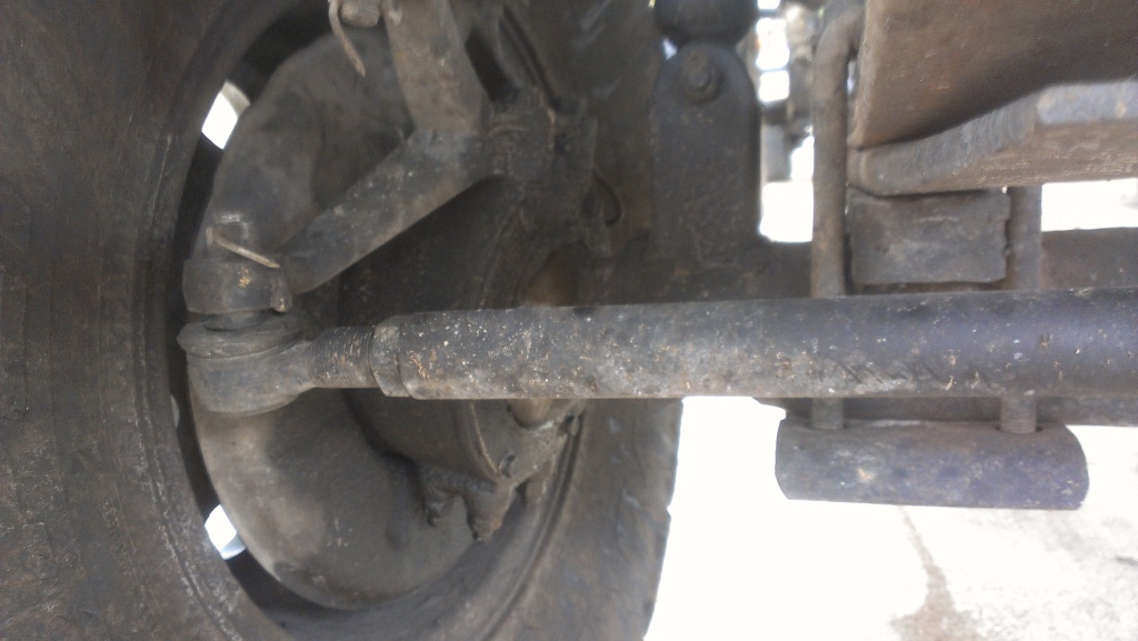

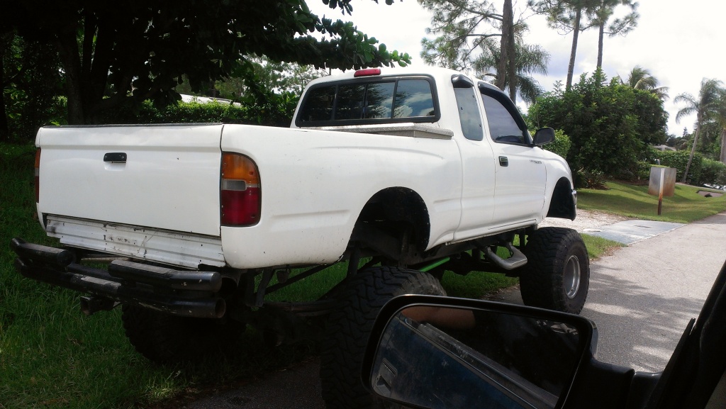

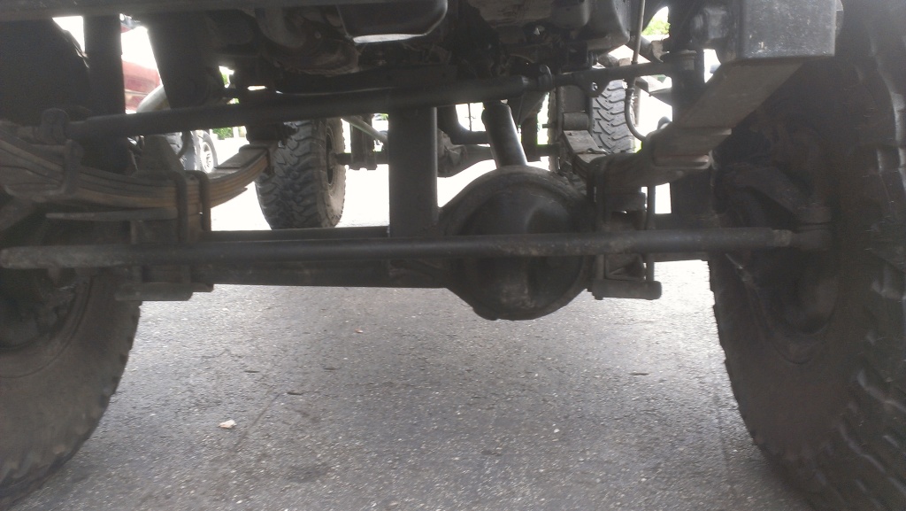

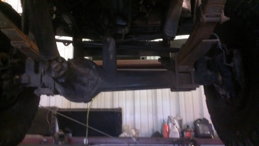

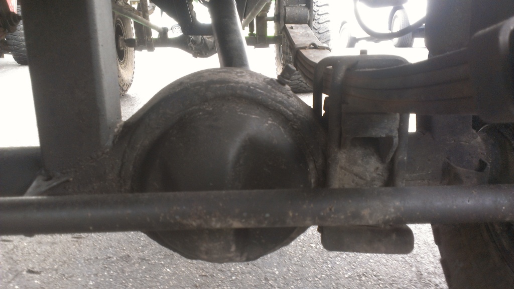

i would check your rear blocks, from what little I can see in the pic, it looks a little sketchy. Personally I would spend the money for new rear springs with the proper arch and get rid of the blocks.
the long bar on the rear end (traction bar?) looks like it will need some work to be functional, looks bent already.

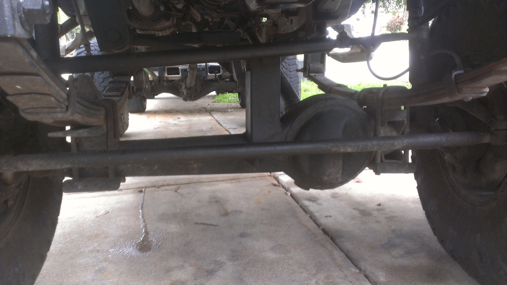

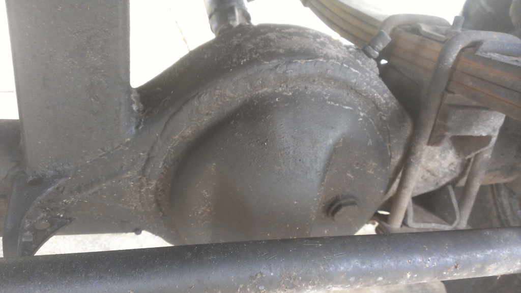

I would like to see more/better pics of the front axle. It might be an '88 but hard to tell from what (maybe a land cruiser) thought those were passenger side diff, not d/s diff like you have. So I am kind of doubtful it is a Toyota Axle, probably a wagoneer axle

Is is likely that the front diff is welded too. Would that affect my turning even when using RWD?

If you've got Manuel hubs it won't give you any problems
Your rear end dose have alot of block though like what 6-8"
