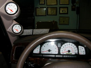

you will need a 8mm allen key to remove plug next to oil filter and a 3/8 to 1/8 npt bushing to install sender. heres a pic of my auto meter gauge.
Attached Thumbnails The best/easiest way to install Electrical Oil Pressure Gauge-dscn0150.jpg

Hi Guys. Finally completed installing the Oil Press. Guage. By the way thanks for all the help. It took me around 4 hours to install. Taking off the plug was the hardest and longest time. Dressing up the wires also took me a while. Overall, the install was easy if you pre-plan everything. I used a 8mm bit as adviced with a 1/2 drive and the stubby adapter. I've test drove it for a while to see if there was any leak. Found none, which is good.
What is the pressure you guys are getting on Idle? and what is the ideal pressure when accellerating.
Anyways, here are a few pics.
