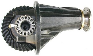

umm.....changing out the third member sounds great! but what is it?
Old Jun 9, 2004 | 03:13 PM
Flamedx4's Avatar
Joined: May 2004
Posts: 3,291
From: 100 miles offshore as much as possible, & Springfield Oregon USA
This part.... (SFWPOH)

So what role does the third member play...if I'm getting the rear axle for the 4.56 gearing(would rather switch the whole thing then tear into it to switch the gears), cause my truck has 4.10 gearing and it's just not working out.
Old Jun 9, 2004 | 07:56 PM
Adam F's Avatar
Joined: May 2002
Posts: 2,479
From: Cincinnati Ohio
The third member contains the gears that drives your truck. The driveshaft attaches to it, and the axle shafts connect to it, which in turn are connected to your wheels.
All you do is unbolt the drums/axles at the end of the axles, undo the brake lines, slide the axles out, remove the 12mm bolts that hold the 3rd member in, pull it out, put new one in, installation is the reverse of the removal.
