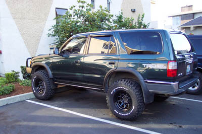

Black rims were not an option. There are three main manufacturers that people go with, American Racing, Allied, and Tech1. I just got my Tech1 rockcrawlers on, and I love them:
https://www.yotatech.com/attachment....&postid=128735

Very nice David! The black rims look great with the white lettering.
