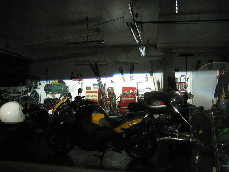

Also regarding the TSX lenses, E30's work well too. I am tuning an FX projector for my brother's mortocycle (pic shows a slightly blurrier cutoff):

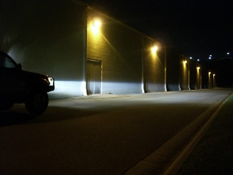

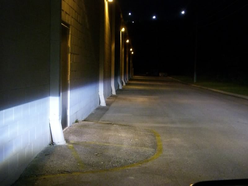

It aint much, but here's 2 photos showing the cutoff...
Old Aug 29, 2008 | 08:05 PM
  #33
aviator's Avatar
Joined: Mar 2003
Posts: 11,334
From: COTKU,Ontario,Canada
That is a nice crisp clean cut off there. No apparant glare or scatter at all.
