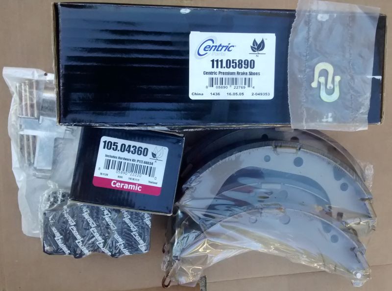

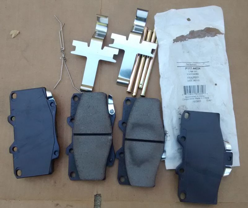

To update the thread, and to give payback for the kind help, I picked up the Centric brake pads and shoes that The Durk kindly recommended.
I was surprised to find they came complete with the correct hardware kits.

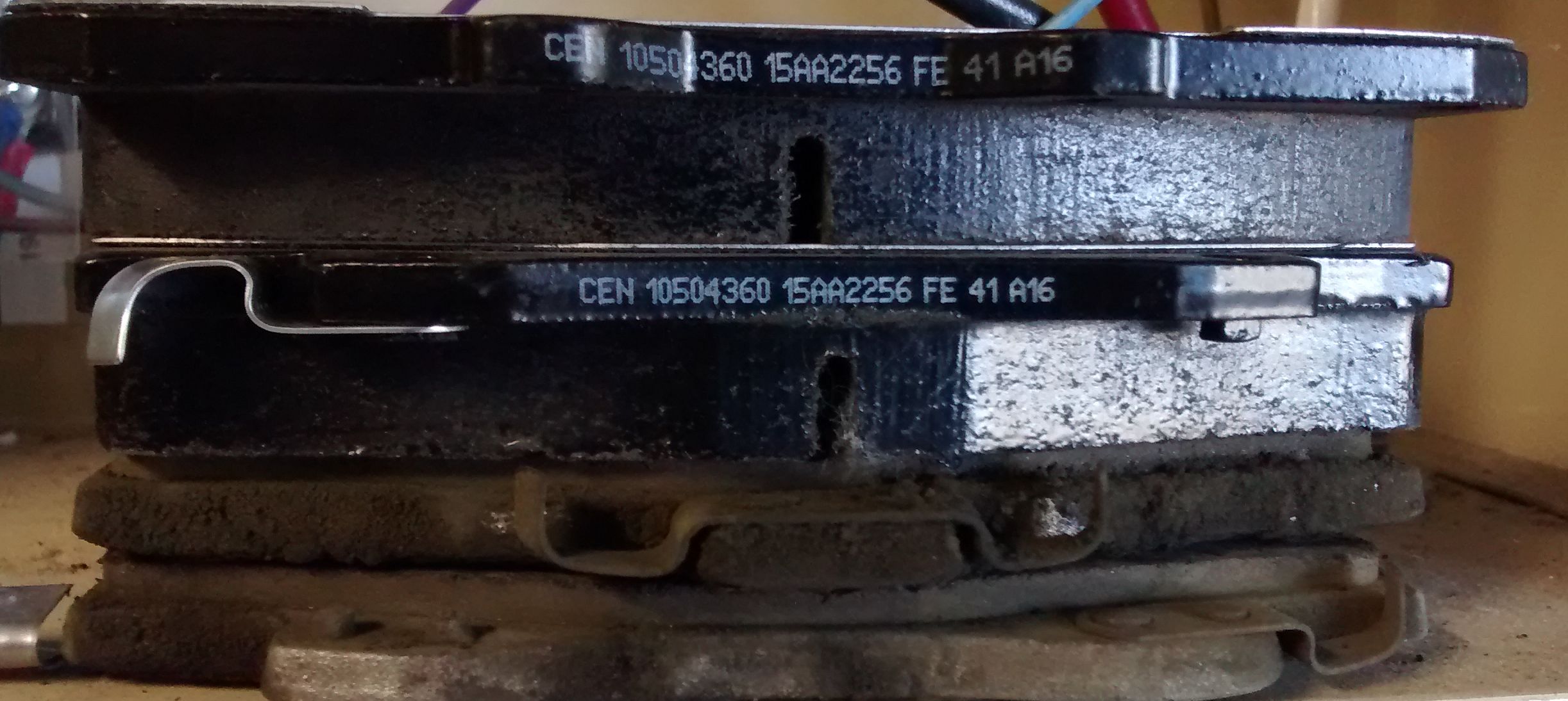

The AMECA Edge Codes (aka DOT Edge Codes) indicate "CEN" which is who brands the pads, that they're Centric part number 105.04360 which is made by unique manufacturer 15AA (aka Centric) with a registered composition of 2256 (a proprietary secret, where Centic calls it "Ceramic") and that they tested cold friction is the higher F coefficient and hot friction is a lesser E coefficient and that they were manufactured in the 41st week of 2016, and their composition is A which indicates more than 5% copper (among other things).

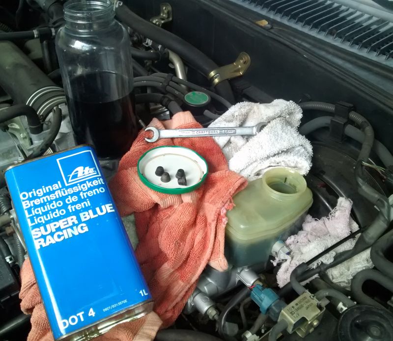

I also flushed the old amber DOT 3 out and replaced it with new blue DOT 4, where it took only 12 ounces.

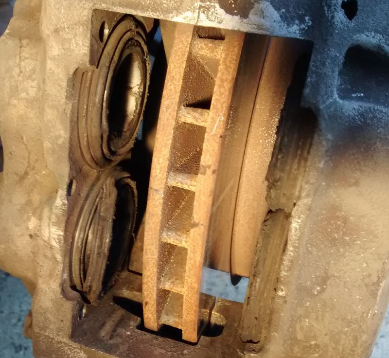

I accidentally tore the caliper boots because my disc brake spreader didn't fit (if you don't just use a pry bar, what purpose-built tool do you use?).
Given I tore the piston boots, I'll look up a DIY for how to rebuild the calipers.
