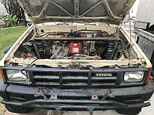

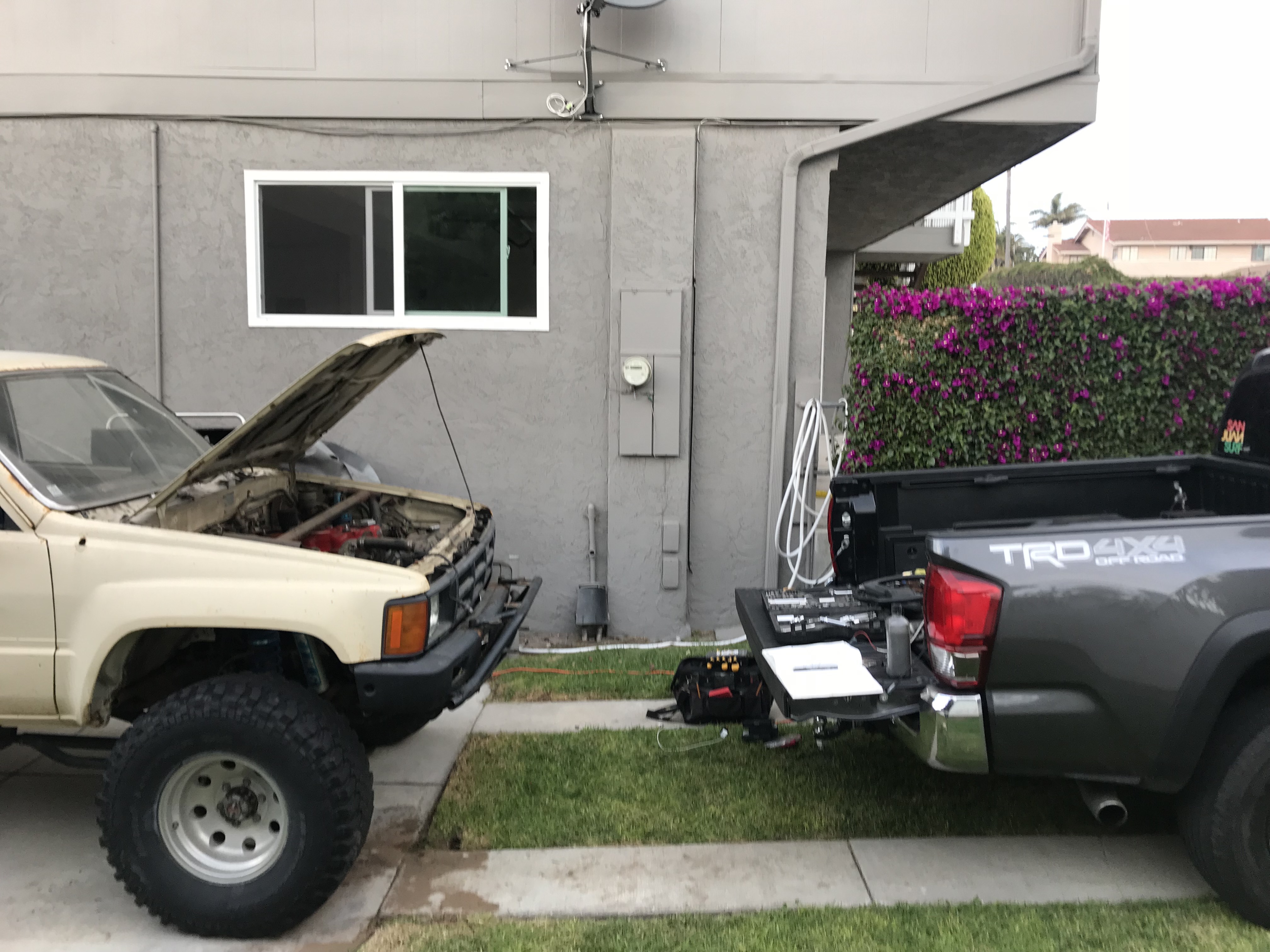

I have a 1985 SingleCab Toyota pickup 4x4.
-LCEngineering stage 3 22R
-Duel 45mm Weber sidedraft carbs.
-original transmission and transfer case.
-linked front end.

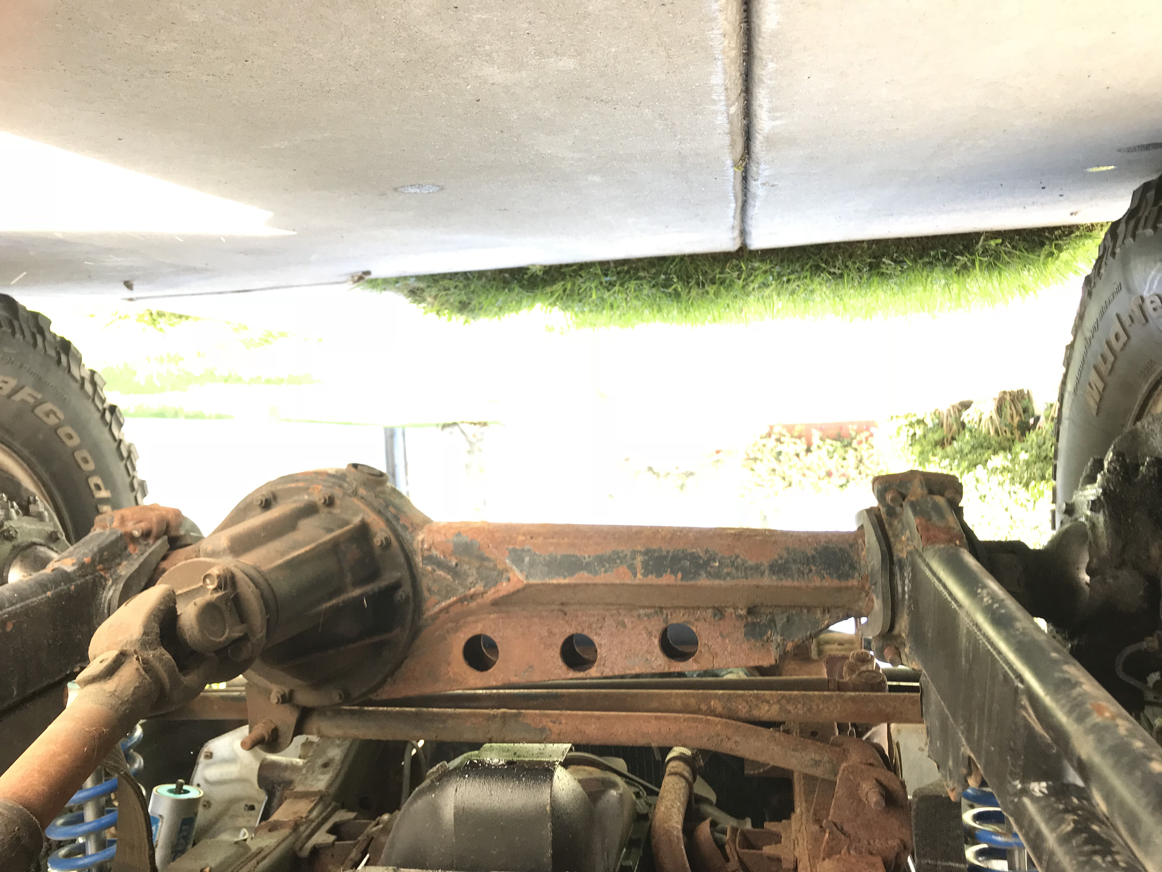

That is really the relevant information as I intend on modifying, or simply replacing many of the other major components. The truck has seen better days.. It has rust, on the frame and body. The front axle is slightly bent. The aftermarket bumper that was put on in 1987 needs to go, the cab cage that was put in 2004 needs to go. Unfortunately the thing has become a ‘Frankenstein’ of small projects that where never planned out together. the thing has had no real ‘goal’ to strive toward. So the goal:

-redesign the front linked axle.
-replace axles with wider rock assault housings/shafts

Welcome to Yotatech. Sounds like an interesting project.
The first thing that came to mind is 'dual 45 Webers is a lot of carburation for that motor' and on the street.
What size main venturis (chokes) does it run?

When you wrote the "LCEngineering stage 3 22R" I was imagining the Formula Atlantic engines I crewed on from the 80s or so. While those were a different motor the prep level seems similar. That motor may be suitable for an off road race truck - it is not for a street truck even if it were to get smogged. Part of that depends on the compression ratio it was built with. For off road you want torque and power but you also need it to be dependable. It may also be a but much for the original transmission and transfer case. Personally, given your stated use, I would sell that motor (I presume it runs) while it is still in the truck (so you can fire it up and comp/leak test it for buyer), and use the $$$ for a fresh but mildly modified 22r. Just my opinion based on what you've said so far.

The maintenance of a race engine is significant. The HP might be fun on the street but the tickets and maintenance and repairs would get old fast. If you can still smog an older truck there with a Weber 32/36 that is the route I would go with a mildly/appropriately modified engine. 22r long blocks are fairly easy to get a hold of around AZ, not sure about SoCal.
I would work around the engine leaving it so you can start it up to demo for a buyer. Are there any circle tracks left in SoCal? Your prospective buyers could be there.
