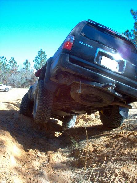

I have an okay class IV hitch from DRAW-TITE. It doesn't stick out too much and you can really only see the receiver part of the hitch.

These are the only decent ones I have on my computer right now. They are like a year old but I've had the hitch since about 2005. After I wash my truck tomorrow I'll get some more recent pics up.

02LIM - thanks for the pictures. Looks like that is a good option. I don't like it **quite** as much as the Reese unit, but it looks way better than the OEM style mine came with.

Yeah I mean it's a little more rounded off and "soft" looking compared to most other hitches, but I mean it does what I ask it to do well (usually just pulling people out or ditches when it snows or occasionally towing my 4 wheelers. Or for using my BVG rack.
