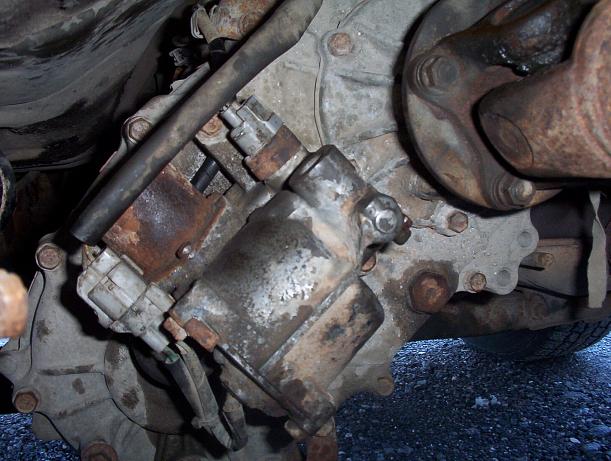

After looking at it..... it looks like I can unscrew the electrical connection on the left side in figure 007435 and possible get into it to apply some gear oil or something..... also in the picture under the electrical connection is the plate I was talking about with the 3 bolts on it.... wonder whats that there for, does anyone know?

Does anyone know what the triangular plate on side of the actuator is covering.... is it safe to take off and if so, will it give me access to the internal components to lube them up?

Actuator Photos and Vacuum Cannister
Any suggestion on what to do with this stuff...lol!!!!
