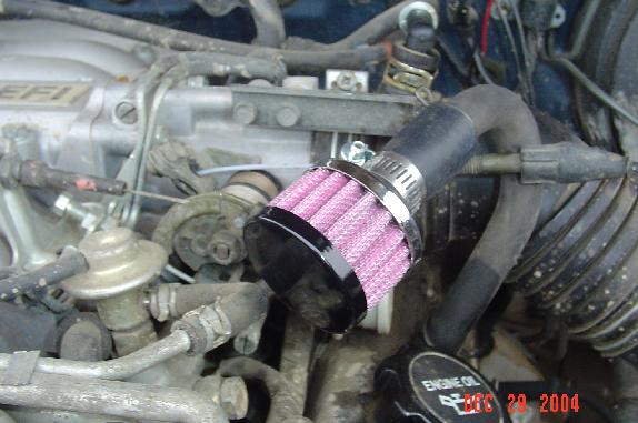

One way to unleash the power within.
Attached Thumbnails 90 Runner Torque?-tb-tube-plug.jpg   90 Runner Torque?-valve-cover-breather-2.jpg   90 Runner Torque?-plenum-breather.jpg

Are you trying to tell me that by blocking off the breather tube you gained some ponies?
I only blocked off where it entered into the base of my fipk & at the throttle body tube next to the throttle body. instead of the flow circulating it now breathes in cooler cleaner air IMO and exhales the warm engine air. I think the engine runs cooler and it for sure has more power.
How did you get a pic of my girlfriend in you avatar? LOL I wish...
Do a quick search for 'crankcase explosion'.... something that does not damage anything other than you oil pan seal, but does spray oil EVERYWHERE and occurs from not evacuating blow by out of the crank case which happens to be fuel-air rich....
Im all about the hp, but I'd really not do that on my 3vze - she already spews oil out of the valve cover 'seals' as if they weren't even there...lol And you just KNOW my pcv valve is still working after 256,000 miles....LOL
