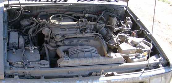

just thought y'all might be intrested in seeing my pics
Attached Thumbnails 3VZ-E rebuild update (lots of pics)-engine0004-2-.jpg   3VZ-E rebuild update (lots of pics)-engine0005-2-.jpg   3VZ-E rebuild update (lots of pics)-engine0007-2-.jpg

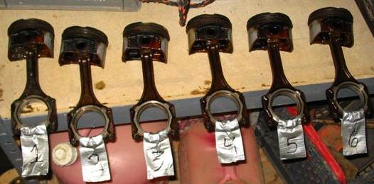

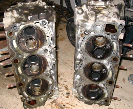

more pics
Attached Thumbnails 3VZ-E rebuild update (lots of pics)-engine0008-2-.jpg   3VZ-E rebuild update (lots of pics)-engine0006-2-.jpg   3VZ-E rebuild update (lots of pics)-engine0003-2-.jpg

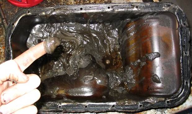

WOW, is that sludge in my engine too?
That is very shocking stuff, makes me want to drop my oil pan and have a look. Are there magnets in there?

That oil pan is nasty!!! Good luck man

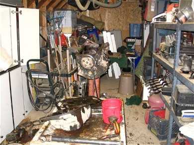

gwhayduke: yeah, not much though. Im going for 200hp, same as if i did the 3.4 swap. i talked about my reasons in another post. here
https://www.yotatech.com/forums/f2/i-need-advice-55209/
Duec66: I don't know if that sludge is from when i drowned it in mud (probably) or if that is just from poor maintenance.
mt Goat: Nope. No magnets, there will be though when im done.
I don't know for sure, but im guessing this motor had around 155,000+ miles on it when it died.
the pic of the room is my work area without all the junk in it, its about 10x 15. All you guys with a garage don't know how lucky you are

good god I REALLY want to drop my oil pan considering I have 258,000..... that is SCARY!
at "...155,000+..." & you've got all of that type of sludge in your pan, the only question that i have is: what type of "oil additive" were you using to leave that much residue?
you see, the oil system is SEALED so there is no way that you got that mess into your pan from "...mud...", unless you ripped it open on the trail & scooped it in, perhaps!?!

I wasn't using any additives. Don't know about the previous owner though. I've only owned it for about a year; maybe 5 or 6 oil changes? Its originally from VA, then went to Seattle then to Boise, Idaho, where i bought it. (previous owners kept decent records)

Sludge
Ok, when I dropped my pan I thought for sure I'd see "goop" however I didn't see anything wrong. No metal, no "chunks", no dirt, nothing but oil. I would like to take this time and say "Thank you for helping me feel better about my abused yota". Well how's it coming together? Are you done? (man everyone's quicker than me). If you're not done what do you have left to do? Good luck and keep us posted.
