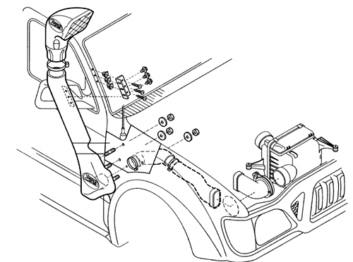

The pipe fit perfectly. The 6 inch pipe was already attached to the 90 degree pipe that ran into the factor air box. This is all Toyota parts. It is under the fender well, remove the liner and you will see it. The photo shows a total of 4 pipes, 2 closest to the air box are factory the other two are the snorkel. The snorkel comes with the snorkel body, the air ram, rubber pipe w/ 90 degree, template and hardware. I hope this is alittle bit of
Dude, I was the first person to do this on a 3rd gen 4Runner, remember? I know what is back there. The pipe in question is the one between the rubber hose that comes with the snorkel and the elbow that goes into the airbox. Does yours actually look like the one in the picture? Because if it does, that would be very interesting, mine looked nothing like that and was not near long enough to meet up with the rubber hose coming from the snorkel. That would be pretty cool if people with older trucks didn't need to purchase this extra piece...

I took some pictures of the stock intake tube that was on my 4Runner for everyone's viewing enjoyment. Aside from the little flap of plastic you would have to cut out to even get a hose around it, the "horn" shape on the end would make it very hard to get a good seal. The biggest problem is that this piece is about half the length of the equivalent Taco tube.
http://filebox.vt.edu/users/ddelaney...ake%20tube.jpg
As you can see, I needed a snorkel.
Is this not what your's looked like Hyperlite?
I am not saying that the Taco piece is the only solution to this, but it certainly is the easiest option as well as probably the most reliable.
Also I thought it would be nice to mention that the template that comes with the snorkel to line up your holes works perfectly for the fender of the 3rd gen.
EDIT: Hyperlite, what the heck did you need a bottle jack for?
Hey 44Runner,
Mine looked like the one in the attachment not like the one you took in the photo.
Guess we get some benefit for having the Rev 1.0 truck (96-97) afterall.....

I used the bottle jack to bend the antenna stay out of the way. 44Runner it looks like my pipe is different than yours. The template is correct if you put it on correct, oh well it looks fine when i tighted the bolts. How much does the steelership charge for the taco pipe? Did you seal the holes in the bottom of the air box?
MTL_4runner thanks for your help in this matter I guess our toys are different
Hmmm, still have no idea what you mean with the jack.
Yes, you do have to put on the template correct for it to work right
Don't remember exactly, but remember feeling like it was way too much for a thin plastic tube.
Yes, used the same silicone stuff I used to seal all the pipe connections with. I took all the intake pieces apart and made sure all the connections were water proof.
I guess the moral of this is that you should check to see if your intake piece looks like my old one or the one in the diagram...
