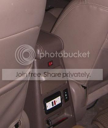

heres where i mounted my outlets in place of the ashtray
as for my inverter its just under the seat didn't want to run the ac line very far, right now i only have electrical tape acting like a face plate but i plan on making a plastic one latter.
Thats purty slick!
I have seen another install like this one, can't find it right now.
However, the guy actually took apart his inverter and used the outlets on it, and mounted them in the same place. He also took the power switch and the led on it and extended the wires and mounted the power switch on his dash in an empty switch spot.
I want to do this install like this guy did because it looks very clean, I am just worried about where to mount the unit and heat problems with mounting inside the cetner console. BTW my inverter is 750 watts, black and decker, and it comes apart very easy for a clean install.
