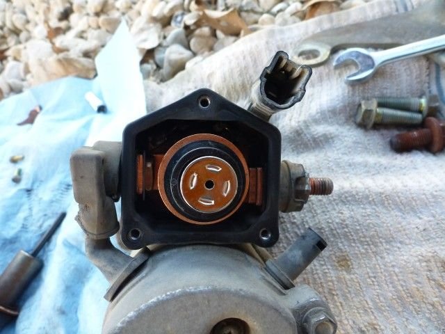

2000 4Runner Starter Contact replacement for Manual Transmission
I wanted to share my experience with doing this starter contact replacement after reading through this thread, as well many others available online. Obviously, having a manual (i.e. 5-speed) transmission makes it a bit easier as you don't have to deal with the auto-trans dipstick tube removal and you have a bit more room in the area where the transmission is located.
A couple observations for those wanting to do this starter contact removal/repair
1) I was able to do the starter removal (complete removal...i.e. out of the vehicle) without removing the front passenger tire like others have. Yes, removing the front passenger tire makes it easier, but having a jack stand/jack in its place hinders access in my opinion; more so than the actual tire If you leave your front passenger tire on, you'll want to make sure you have your front wheels cranked driver side as much as possible (gives you the most room).
2) The only connections/parts I had to remove to get the starter out (besides the starter itself) were the following: passenger side mud/splash guard with plastic clips, 2 bolts holding the brake line in place in 2 places, 3 bolts holding the exhaust bracket, one bolted positive starter connection and one plastic clip-style electrical connection, and finally the two bolts holding the starter in its place (one long, one shorter).
I've incorporated some photos which show various items, such as the bolted connections, how I oriented the starter to get it out of the passenger side wheel well, as well as the starter itself.
Hopefully this helps you out. I found that by looking at all the posts about the 3rd gen 4Runner starter contact replacement that you they vary somewhat about what the 'best' way is. I pretty much used a mixture of the suggestions, FYI. Please let me know if you have any questions
Doing this fix saved me about $500 (quoted $525 for parts and labor for a new "lifetime" warranty starter). Like others have said, it's worth your time to fix this yourself...you learn about your vehicle and you save a bunch of coin!
Starter with replacement plunger and contacts installed!
Starter with worn contacts (bright copper color) visible. Plunger removed.
Shot from below showing exhaust bracket removed. You can see the two bolts that hold the starter to the transmission.
Shot from below showing exhaust bracket in place.
View of starter being removed with front tire on, brake line moved, and mud/rainguard out of the way.
