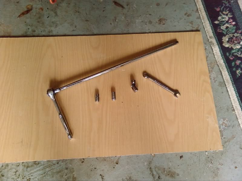

Just finished my starter contact replacement on my wife's '00 2WD 4Runner. Total time was exactly 1:45. Huge help was that her 4Runner is 2WD.
I did not have to unbolt the aft fill tube bracket at all. Did not even have to unbolt the power steering lines. I just removed the 2 bolts holding the brake lines to better access the starter.
I was able to drop the starter straight down and thru the lower A-arm. Painless process.
Here's a list of the tools I used to remove the starter:
3/8 Ratchet
20 inch extension
8mm socket (remove starter cover to access contacts)
10mm socket (remove battery cable)
12mm socket (remove power cable on starter)
14mm swivel socket (remove starter bolts)
12mm open ended wrench (remove hidden brake line bolt)
Flat head screwdriver (to pop connector apart on starter)

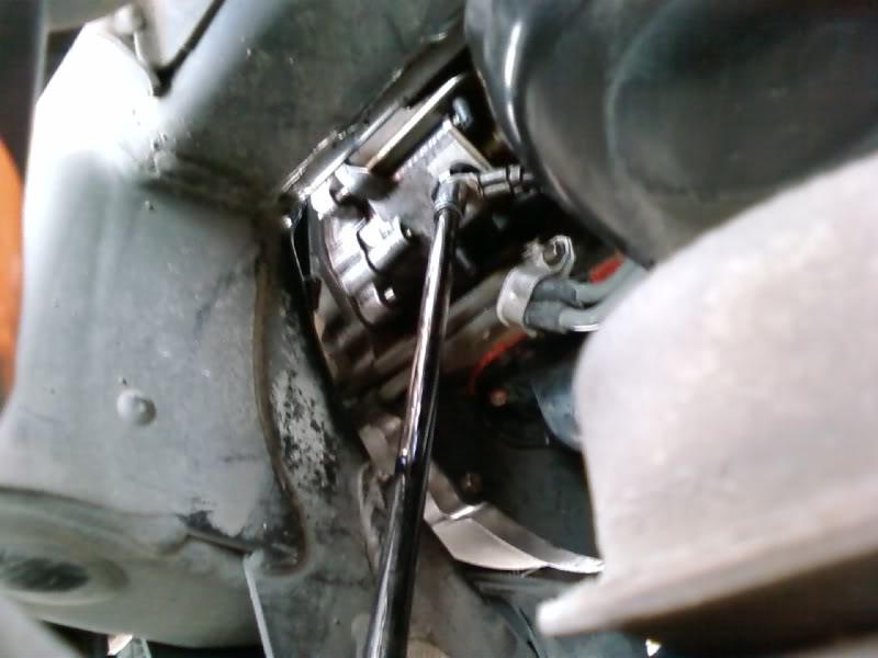

Here's a shot of how I removed the nut holding the power cable on:
