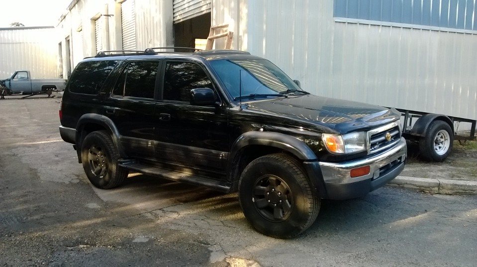

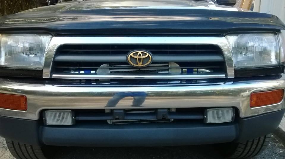

here it is

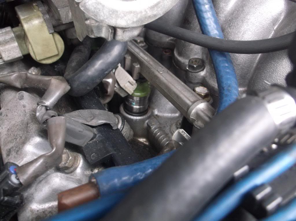

here is the injector

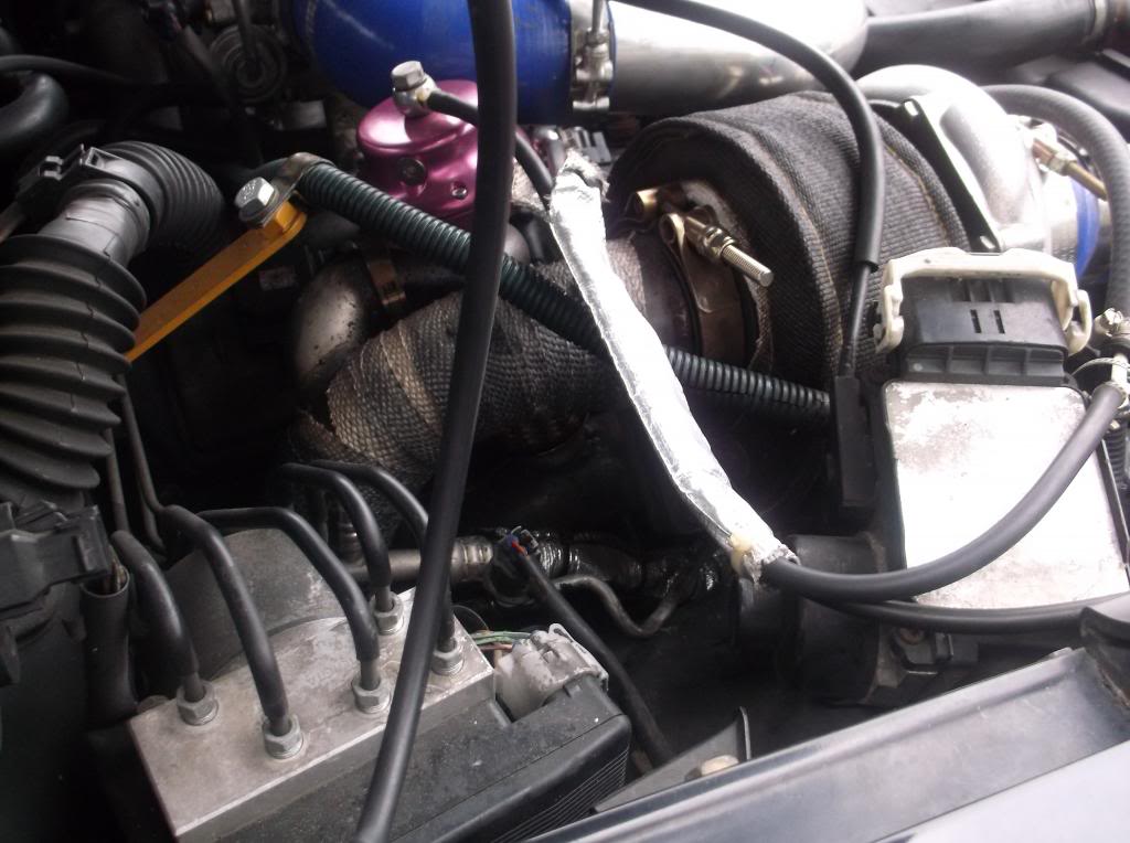

if you look close you will see the stock manifold

this is the custom mainfold...i will try to get better pics tommorrow

the turbo,piping,bov,wastegate...everything but manifolds is from cx. stage 6 put it together then i bought it from their customer, like i said we will tear it done and go through it and make it better, improve some stuff and i will be able to tell you more about whats done to it...because we would have done it...btw i own Tuten Motor Works.
