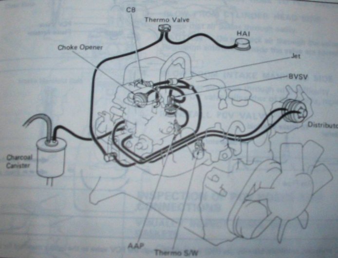

Old Jan 10, 2005 | 08:42 PM
kyle_22r's Avatar
Joined: Mar 2003
Posts: 3,981
From: Lacey, WA
i don't think any of them are totally necessary if you gut your carb...however if you're a normal person who isn't doing roundy-rounds with your foot to the floor, you should at least hook up the AAP, choke breaker, and choke opener, as well as the advance and retard on the distributor.
i did this, and capped off everything else(i think there's only a few other connections to cap on the carb). the reference i used is a canadian '83 vacuum diagram -- they didn't even have an EGR valve back then, while american trucks were strangled with smog junk. the only things i didn't hook up in that diagram were the thermo valve(i have an aftermarket 9" air cleaner so it would be pointless) and the charcoal canister because my truck doesn't have one anyway. we'll see how mine works, i've yet to fire it up but i think it should be fine.

Cool, I'll check that out and see what I can plug
