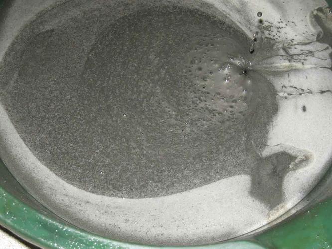

Okay so last night we pulled the drain plugs on the front diff and the t-case. The front diff looked fine, no issues at all. The t-case on the other hand was not so good. The fluid looked like a really nice metal flake paint. Obviously not want you want to see. We did not have the time to tear down the t-case. I have a used one on the way and we will swap them out. Once the new/used one is in, we will tear down the old one to find the actual cause.
My mechanic has a good idea of what the cause is. On the sequoias they have the same t-case and actuator set up, these had a known issue with the shear pin at the end of the actuator. Toyota knew this as a problem on the sequoias, but never listed the same issue for the 4runners. The thought behind this is since the sequoia is so much bigger and heavier, this was the cause of the shear pin failing. Anyway that is the place he has seen this before.
I know we should just tear down the t-case and find the problem first, but this is my DD and I can't be without it. I will post more once we swap out cases and tear open the old one. For fun I have included a pic of what the t-case oil looked like. Keep in mind this oil was just changed 8k ago.
