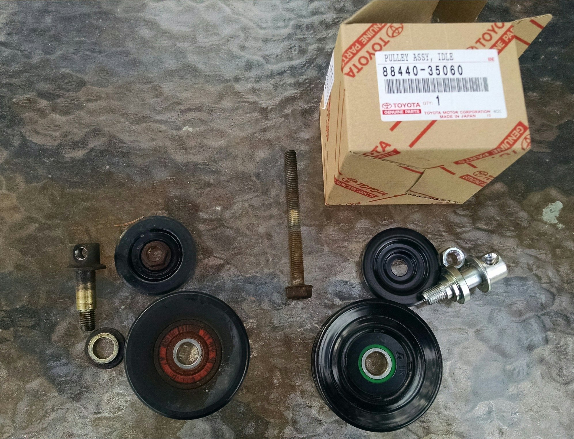

Cold Weather Screeching fixed!
Hey Buoni!
As soon as the parts showed up last week, the temps warmed up into the 20's and 30's and the noise went away. But MY cold came back.
Waited til today to replace the pulley since the snow is gone, it's in the 40's and I'm feeling much better.
I drove it up on ramps and dropped the skid plates for access from underneath. Real easy to remove the nut with a 14MM socket on a long handled ratchet.
It's a tight fit for the adjuster bolt, so I used a 14MM stubby ratcheting combo wrench.
No screeching with the new pulley! The 3 yr. old Gates pulley sounds a little rough, so I did an experiment and put it in the freezer for a bit.
Sounds real bad when I spin it while cold. I'll try to post a follow up vid with the frosty cold Gates pulley.
I'll replace all 3 belts in the Spring when I have more time.
Thanks again for your help!
3 yr. old Gates AC Idler Pulley assembly compared to new Toyota part. Also showing adjustment bolt in the middle of the pic.
