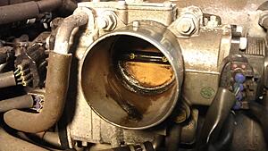

After a few months of dicking around with everything from vacuum hoses to wiring harness connections the issue was too simple:
Clean the butterfly valve. Yeah... mine was a little dirty:
No more issues!

HOLY BUILD UP BATMAN! well, that would do it.

things like this, its almost always something simple. glad to hear those a-holes didnt get their 2300$ for a ˟˟˟˟ty diagnosis. what a bunch of stupid pricks jumping to the worst case scenario like that.
