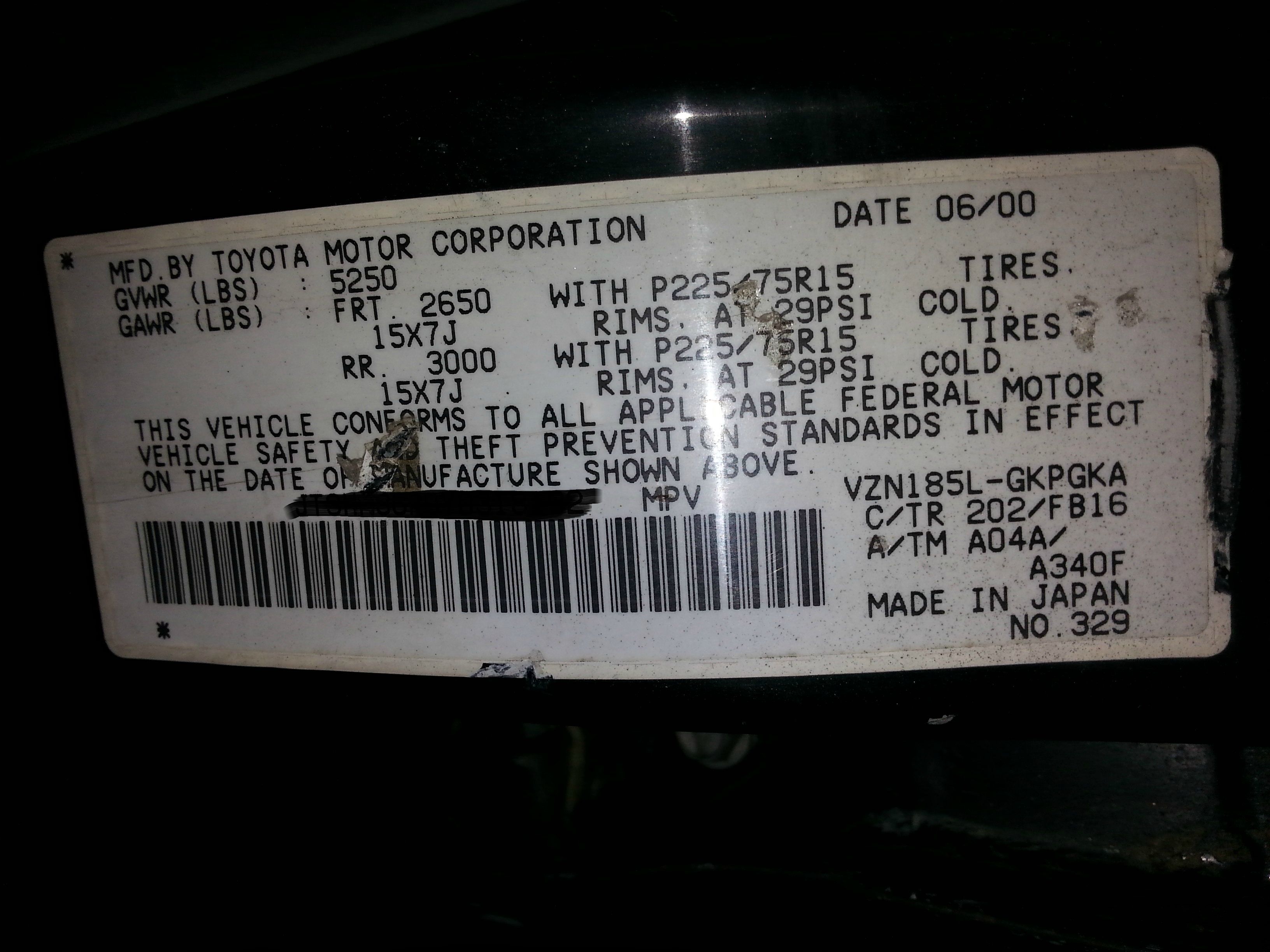

i can't seem to find a refference for checking the door sticker, but from reading it would seem that i have 4.30 due to having the rear locker. the auto's transfer case is not usable with the 5spd trans? i REALLY dont want to swap fron diffs...
heres my door tag:

The door stickers seem to be a bit hazy, I really think you're best served just spending some time doing an actual test on the diff.
We're in the middle of a locker swap onto my wife's '96 manual 4Runner, using a locker axle from an automatic. Her original ratio was 4.10, the automatic locker axle was 4.30. We found the rear axle first on CL, then had to look around for a matching 4.30 front diff. And yes, the front diff is a PITA. It sort of mildly looks as though it might be fairly easy, but it's tucked rather snugly between the engine and crossmember, and the steering rack and sway bar gets in the way as well.
