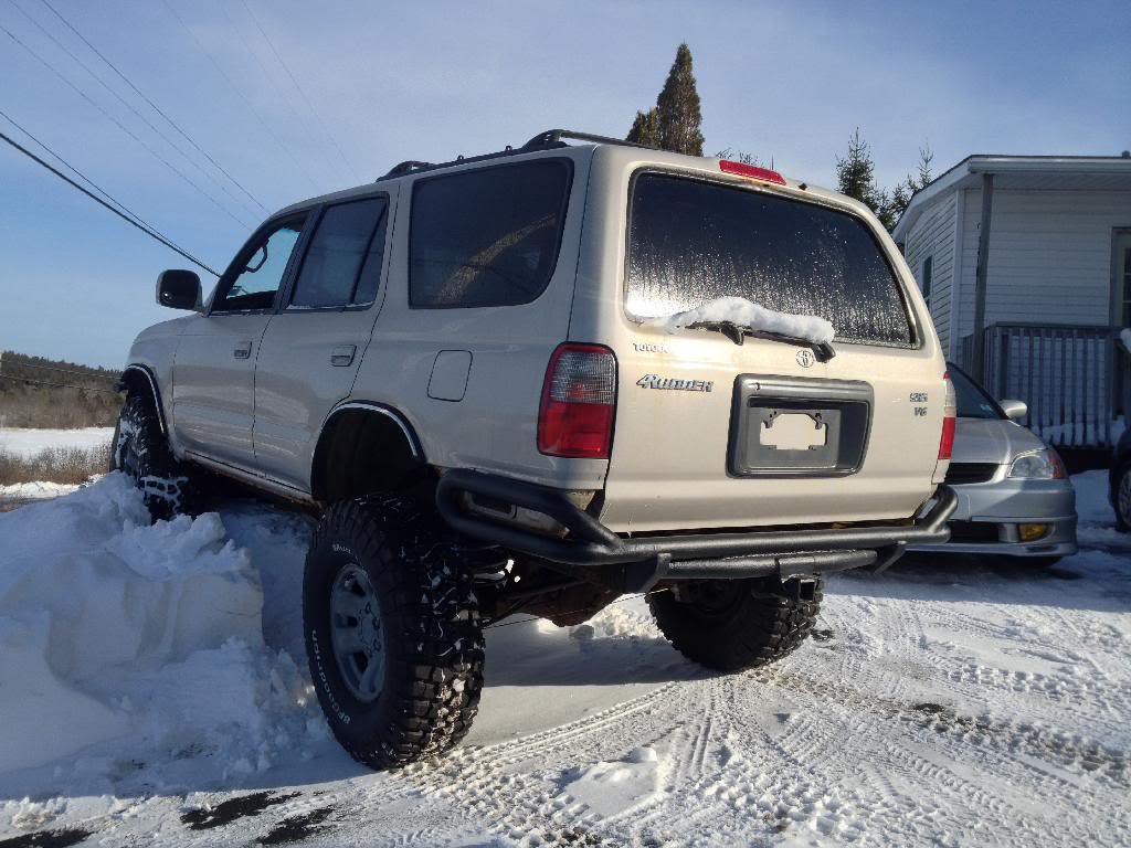

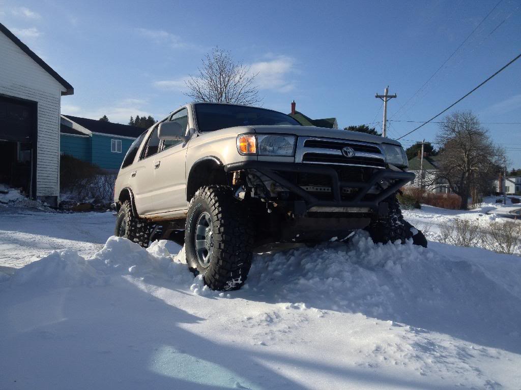

Hey guys and gals
Im new here, but not to Toyotas. I am currently building my 4th Toyota while going to community college for a two year machining program.
I picked up my latest runner on the cheap, and am going to build it for a daily driver (to replace the civic) and weekend wheeler. it will be staying ifs for now, but that will change when I finish school.
so far I have done all the bodywork it needed, a 3" rough country suspension lift, a 2" bodylift, welded up some bumpers, and threw some 305/75/16 mt's on it.
when I got it it had a misfire, the p/o said it started when he replaced the coil packs, there are no check engine lights or codes stored.
so the first thing I did was borrow a set of oem Toyota coils off a running rig to try, nothing, threw new plugs at it, nothing. then went with new fuel pump, filter, and lines (the old gas that ran out looked like swamp water) this did help a little, but still missing when you get into the throttle.
this last weekend I pulled the fuel rails, cleaned the injectors, rails, and put a different fuel pressure regulator on it. still nothing.
I have cleaned all the grounds I could find, it starts fine, will idle all day warm or cold, and is charging good.
im kinda lost as too what it could be and don't really have the money to replace everything under the hood to find out whats wrong. so if some of you guys/gals could give some input, it would be greatly appreciated.

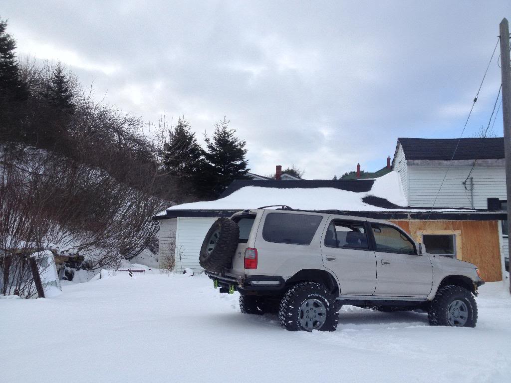

here is a video of it doing its thing

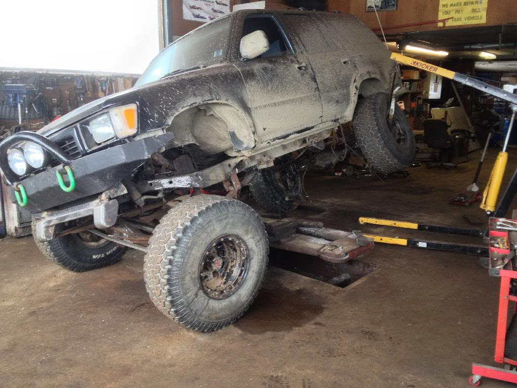

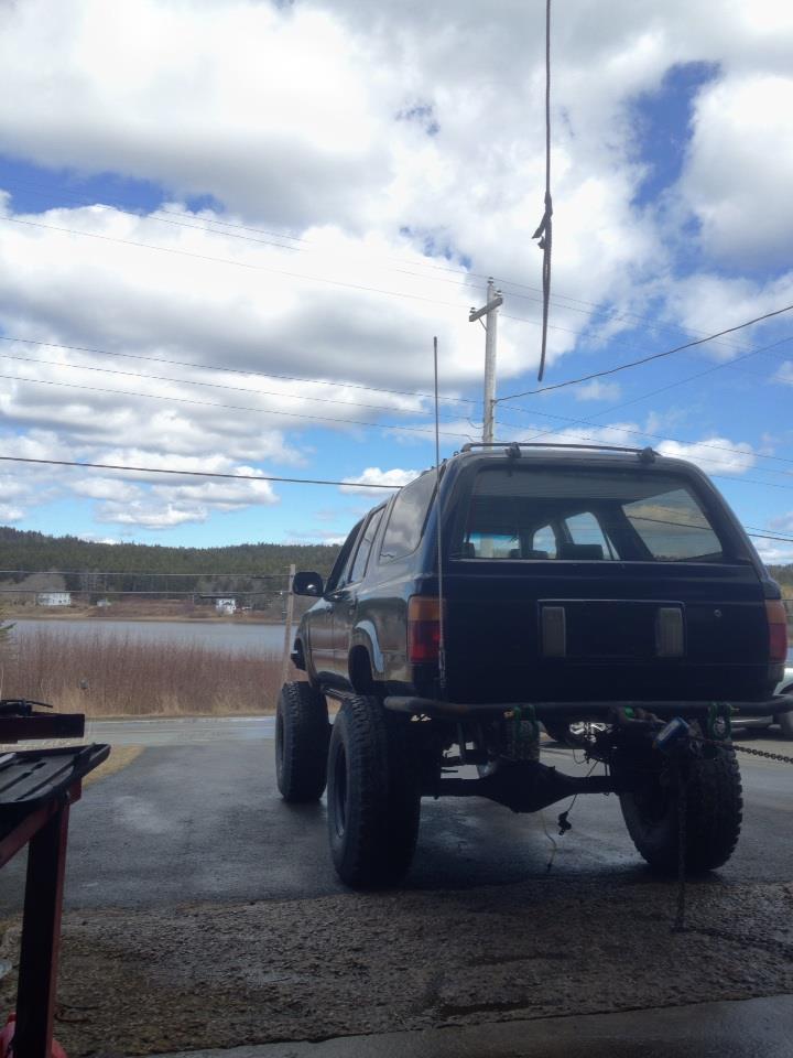

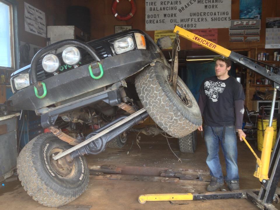

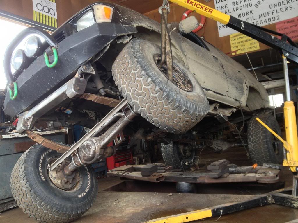

haha, yeah, not a lot goes on here man.... here are some pics of the last runner I built, was 100% bone stock when I got it

Wow...that's one beefy looking bumper. Did you make that too?
Old Feb 23, 2014 | 03:47 PM
madeincanada's Avatar
Joined: Feb 2014
Posts: 14
i made it all, bumpers, spring hangers, shackles.
also the motor was an early 22r that i swapped all late model 22re efi gear onto, with a cam and header, with 4.88's. was by far my favourite of my runners (i have had a 1st, 2nd, and 3gen runners, along with a 2nd gen pickup) and i wish i would have never sold it.
oh well, i love this 3rd gen interior, just wish i could get it running right
