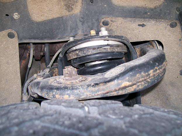

I have the OME 3" kit with the standard springs, and the spacer. 1/2" maybe? Anyways, I have the hitch and about 100-125 lbs. of tools and stuff in the back. No spare.
Attached Thumbnails 1999 4runner OME 881/890 with 1/4" top plate spacer ?-000_0101.jpg   1999 4runner OME 881/890 with 1/4" top plate spacer ?-000_0102.jpg
Hmm... Well your TO spacer has replacement studs which normally come with the 3/8" spacer (which provides around 3/4" of lift). I like the stance that you have.
Thanks for the pics, good lookin runner!
