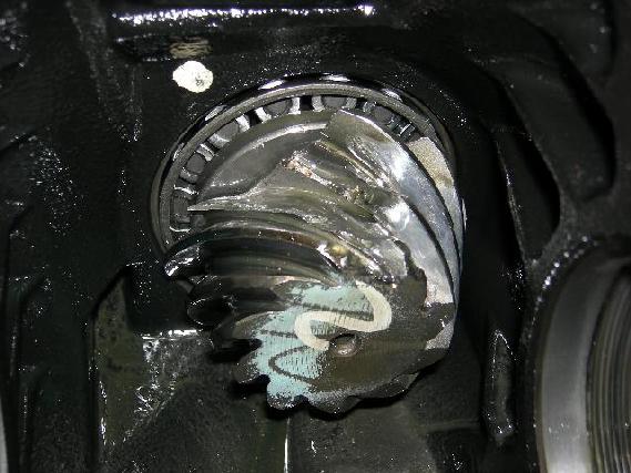

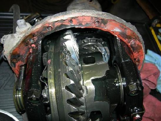

Why I was in there in the first place....
Attached Thumbnails 1998 4runner rear wheel bearings/seals...-4run2002.jpg   1998 4runner rear wheel bearings/seals...-4run06.jpg   1998 4runner rear wheel bearings/seals...-4run5005.jpg
