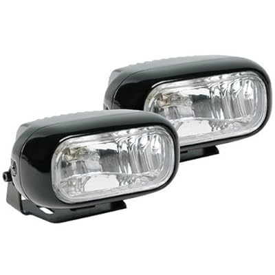

Well ideally, I want to do little of splicing into other wires as possible but I'm capable of doing it with instructions. I know about the lower valance spots that were meant for fogs, I was wondering if there are plugs down there that I can literally "plug" the fog wiring into. in my dash near the dimmer dial, I think there is an empty slot for a switch, when I removed the dash, there were plugs that weren't being used that were tied into the dimmer switch, thats why I was wondering if my setup had all the wiring for fogs in place and just needed fogs. But I'm guessing that isn't the case because thatd be too easy. I was thinking of this

For those little lights you posted why not just mount them on either side of where your front plate would be, run the wiring up and and into the engine bay? Those things are lite weight..mounting those to the plastic wouldnt be bad...

that wasn't my actual 4runner, but what do you mean mount them on either side of the front plate? and how would I do that? also I have no idea what to do about the wiring ( relays, power, ground). I literally have no idea what to do about any of that. thats why I said dummy it down cos im a dummy. I'm still trying to google instructions/how-to's to do this but there is literally nothing I can find. Everything I find is about how to replace fog light bulbs for 99-2002.
