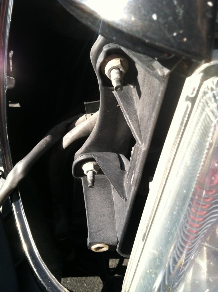

I just changed my corner lights last week and it definitely made me feel stupid for the first couple of minutes. Open hood. Unscrew top screw then put a pry tool, I used a plastic trim tool, plastic putty knife would work. Pry forward. Easy once you realize how it's hooked. The lens is clipped to these two tabs:
