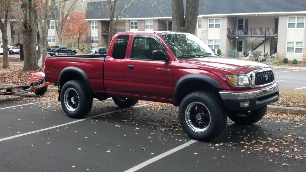

before i start, yes i have read and searched regarding this issue. the prevalent thought is that it is a head gasket. im looking for a second opinion as i believe my symptoms are different.
so a week ago i bought a beautiful 2001 3.4 tacoma with 97k miles. im pretty dang excited as this is my favorite body style and i found it with low miles. at 96k mi it had the whole timing belt job done as well as plugs, wires, new tires, 2.5in lift, etc. this truck is just about pristine and it has clearly been babied.
fast forward to last night. i hop in the truck and start it up. white smoke out the exhaust. well crap! im immediately thinking head gasket as i had blown one awhile back in my 87 4runner. i turn off the truck and check the coolant and oil. coolant is completely topped off (and possibly undiluted, it is way too green) and the oil is fresh and non milkshakey. so i drive it and it does fine, no issues. i even started it later that night with no smoke after it had sat for probably 6 hours.
today it started smoking again. woohoo. this is not bad smoke but it definitely is smoke, not vapor. all fluid levels are proper and the fluids have not mixed.
Thoughts and opinions? the truck is too nice to have been beat on and there are no tell tale signs of a head gasket failure, which i am familiar with. im leaning towards some type of fuel issue as i have been getting poor mileage (15mpg of straight unloaded highway driving which usually gets me 19 in my 3.4 4runner) and the truck sometimes has trouble starting. i welcome all help. thanks!
truck in question...
