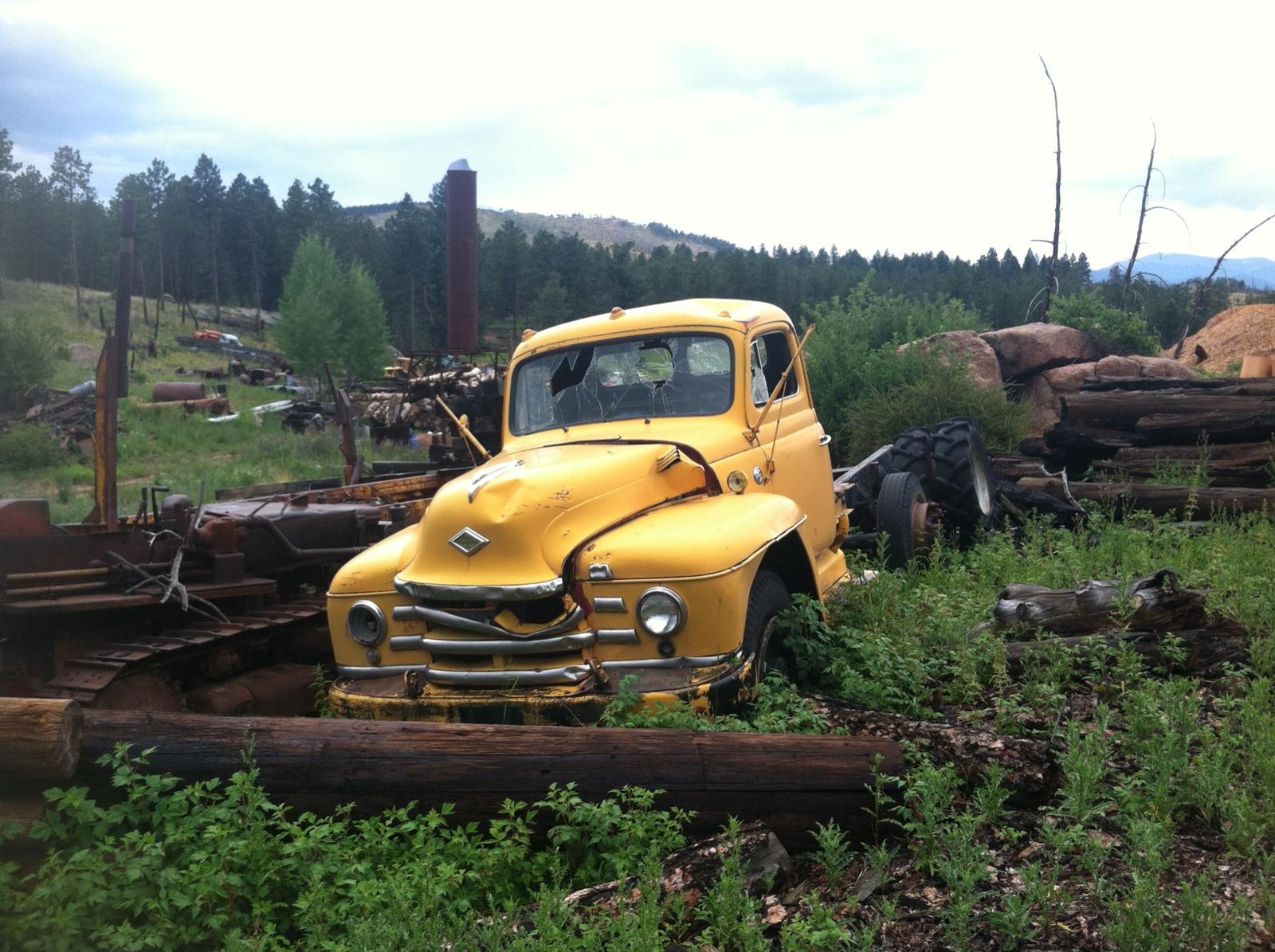

I am supposed to be getting a '55 Diamond T. Going to drop a 7.3 Powerstroke with a 6 speed in it. Diesel rat rod crawler hauler.

Congrats on the magazine coverage! Nice work on the SAS, the 37s look sweet on there! That Diamond T looks like it would make a sick tow rig!

That Diamond is SWEEEEET! Nice find! I see all the rat rod stuff you post, I cant wait to see how it comes out. Make sure you do a build thread for that one too!

It will certainly be getting a build thread. I have to pick it up first though. It belongs to a friend of mine from high school and his family. It was the log truck for their saw mill back in the day. I'm stoked to get it though! I will have my own rat rod now!

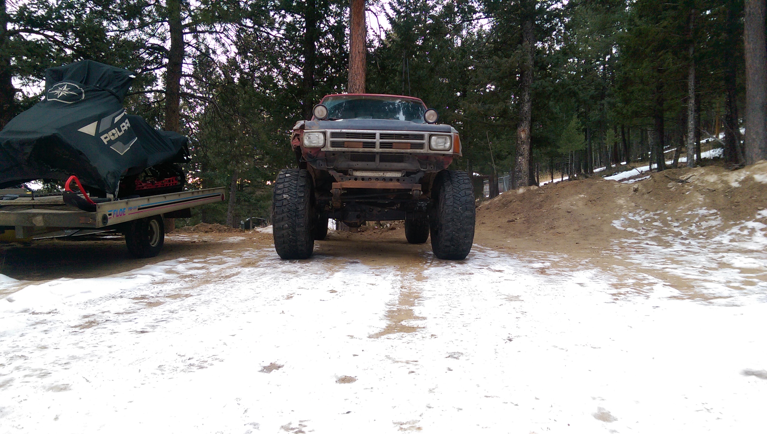

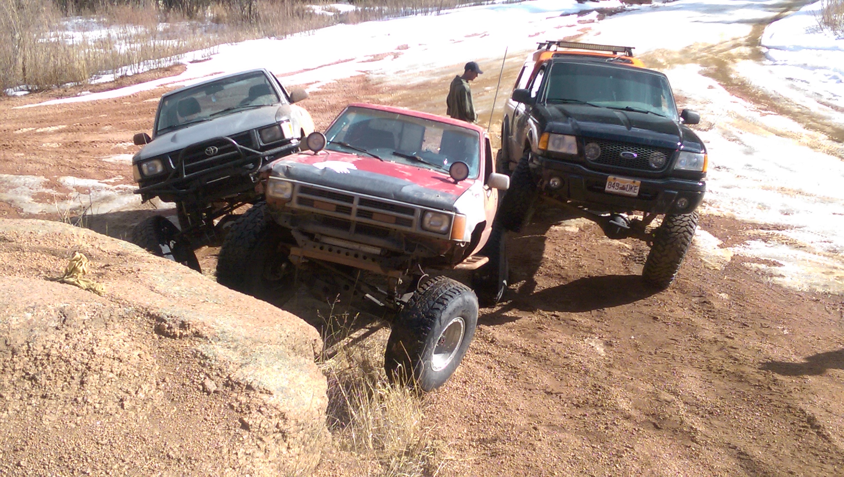

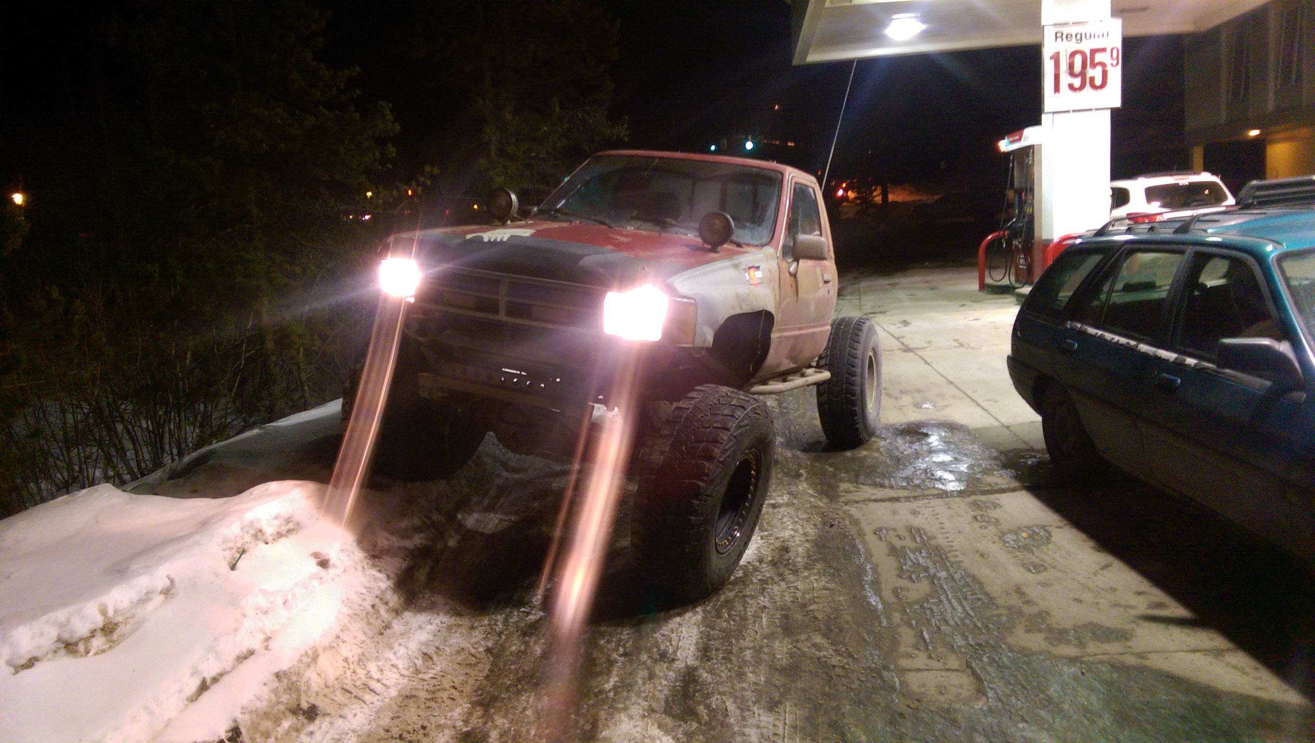

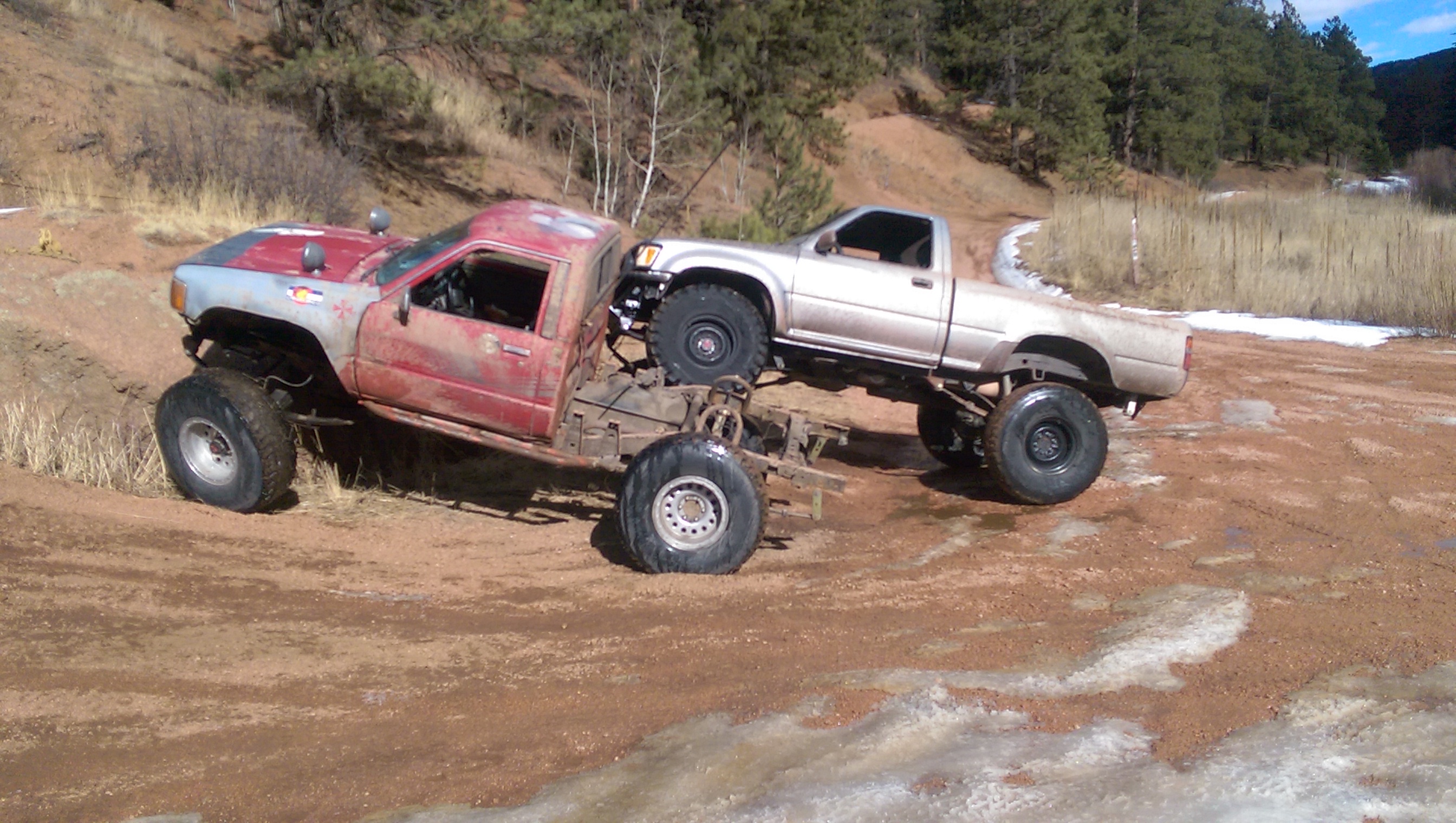

Did some trail riding on Sunday looking for a trail that I went to once last year. Couldn't remember how to get there so we just drove around all day. Got some pose pics

I am going to swap the rat springs for 63" Chevy springs probably next week. The 52" rears just don't compliment the front springs enough.
I still hate the military tires, they suck on snowy ice. So I picked up a set of 4 50% 37" kevlars last night for $300. ISO some 17" steel wheels that I can make bead locks with.

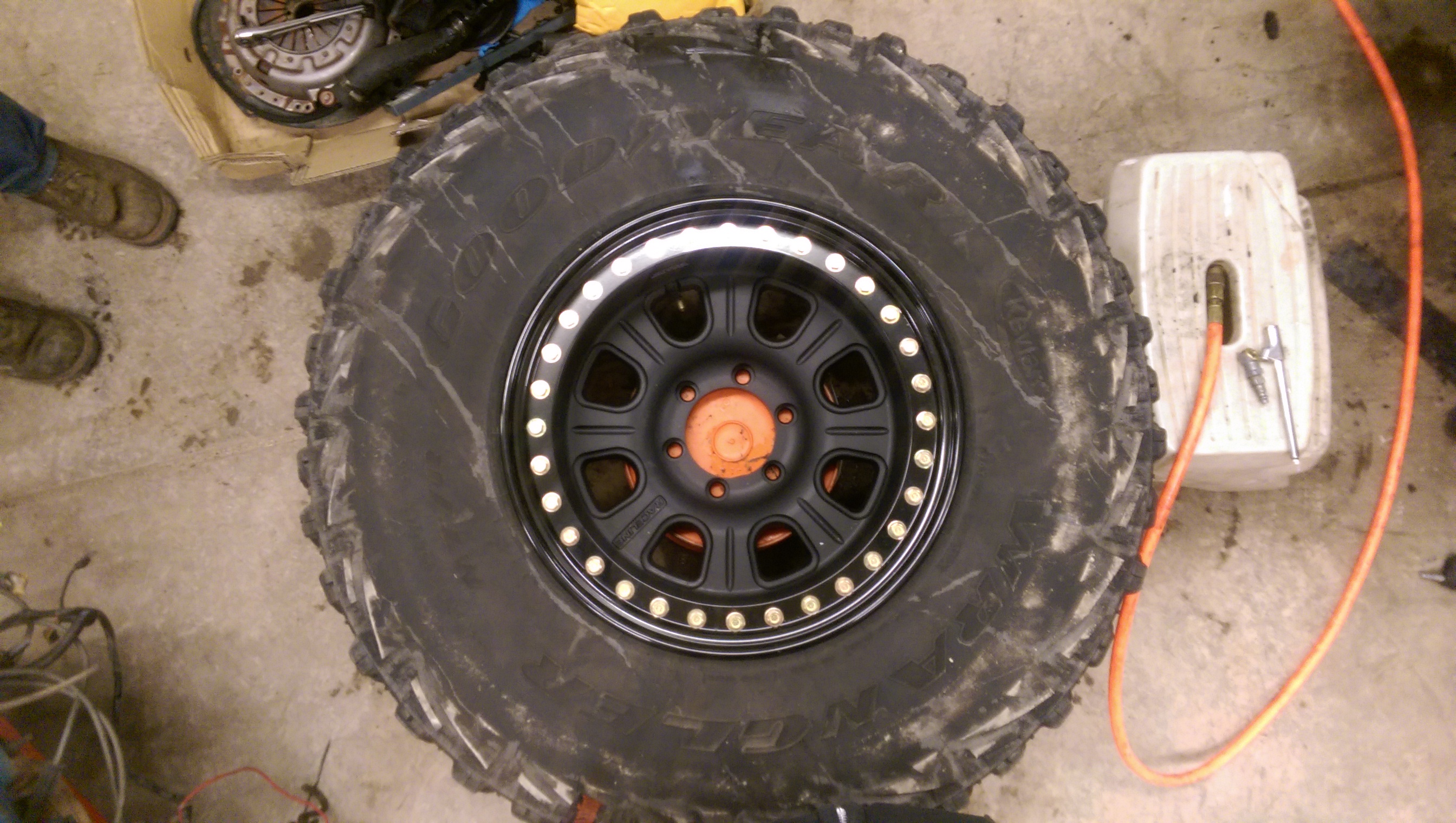

Teaser anyone?

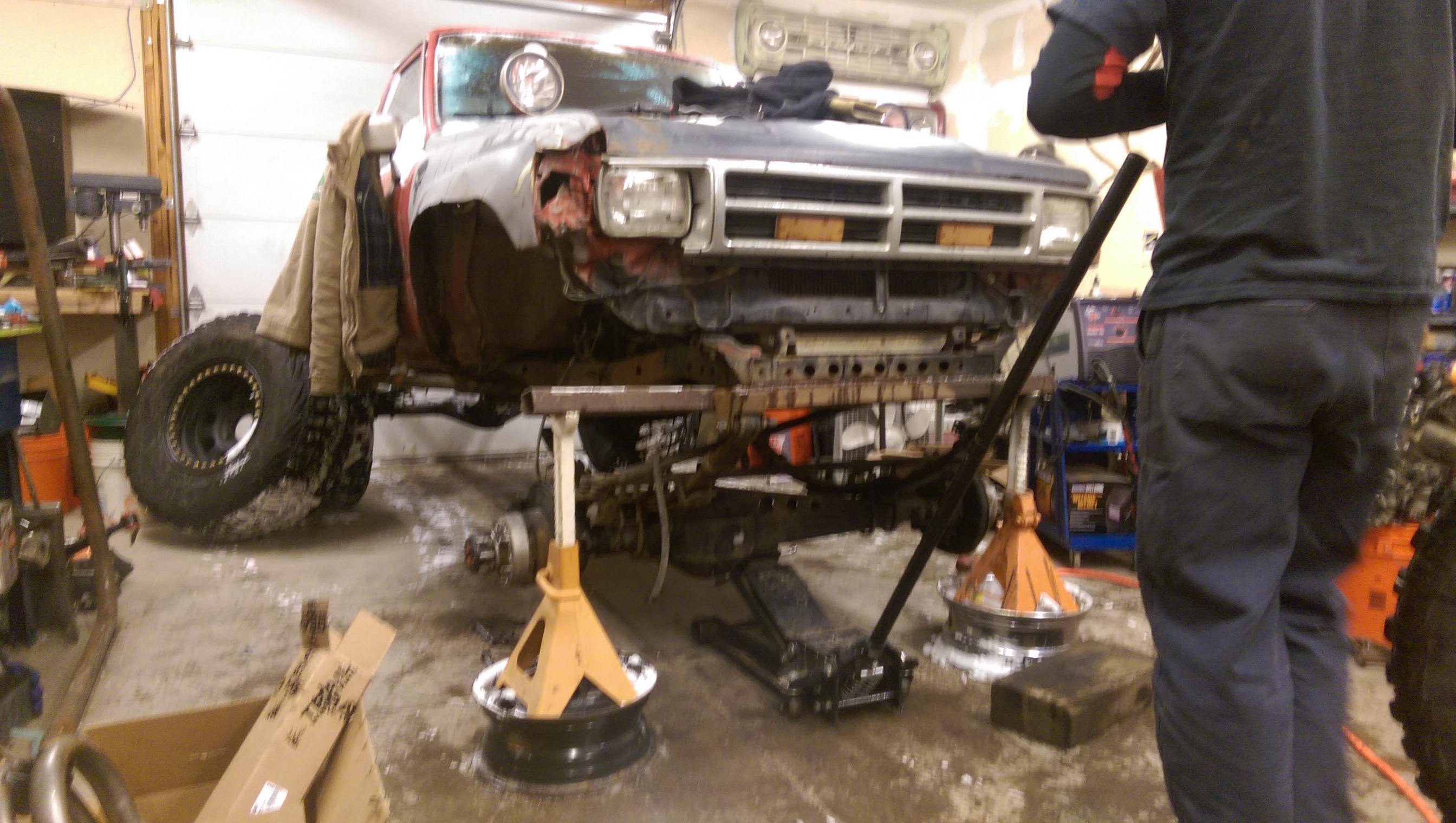

Front two are on. Still waiting on Brown Santa to bring the 4th.
The stance with 1.5" wheel spacers. 4" BS on the wheels. I like it alot

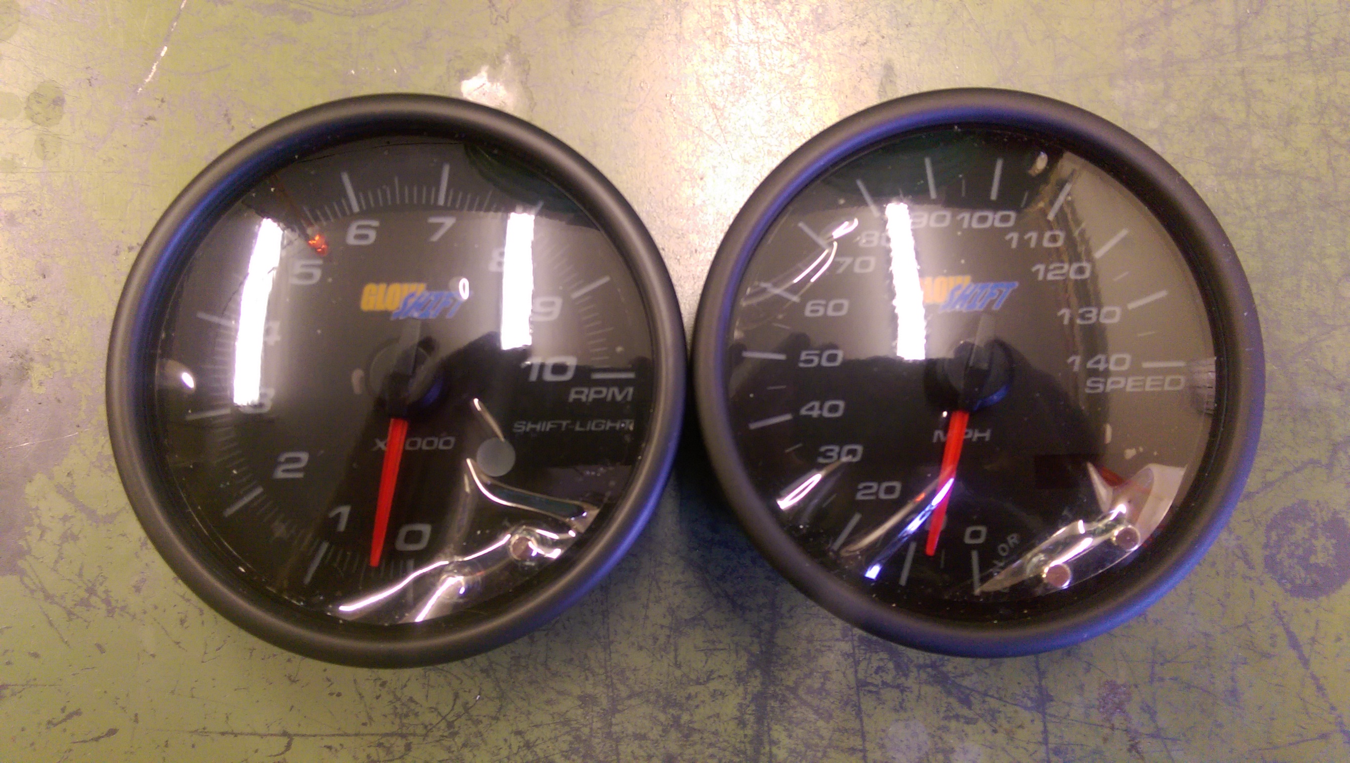

Some gauges I'm going to build into a custom gauge cluster

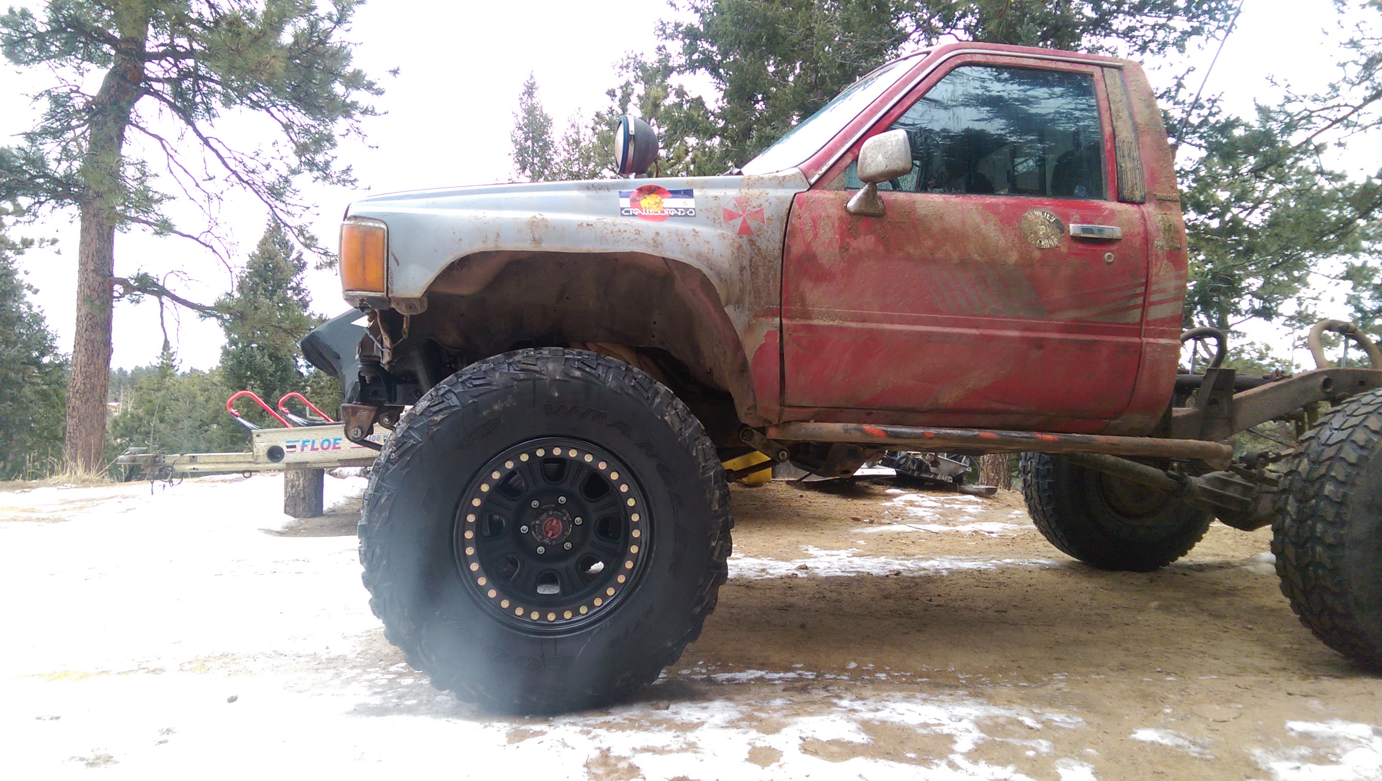

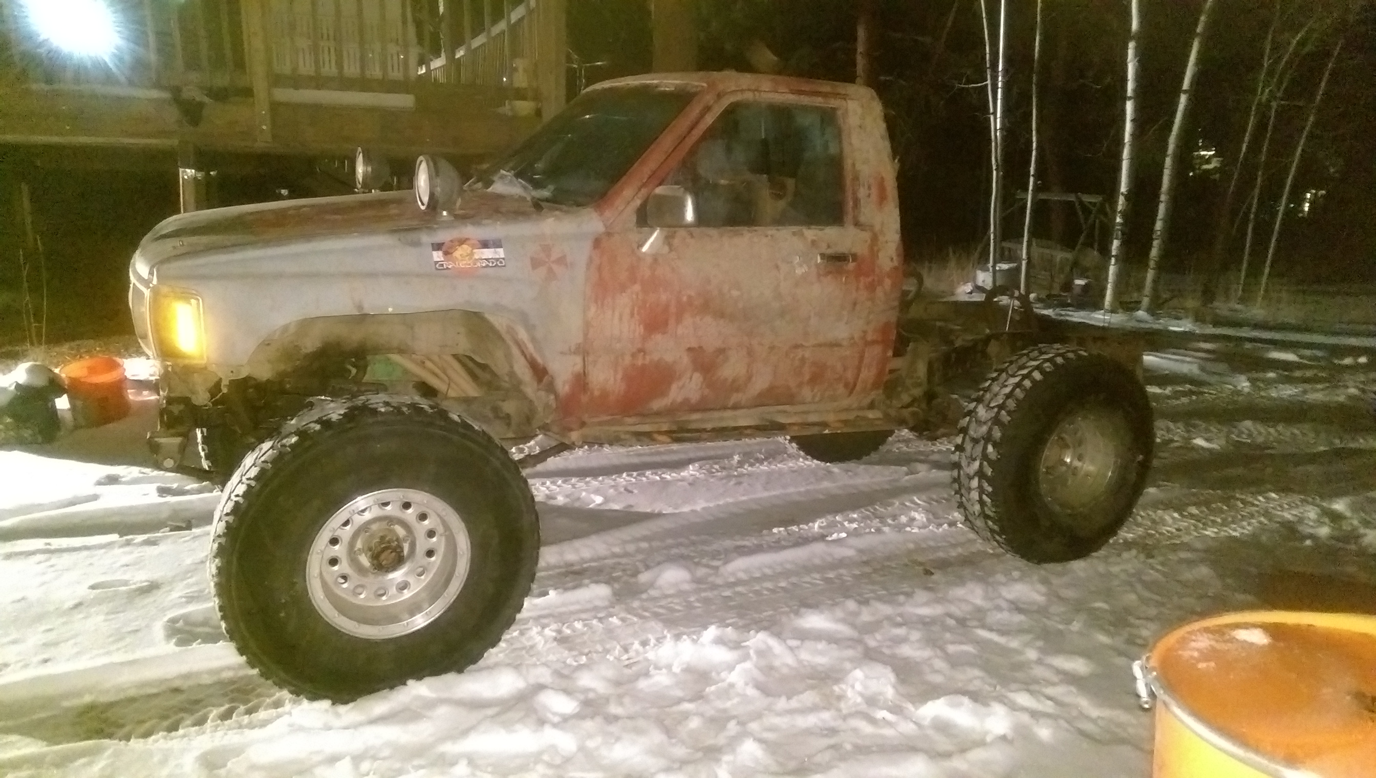

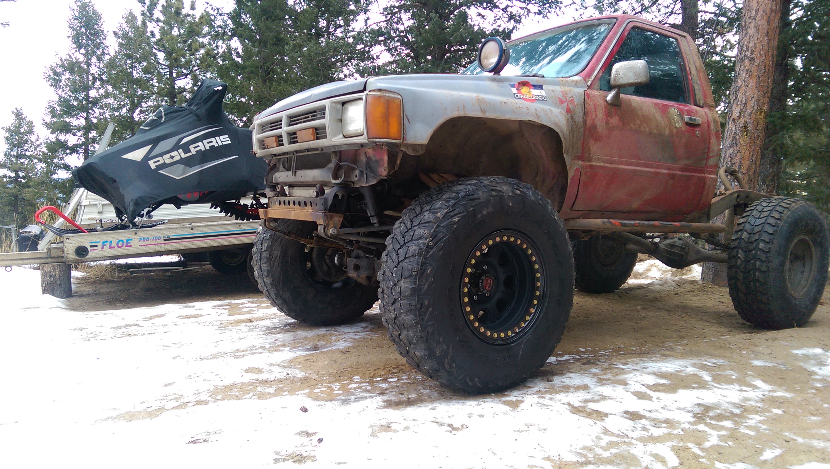

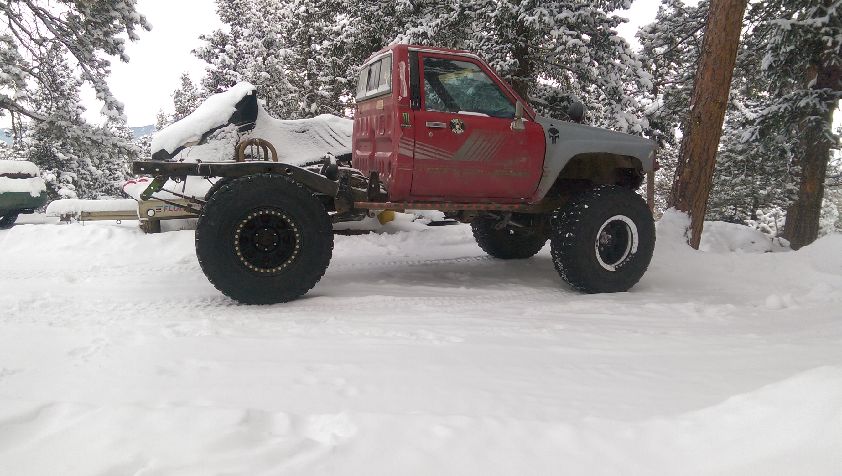

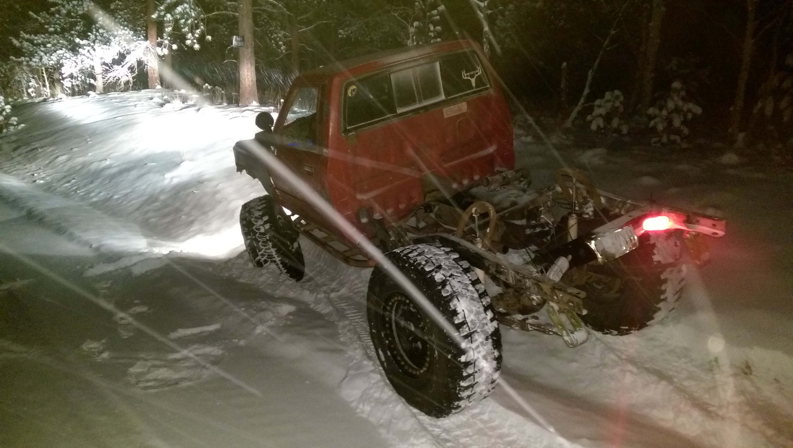

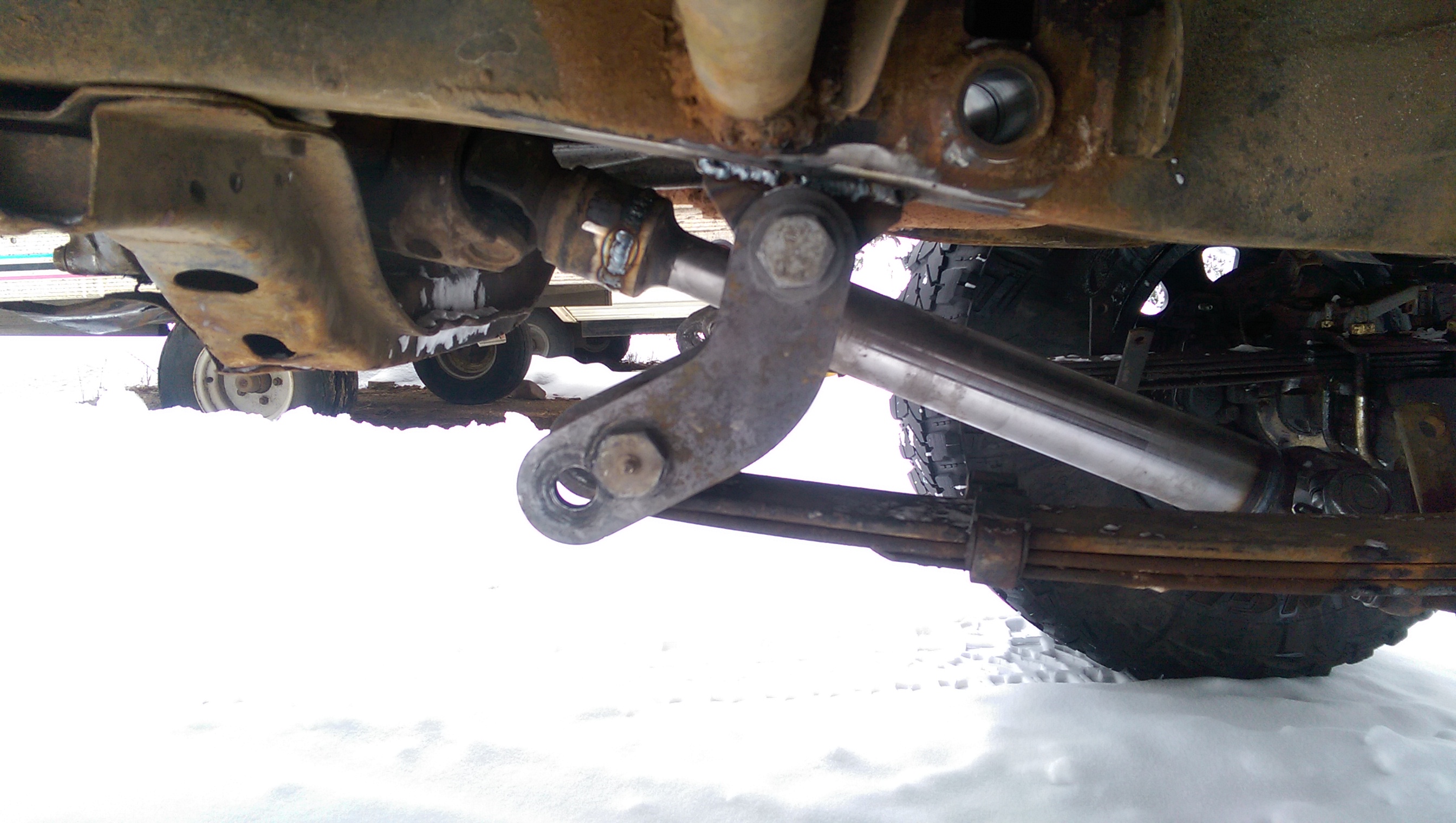

Got some good work done this weekend. 63s finally on, front shackle angle finally fixed and the front driveshaft is no longer too short. Now I just need longer shocks in the rear and I'll be good to go.

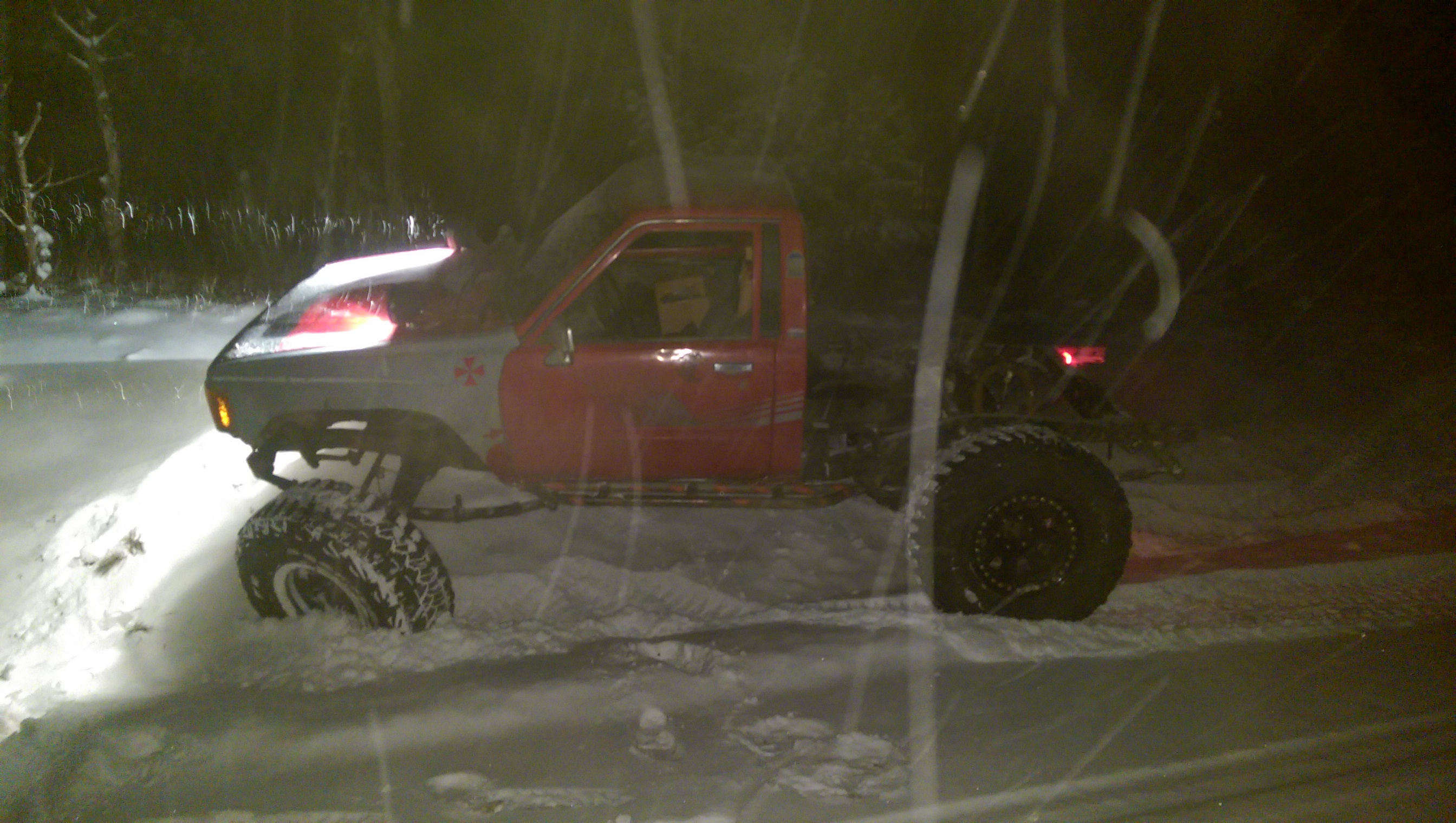

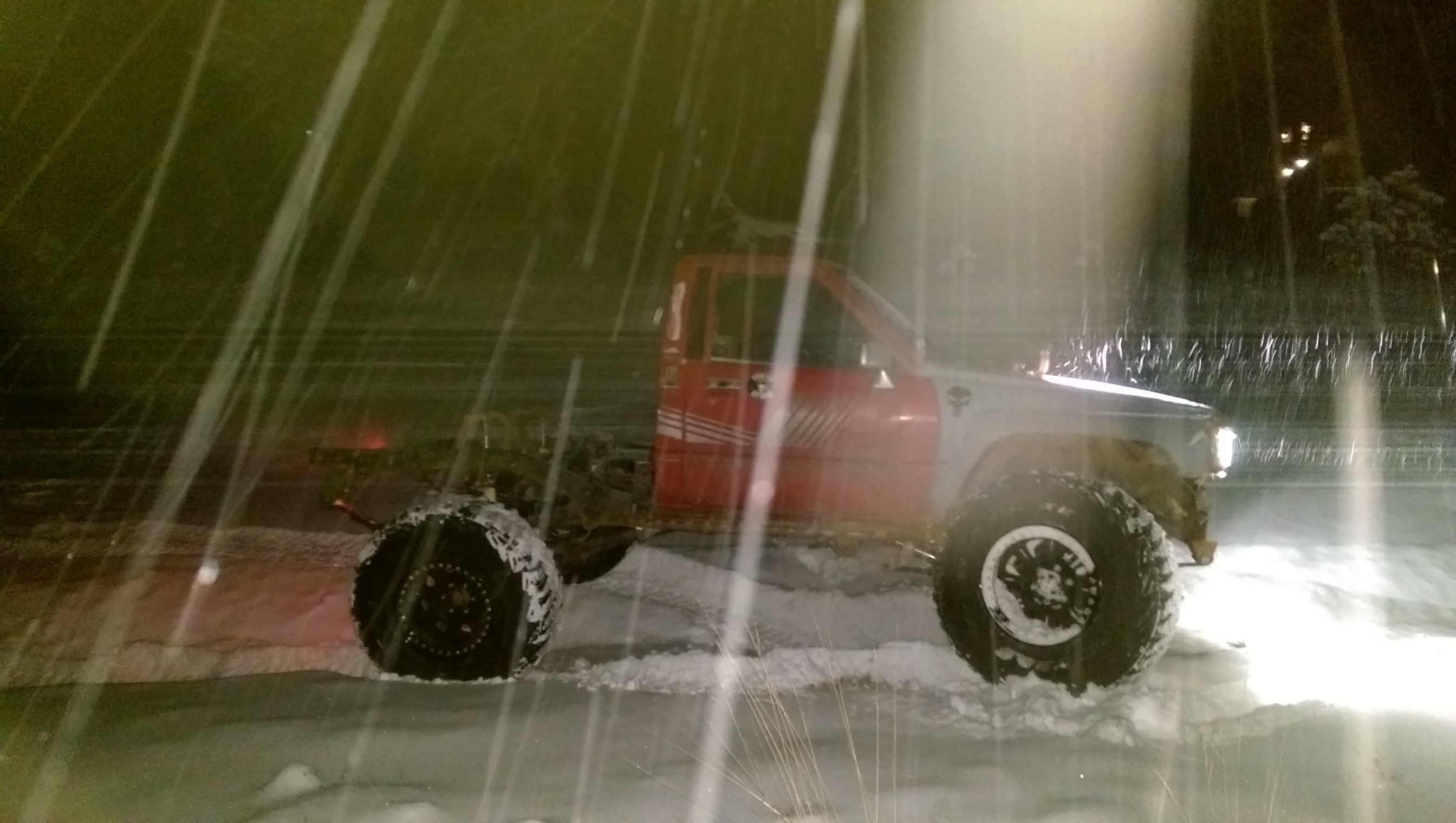

Playing in the snow after wet finished up
She sits a lot more on the level now with the 63s. Rides better too.

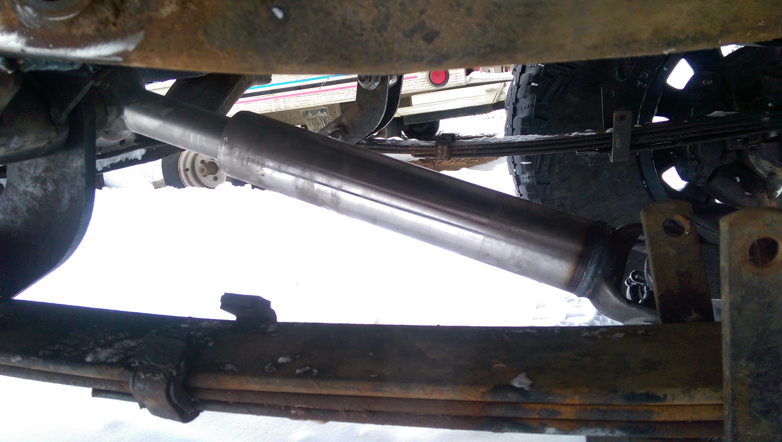

New long slip driveshaft

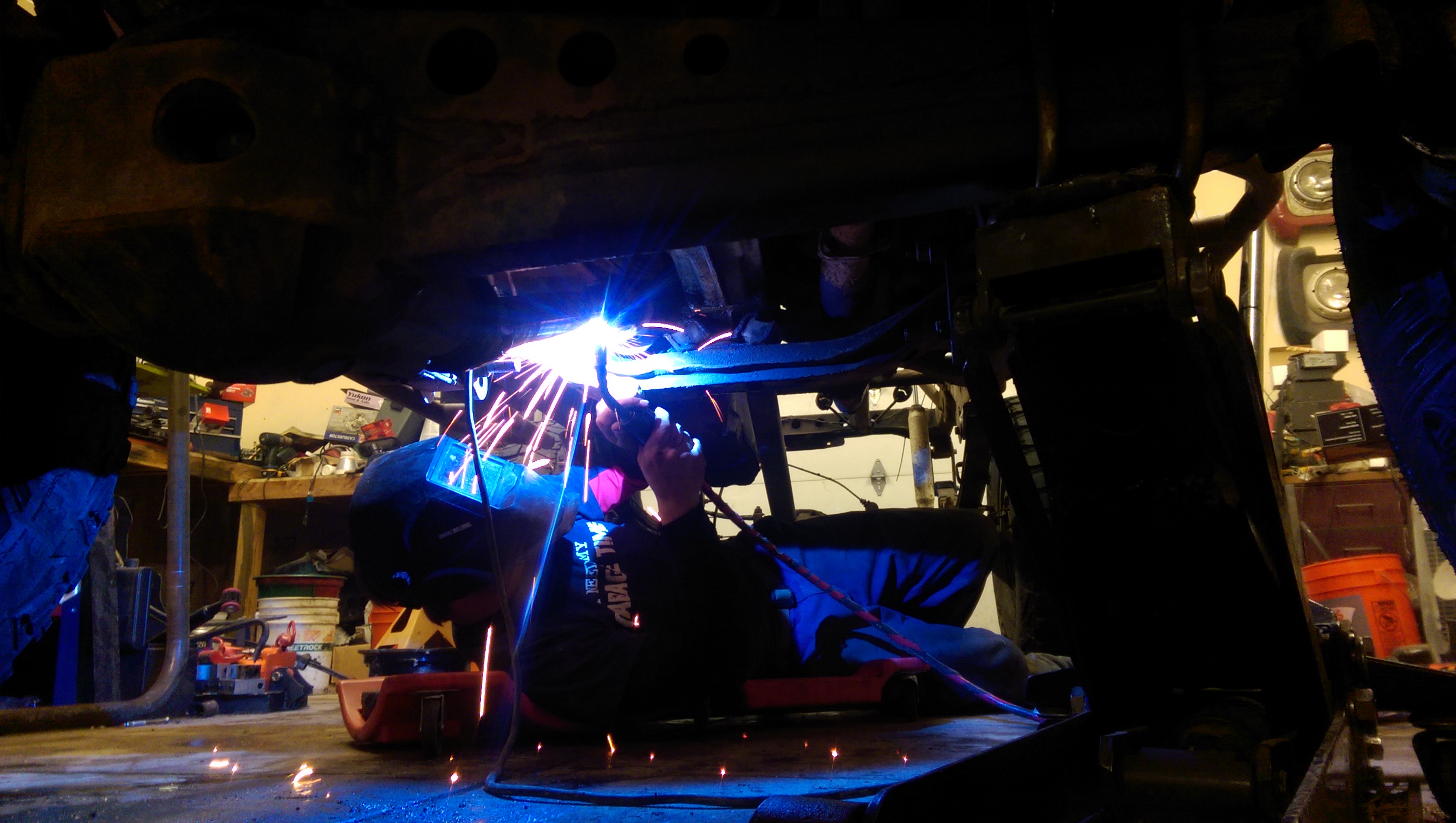

Better shackle angle. Had to go with hangers on the button of the frame since I went with the 51" rears.
