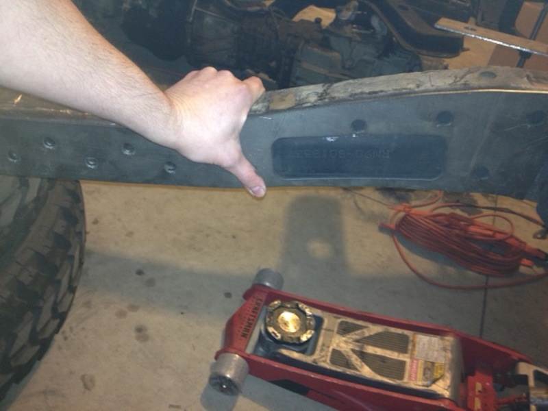

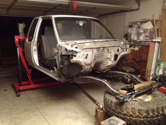

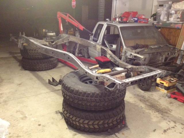

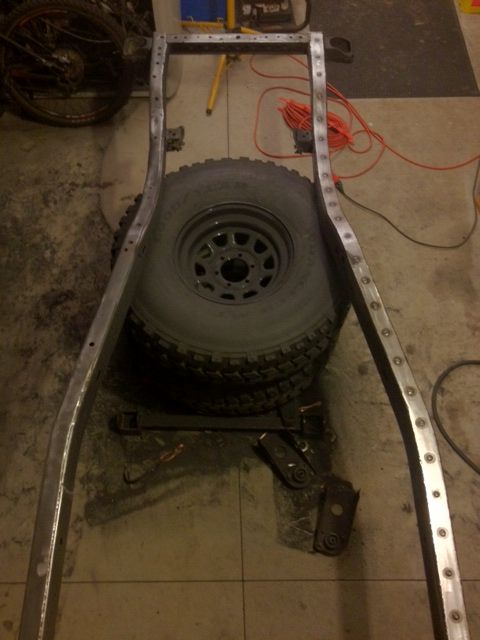

Right now I've got the frame stripped down, just about done cutting off all the brackets not needed and stripping the frame to bare metal. Hopefully this weekend I can fill most of the frame holes that fall into my frame plate rosette weld holes. The frame plates where made by me in Soldworks, cut on a plasma table out of 11 gauge. I'm not worried about it being to thin as I am fully boxing the frame front to back. Yes the front cab mounts are gone, I'll be making my own.
Attached Thumbnails x250f23x _ 1990 pick-up X-cab 2WD frame _ KOH pre-runner-3-14-2012.jpg   x250f23x _ 1990 pick-up X-cab 2WD frame _ KOH pre-runner-frame-plate-mockup.jpg   x250f23x _ 1990 pick-up X-cab 2WD frame _ KOH pre-runner-frame-plate-vin-cut.jpg

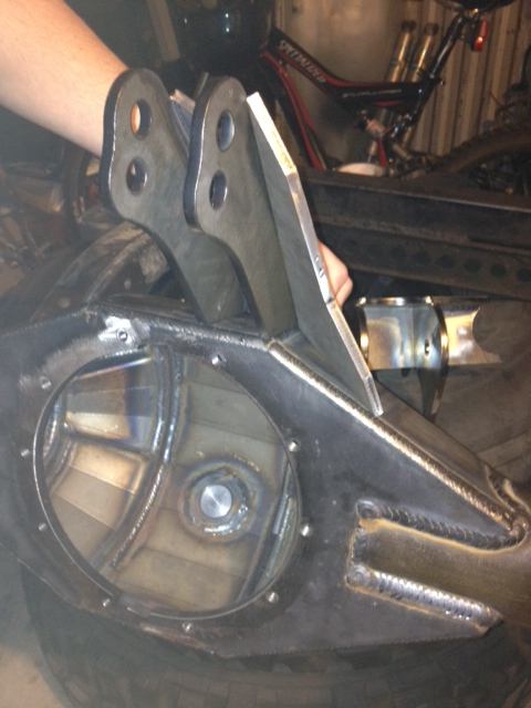

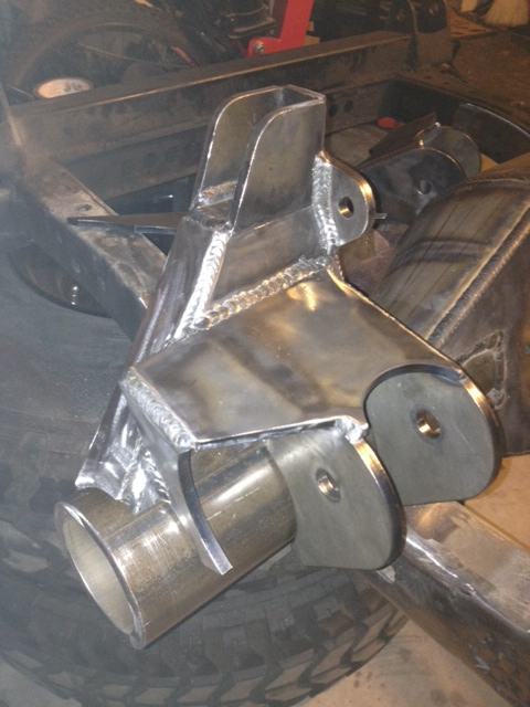

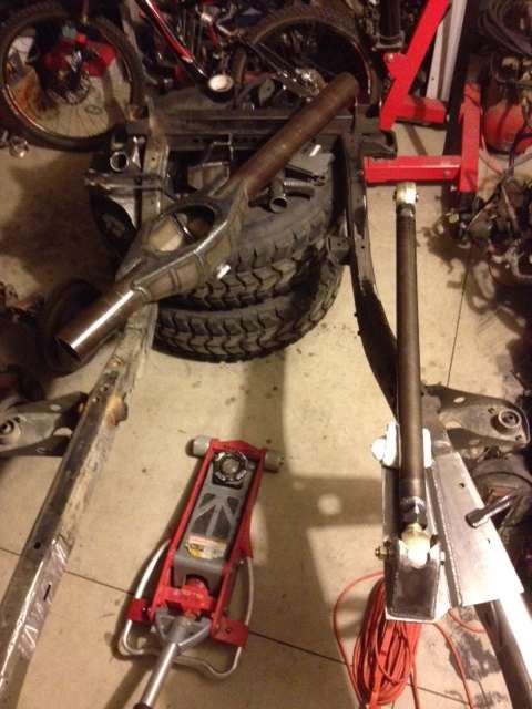

Stuff's not in the right spot, but thought you would like to see the some of the three link kit from 4WU and the Ruff Stuff axle

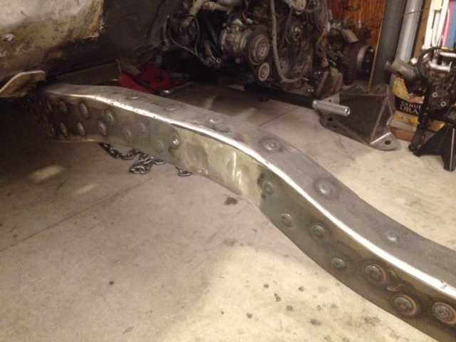

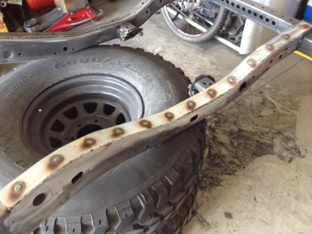

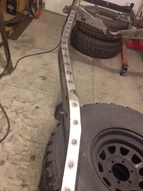

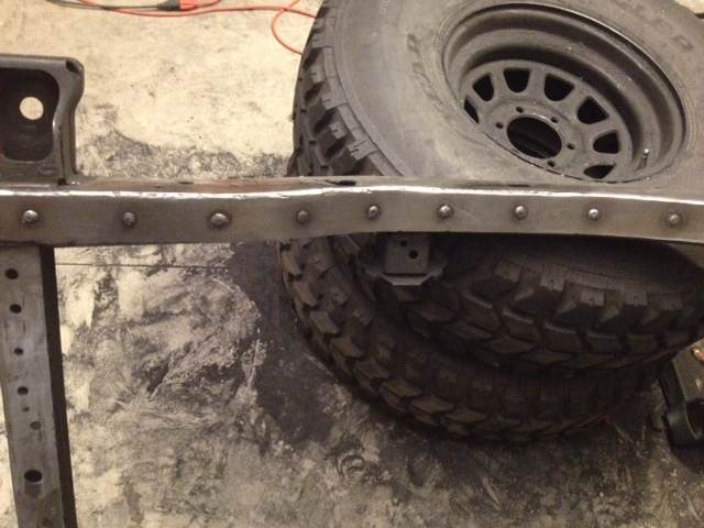

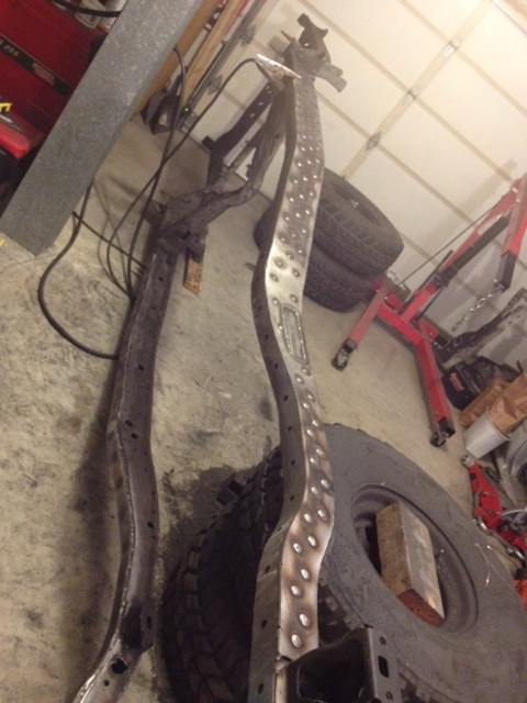

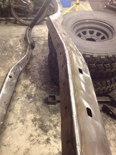

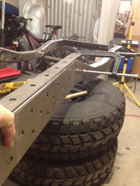

A few pics of the bottom frame strap. I'll be leaving the rosette welds, they look like big rivets, should look interesting when all the plates are welded on.
Attached Thumbnails x250f23x _ 1990 pick-up X-cab 2WD frame _ KOH pre-runner-2.jpg   x250f23x _ 1990 pick-up X-cab 2WD frame _ KOH pre-runner-3.jpg   x250f23x _ 1990 pick-up X-cab 2WD frame _ KOH pre-runner-4.jpg

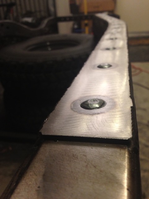

Put the next bottom strap on and got one side welded up tonight
Another pic of the "rivet" look
Attached Thumbnails x250f23x _ 1990 pick-up X-cab 2WD frame _ KOH pre-runner-3-26-2012.jpg   x250f23x _ 1990 pick-up X-cab 2WD frame _ KOH pre-runner-photo.jpg

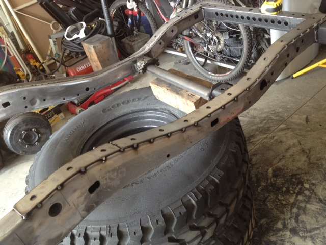

More plating pics...

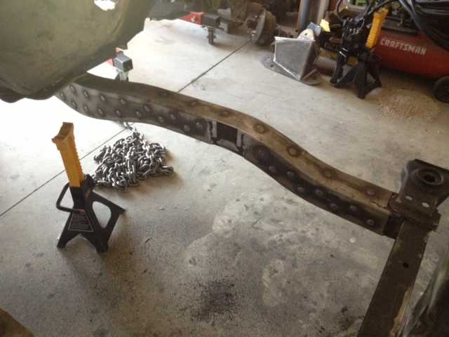

So the bottom side strapping is done.
Next, I've started on the passenger side top strapping. Tomorrow I should have that all welded up and starting on the side plates tacking.

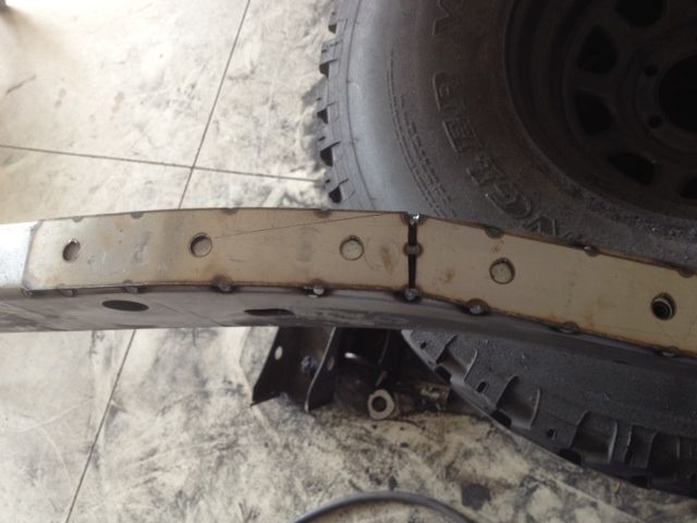

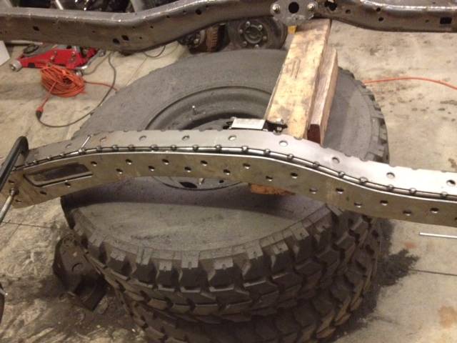

Passenger outside plating done

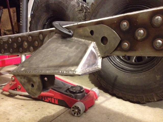

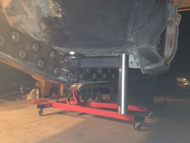

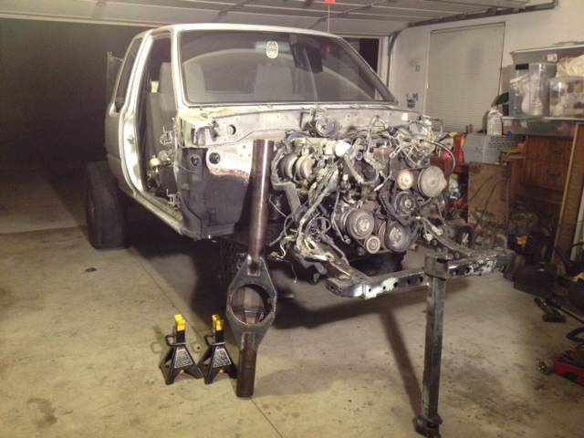

Frame is done (for this year). Finishing the front cab mounts tonight. Once I make up my mind about a transfer case mount, the motor will go in.
As for the 4WU 3 link kit, just get it. By far the best, and best looking kit on the toyota market.
Attached Thumbnails x250f23x _ 1990 pick-up X-cab 2WD frame _ KOH pre-runner-1343841892.jpg   x250f23x _ 1990 pick-up X-cab 2WD frame _ KOH pre-runner-1343841942.jpg   x250f23x _ 1990 pick-up X-cab 2WD frame _ KOH pre-runner-1343842770.jpg

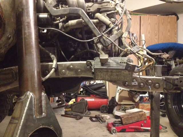

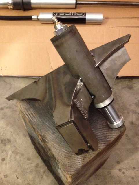

From the last post.. I had the motor in. But I wasn't getting all the up travel I wanted with out running into the oil pan and the axle side top link bracket was hitting the motor mount perch, so I removed the drive train so that I could cut the stock motor perches off and look at my options of moving the drive train higher. I plated and filled in the area where the perches where. Now I have the drive train sitting kinda where it needs to be.
Got my Shocks (Radflo), Springs (PAC) and Bumpstops (Radflo) from Brian at 4WU.
I made CAD files of these motor mount perch face plates to use with the LC Engineering Street Mounts. I also ordered another set of these mounts to use in the rear; transfer case mount.
I finished my transfer case mount yesterday and submitted my files to have cut last night. Once I get everything in, I can hang the drive train and start on the 4 wheel underground bracket locations.
Attached Thumbnails x250f23x _ 1990 pick-up X-cab 2WD frame _ KOH pre-runner-.jpg   x250f23x _ 1990 pick-up X-cab 2WD frame _ KOH pre-runner-b.jpg   x250f23x _ 1990 pick-up X-cab 2WD frame _ KOH pre-runner-c.jpg
