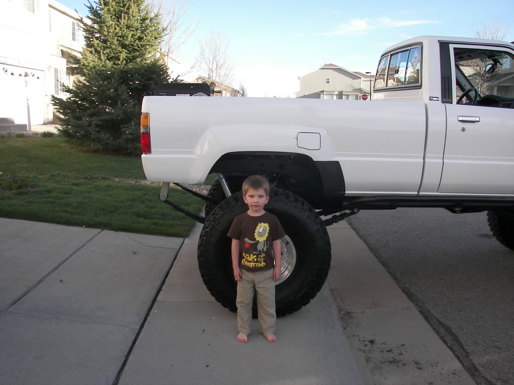

Painted the tailgate, Having Scotty@ addicted offroad add his reinforcement plate to the front of the frame and see if he can figure out what moved when i hit my buddy. That should be this week sometime.
37's are on and it rides sooo much better. i do have a slight vibe on the highway from my pinion angle being a little steep but that will be fixed soon.
The truck at my buddys today...His son loves the rock crawlers.
you can see the tailgate here...Shackles out back are settling and it only took 900pounds of tools and an hour drive both ways.
