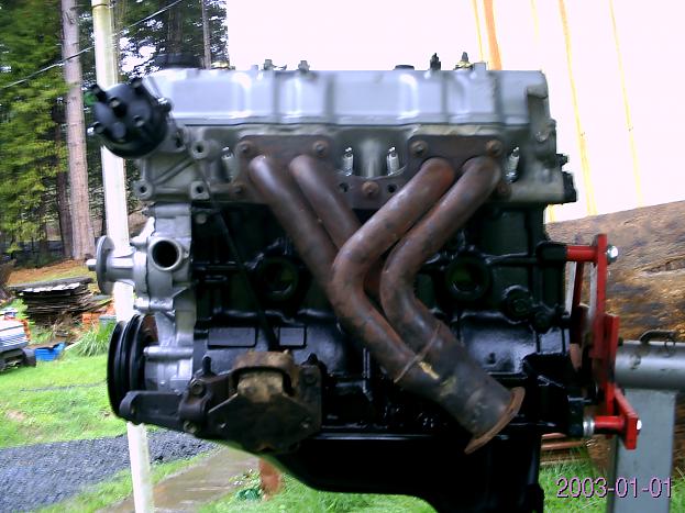

Alright, so I'm in the middle of a rebuild of my '85 4x4 pickup. I'm about 3/4 of the way done until I try to fire it off, but just wondering if anyone had good ideas on time savers, maintenance tips, etc...Let me tell you about the truck:
'85 4x4 SR5
22RE, SFA
I Spun the #4 Rod bearing and when I disassembled the motor, it lookid like it had been put together dry! Every last bearing was scored into the copper, and the motor only had 75K on it. I took it into Don and Anthony at Don's BC Machine Here in Roseburg, and Had it reworked. .040 over on the bore, Balanced, .435 lift cam, heavy valve springs, and a Headmann short header, and 2.25" exhaust into a 40 series flowmaster. Will the computer handle such a big cam? anyone have experience with this? The machine shop told me they had never put this big of a cam in a computerized yota. They offered to change the cam for free if it didn't work, but just curious before I get this thing completely done, and findo out it doesn't like it! lol
