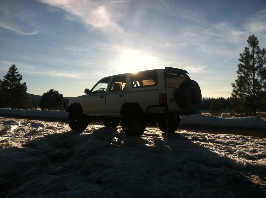

Some recent wheeling pics. . .
Old Feb 11, 2013 | 08:34 PM
  #87
ChefYota4x4's Avatar
iTrader: (5)
Posts: 19,281
Likes: 20
From: Lake Havasu, AZ
Oooooooh, sexayyyy! Lol. .. shes gotta nice rump homie! Hahaha.

This truck, I like.

Oh, and nice rump she has,..... as in tail end? As in butt? Hahaha.

Thanks man, I appreciate it! I'm hoping to add a few more things before she sits in my driveway while i'm away at college haha.

Why thank you sir! I like to think so myself Except for the damn tail pipe, i'm considering cutting it back some but I don't know if it'll effect smog? Or make it annoyingly loud

You don't want to cut it back it will leak more exhaust into the rear cab area thru the fender wells. And increase condensation under and in the wheel areas.
To make it look smoother.. Get it closer to the body, new section aft of the muffler, or maybe just new bends. And find a dress up cap to put on it.
