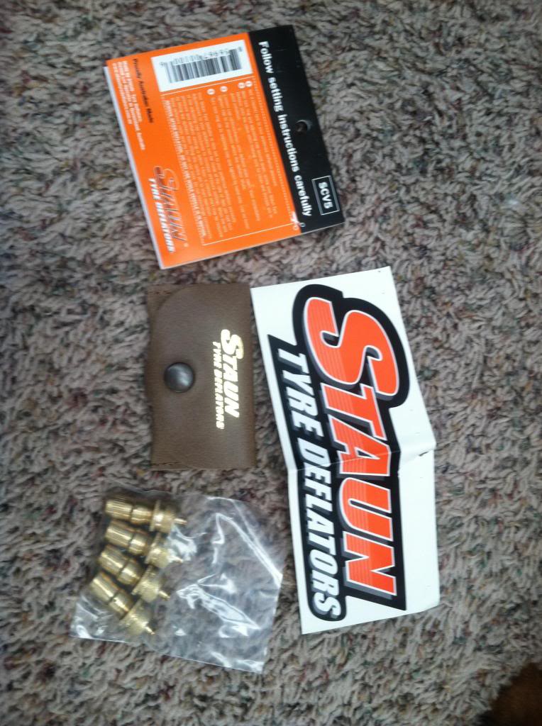

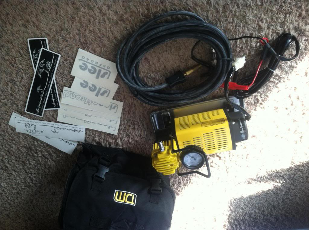

Well it's been pretty slow here. I was hoping to have Aisin hubs and a CB by this time but I'm pretty sure i've spent upwards of $400 on college stuff so that was a large draw. I've already got a CB that I set on my pass. seat and a little magnetic antenna I slap on the roof, only works up to about 100ft so pretty useless but bearable. Anyways I'm getting ready for a wheeling trip next weekend so I thought i'd get a couple small but pretty expensive items. I think every off-roader should keep these in their rigs. . .
I guess my phone was upside down?
