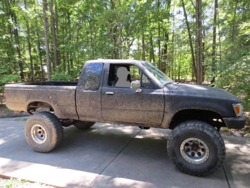

For reference here is how it sits right now:

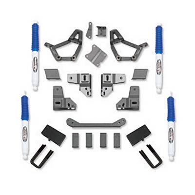

Okay here is a picture of a basic lift kit similar to what i assume must be on my truck, 4" front 3.5" back.
I see and can name:
Shocks.
U-bolts
Blocks
Brake drop-down plate
Then i recognize those big brackets in the middle(they sit below the dif correct? and do the actual lifting on the front, right?)
The other stuff i have no real clue. In the morning i will take some pics of what is currently on my truck and play some matching.
I see and can name:
Shocks.
U-bolts
Blocks
The triangular pieces at the top are your knuckles. Yes the big brackets in the middle are for the diff.
Okay. So i need to find a stock set of those? I assume that would be as simple as finding a rebuild set.

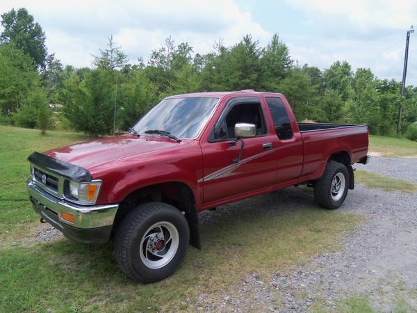

Score, maybe.(i doubt it but hey, a chance is a chance)
http://greenville.craigslist.org/ctd/3898850874.html
I did a spur of the moment txt and ask if he would trade, and he is asking questions and considering... Shoot yes!
94, 4x4, 22RE, 5spd
Told him he could keep his sound system and his pristine bench and he likes the look of my truck. Win win, he wants a lifted truck, i want a stock one.
