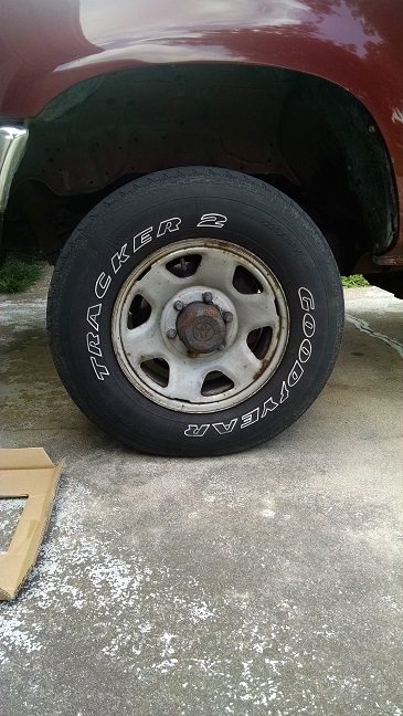

This is a before pic. The new wheels and tires go on tomorrow!

A close up shot of the old vs new wheels

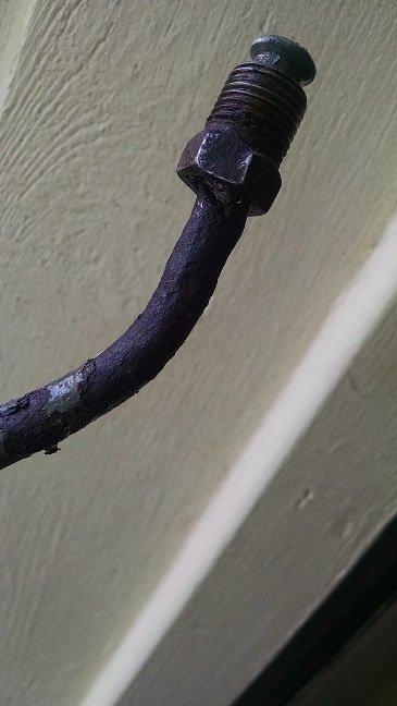

So I noticed that I had a small transmission oil leak bu I couldn't identify where it was coming from because as the oil drop dropped on the front shaft and spun it was wetting everything. I took my truck and gave it a power wash and then waited for the leak to start again keeping an eye out and finally found my problem. So the oi line was so rusted that it cracked open.

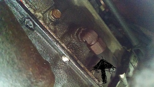

Here's a few pics of where the transmission oil line connects on the passenger side above the oil pan

I went to AutoZone and they don't carry mm fittings only standard size so i ended up using the original fitting and bought new pipe. After being down there for a few hours I got to see how bad the bushings to the front suspension are and have decided to purchase a complete kit to repair them all along with new shocks. To be cont.

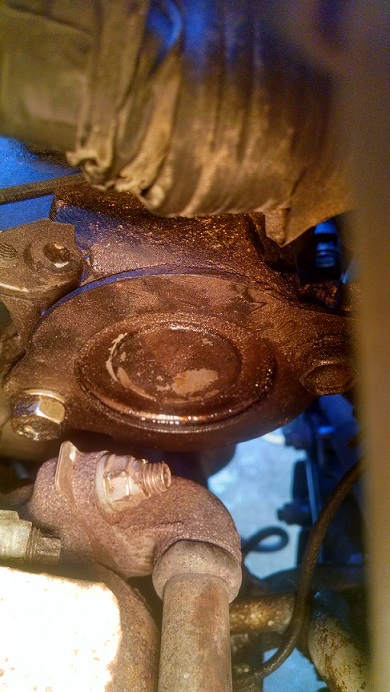

Probably not the best picture but I had noticed that I was leaking power steering fluid and after power washing the engine I finally found the leak. After doing some research I think that I'll just replace it opposed to tinkering with it. It's leaking from behind and within 6-8 days almost had depleted all the fluid so I picked some up from AutoZone.
