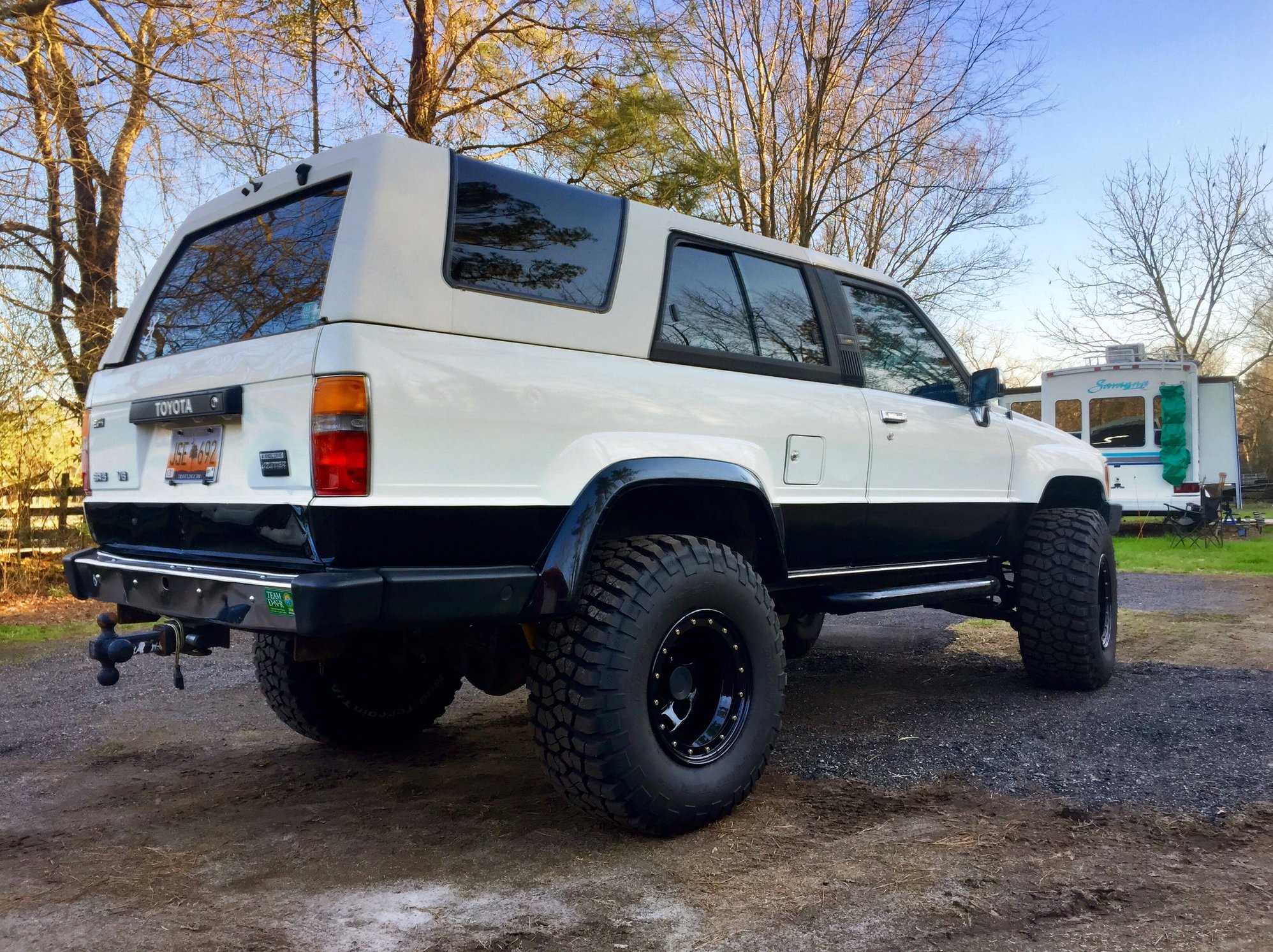

I have had it about 2 months now and the first thing i did was get rid of the 10 inch wide wheels and replace them with an 8 inch wide.
Got some All American Racing aluminum wheels off craigs for $270, swapped them out the next day, then sold my old wheels for $400 the day after that
Installed. Much better

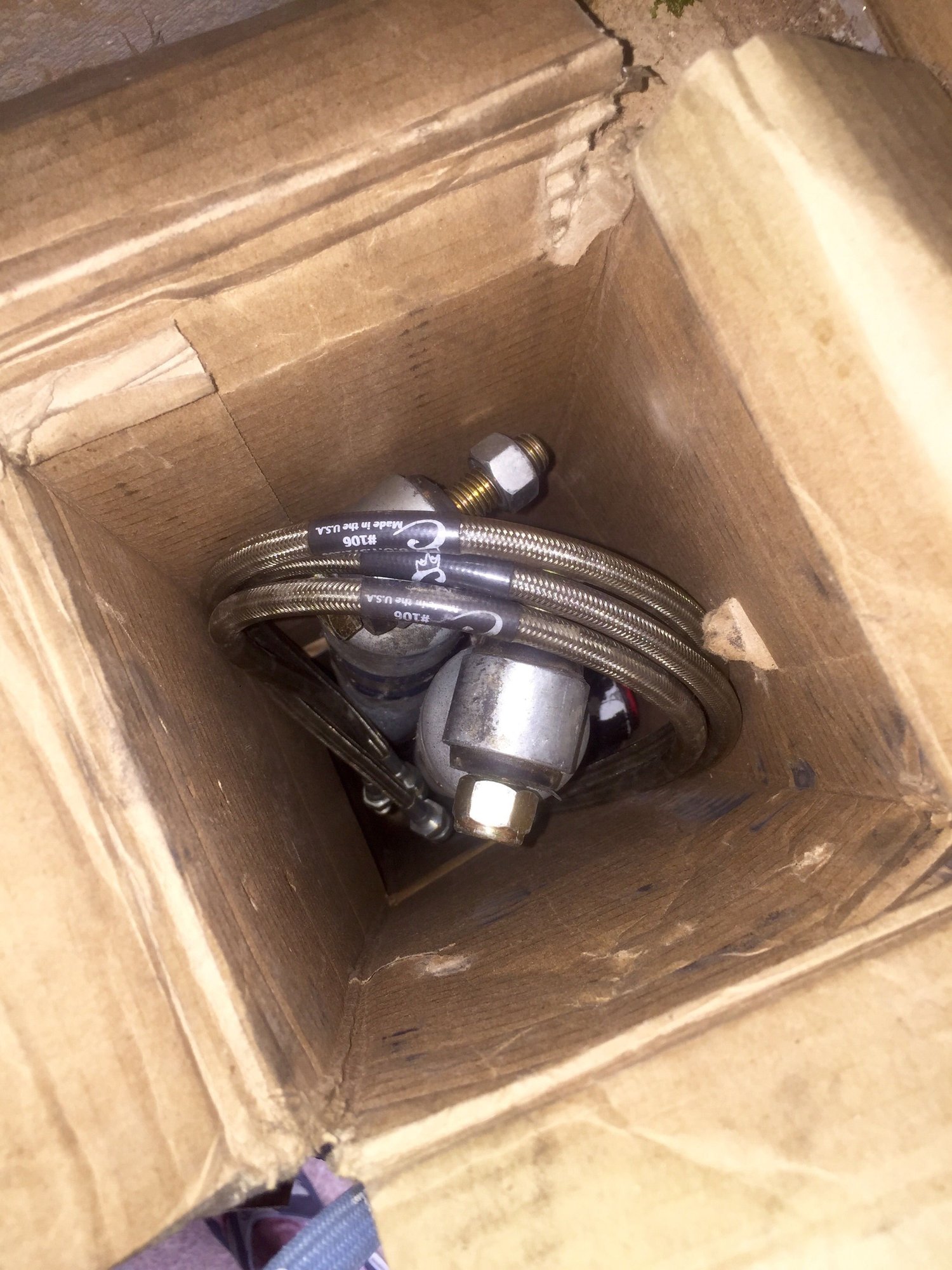

Look what came in the mail!
I guess I'm committed to the swap now

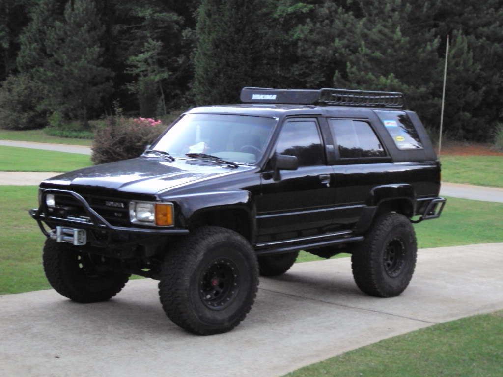

This was the 4runner he built on 37s with 3 inch springs with a leaf removed. The 4 inch springs would probably give you more travel though. Maybe?
