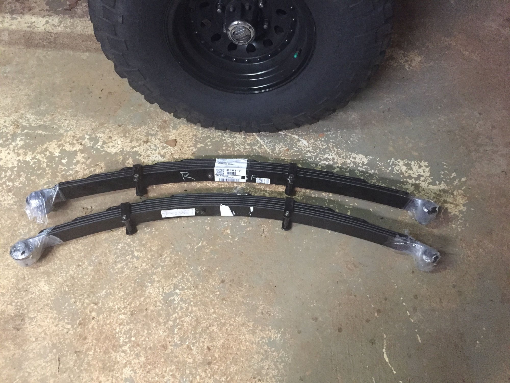

Wheels came in the mail. The replacement Chevy 63s shipped today and I'm waiting on the RUFs to come in the mail. I went with sky's RUF springs that will drop right in.
Old Jun 14, 2016 | 04:23 AM
  #30
RoBatt's Avatar
Joined: Dec 2007
Posts: 460
From: Greenville, SC
Front RUF leaf springs came in from Sky yesterday

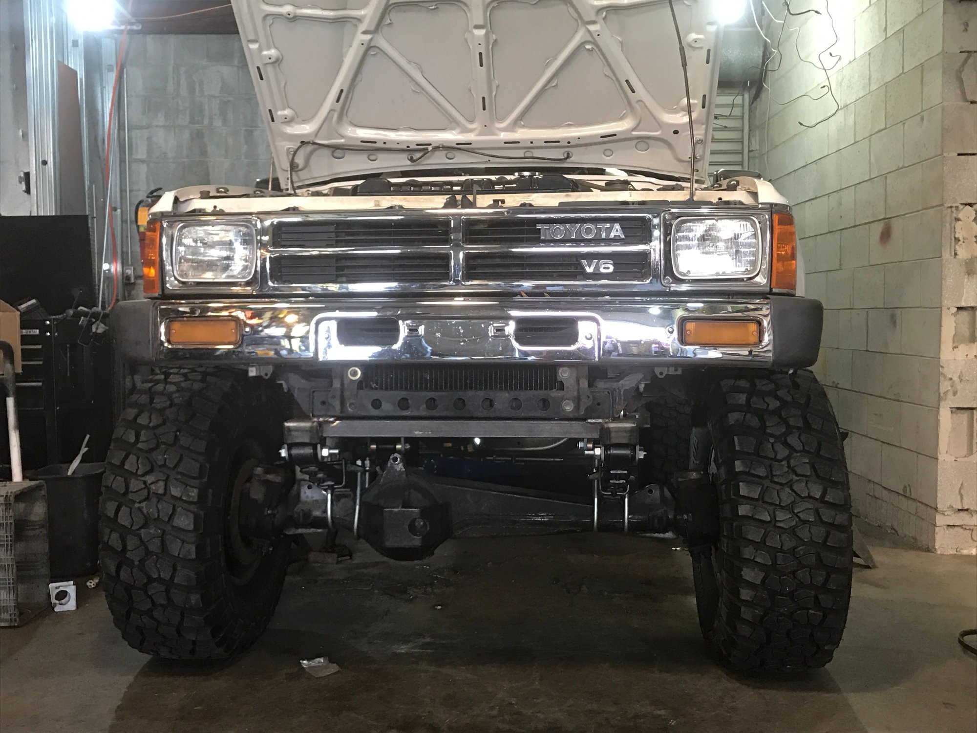

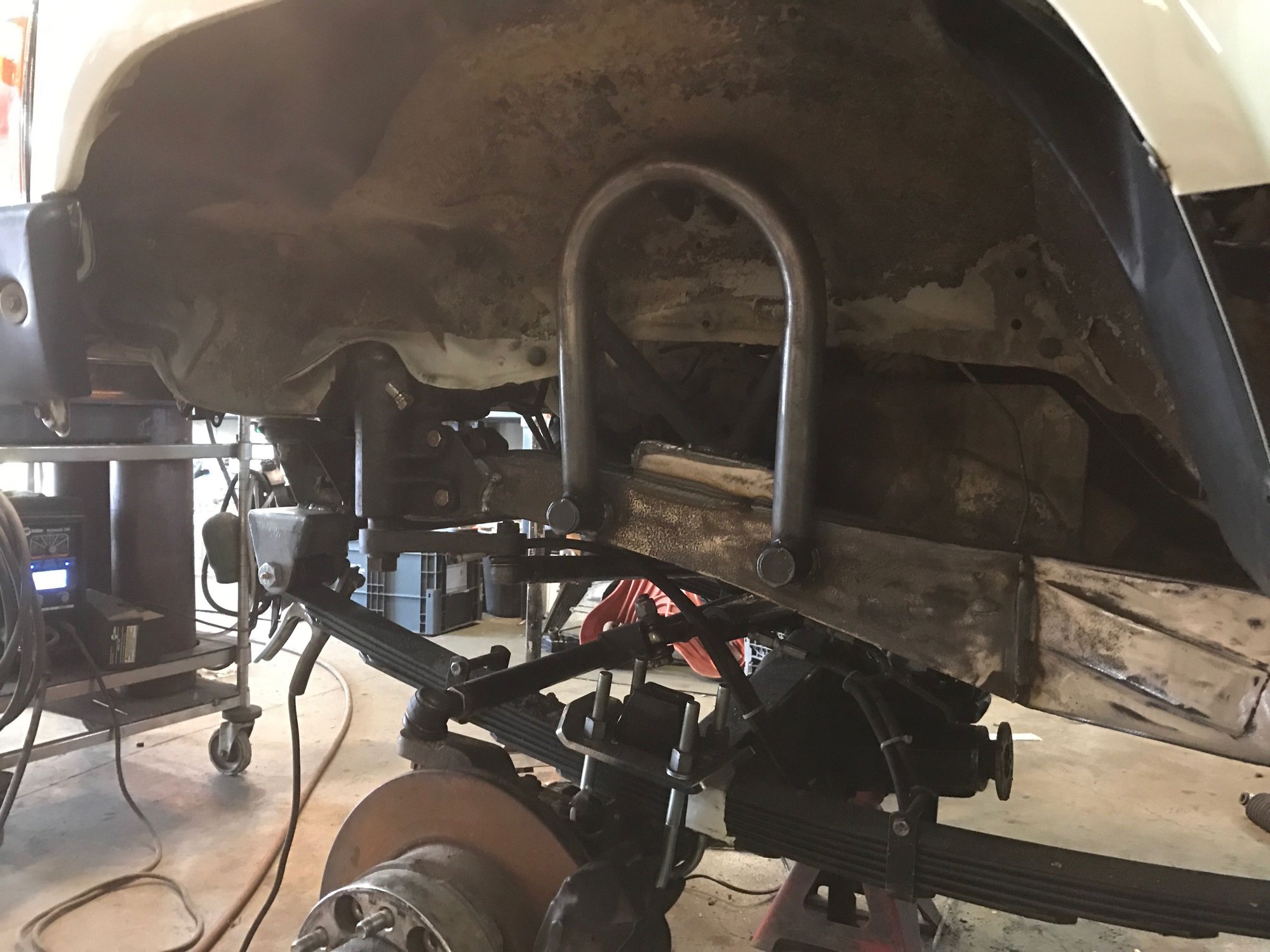

Turns out the hydro assist ram only wants to move one way. Steering wheel will move fine one direction, but it fights itself if you turn it the other way. Any ideas what the problem could be?
Old Feb 9, 2017 | 08:27 AM
  #38
RoBatt's Avatar
Joined: Dec 2007
Posts: 460
Update
When the ram is disconnected from the crossover steering the ram extends when you turn the steering wheel either way. I bought the parts used and they sat for about a year before being installed fwiw. Otherwise steering appears to work normally when the ram is taken out of the equation.
Old Feb 9, 2017 | 10:25 AM
  #39
RoBatt's Avatar
Joined: Dec 2007
Posts: 460
Update 2
After a phone conversation with Trail-gear I learned I had a 2" diameter Hydo Ram (way too much for the stock pump). I will opt for a 1.5" when i can afford it. Im just going to cap off the connections for now.
