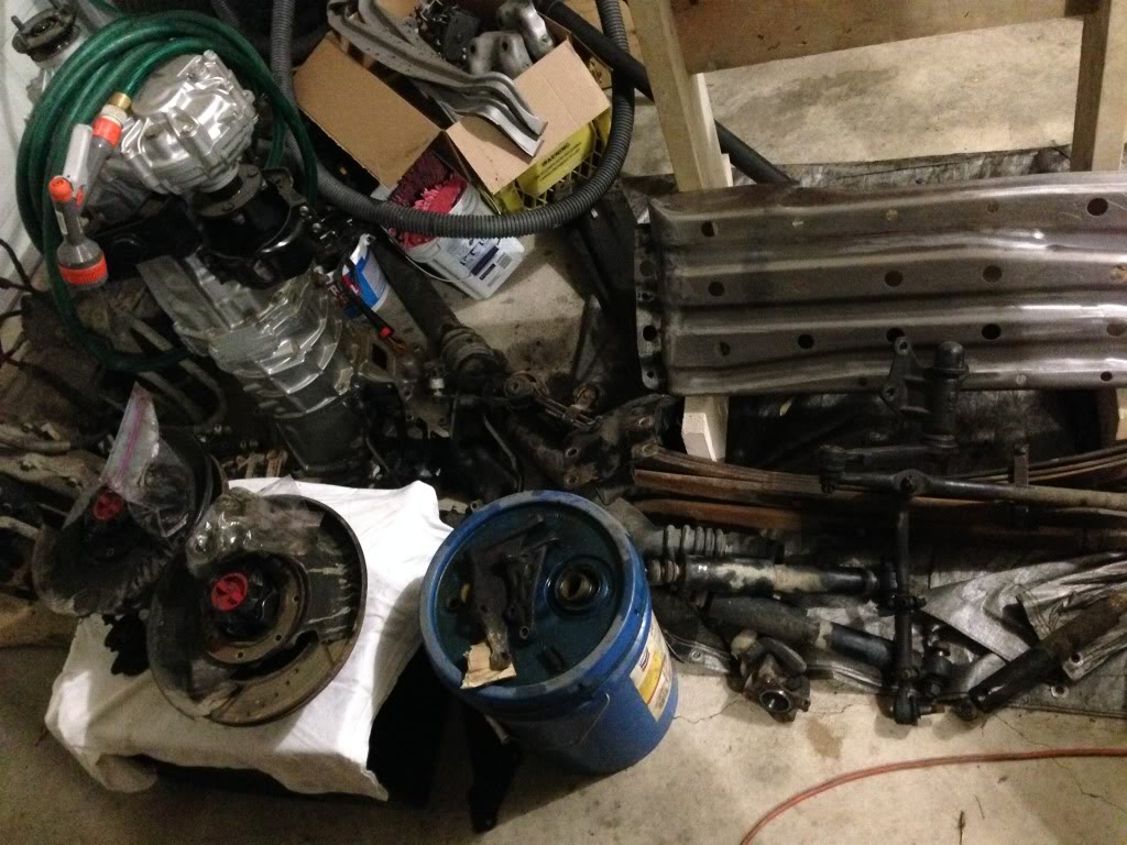

That is where I am as of tonight. This project has been put off and put off because of our need for 2 vehicles. Something would wear out and I would just drive it. I didn't replace the shocks because I wanted it lifted. And I didn't replace the tires because once it's lifted I'd want bigger tires. So on and so on.
This isn't going to be a rock crawler or a dedicated trail rig. I drive it every day and just want a capable and comfortable vehicle. It was a base model truck and I will be adding many options as well. It doesn't hurt that this was the wife's truck when we met. That being said, things are in pretty good shape. Very little rust. I think she's glad it's getting a new lease on life.

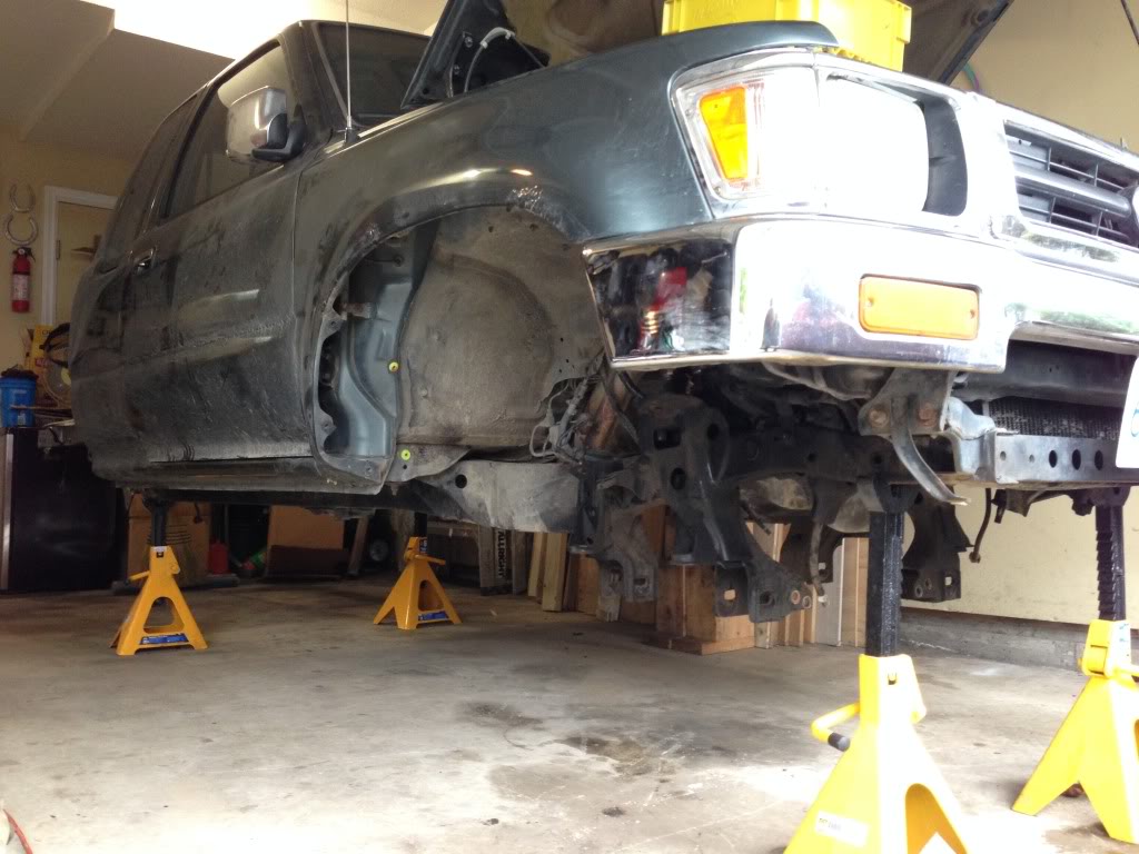

Got a little more done today. Removed the control arms and torsion bars. Decided since I'm this far I might as well drop the front diff as well. I noticed my CV boots are beginning to crack. Not through yet but won't be long. Has anyone re-booted the stock ones before? Is it a huge pain? I'd prefer to keep the toyota ones on there as opposed to buying some crap from Lordco or NAPA.
All that's left is to unbolt the body and sit it on some 3-4" blocks so I can get as much access to the frame as possible. This is how she sleeps tonight:

Why have you torn everything off? What are you doing?
I tend to work on one thing at a time, are you doing a frame off or something?

Well I borrowed a vehicle to drive while this is off the road. The idea was to pull it off the road a couple of months and get everything fixed up. Good idea? I'm not sure yet. I also have plans for the interior but I'm running a little behind schedule. That might have to be split up into weekend work.

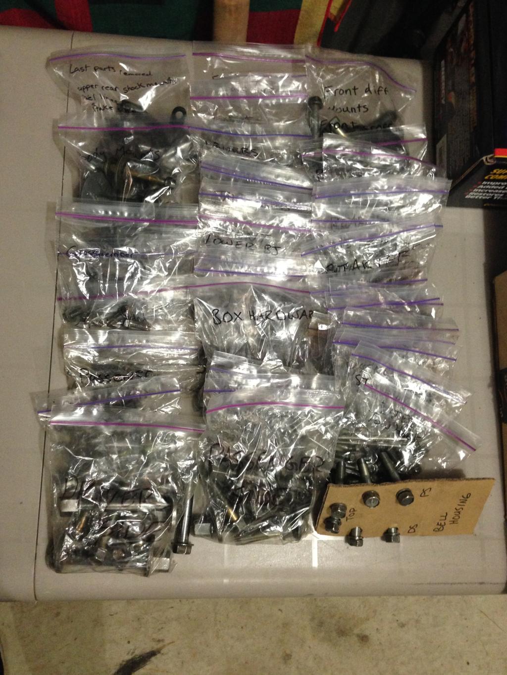

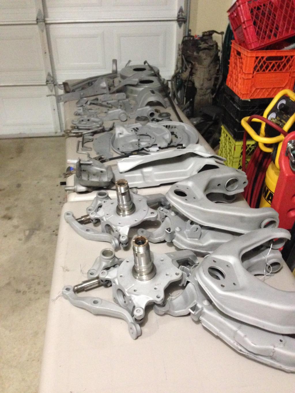

Well I've been progressing slowly. Getting all the stuff done that nobody wants pictures of. Washing and degreasing parts. Cleaning up bags of fasteners for smooth assembly. No matter how hard I try, I just can't use rusty nuts and bolts to install all new parts. I've got a final list to order from toyota tomorrow. Aside from that all I should need is tires, rims and fluids. I think I'm going to buy a preferred customer package from Amsoil and have all my stuff delivered. I found a used detroit truetrac local and I'll be picking that up this week. Today I stripped the axle so I can get some por15 on as soon as I get the third back from having the lsd installed. The FSM isn't clear, is there a gasket used between the third and the axle housing? Or do I just use RTV? I don't really want to have to redo this because of a little leak.

Not to many pics today. Lots later when all the goodies start getting unboxed.

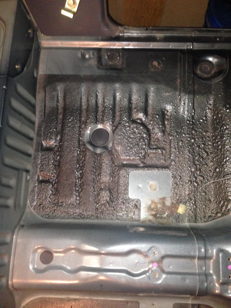

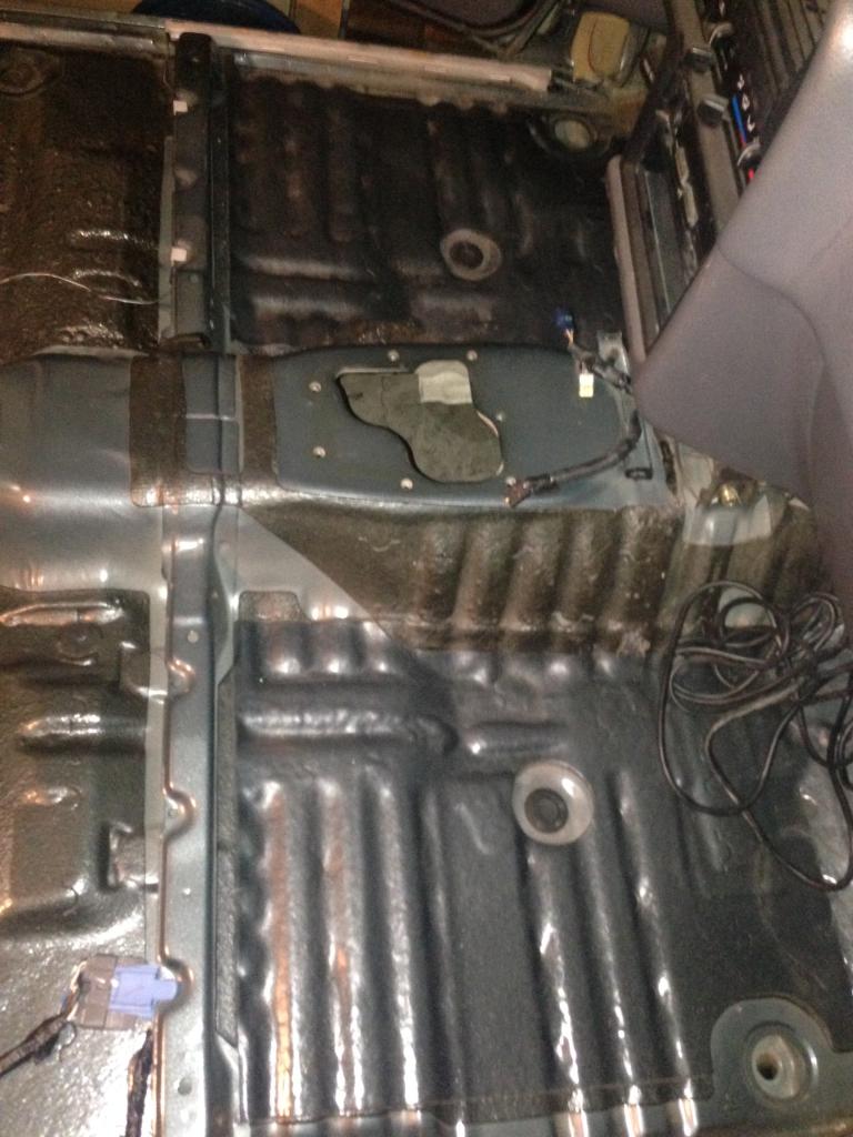

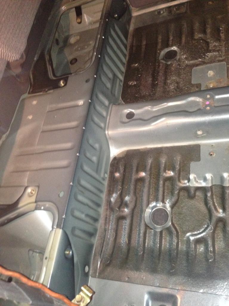

Got a little further along today. I didn't have much time but got the body mount bolts off and came up with a game plan to lift the body enough to grind and paint the top of the frame. Shouldn't be too hard after all.
After dinner I decided to spend some time in the garage so I removed and boxed up a bunch of the interior. Pulled the carpet out and found zero rust which was nice. With everything out of the way the pedal swap will be much easier.

I see people chipping and chiseling that factory coating off all the time. There is no way I'll be starting that job but I have "dymamat" to lay down. Can I go right over it as is?

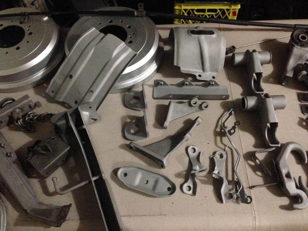

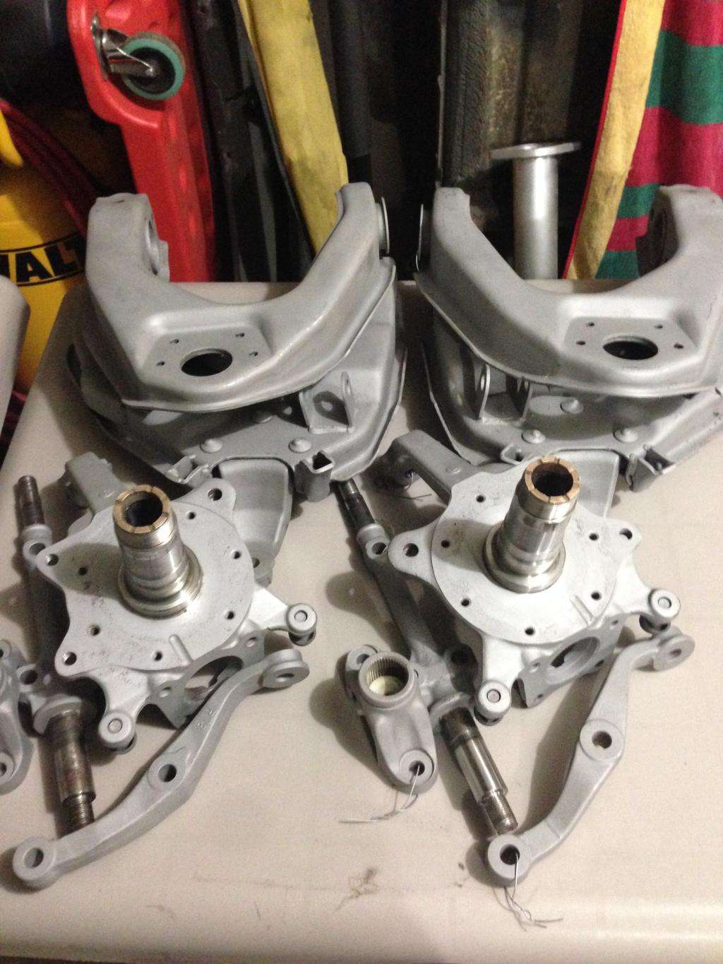

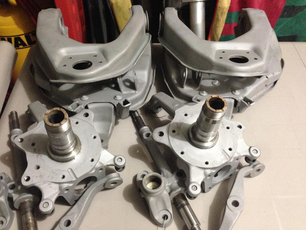

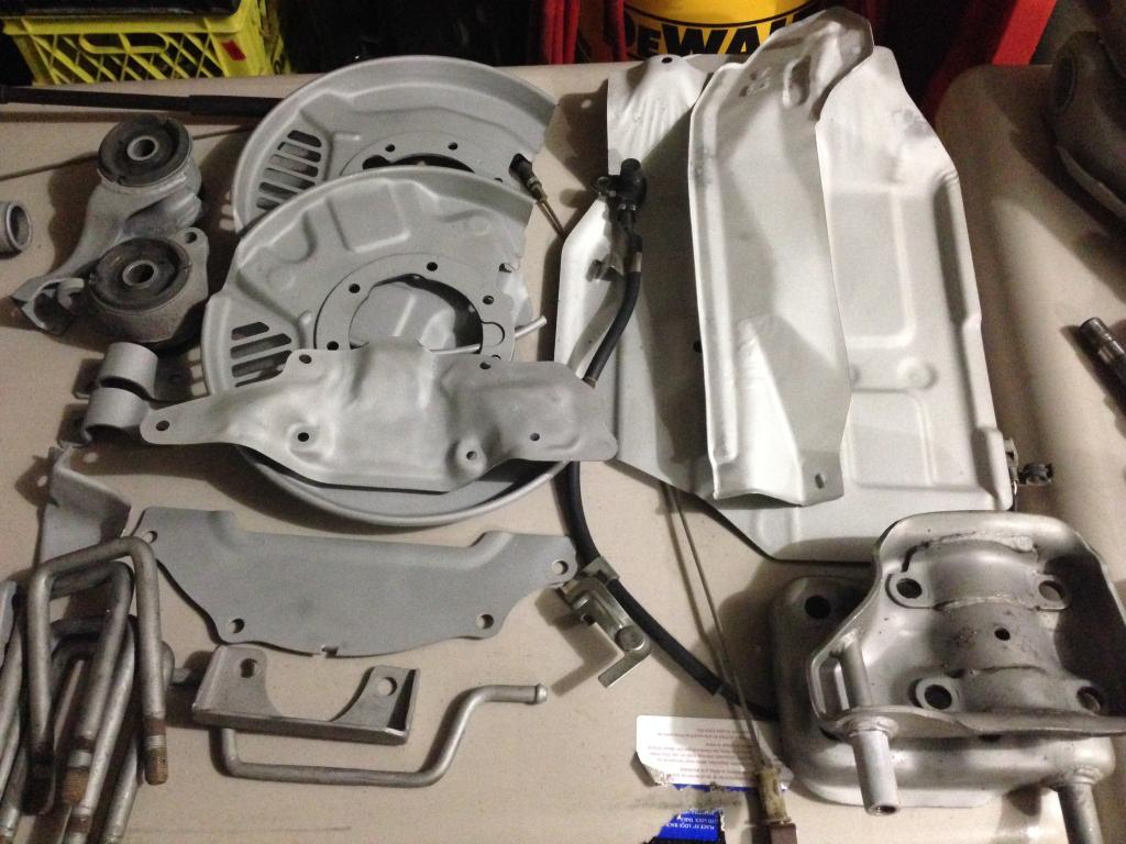

Well the big sections of the frame are all stripped with the wire wheel. Soon I'll start with my small 90* air grinder and get the tight corners as good as i possible. I also just finished up the last of my fasteners. Every nut, bolt, washer, and clip i removed from the truck was wire wheeled with my drill press and bagged in labeled zip locks. Trust me, it was a long process.

I have been trying to find something i can do while standing up(avoiding the wire wheeling) i discovered sand blasting. There is a place called UBlast near me that offers their machines for use by the hour. They charge by a small minimum time limit and then in 5 minute increments after that. I've gone twice so far and have at least one more trip planned.

It is very calming, and easy to get carried away. The only problem with finding this place is learning they recently added a sandblasting bay able to accommodate vehicles up to about 20' long. My truck is so close to a frame off that it kills me and I've been trying to figure out a way to get my frame out in my small garage but I don't think I can. Unless i jack the body up a bit more and support it off to the sides. I could unbolt the steering box and motor mounts and just suspend the motor while i pull the frame out the front and load it on a flat deck. Actually doesn't sound as crazy as laying under it for hours at a time. Thoughts?
